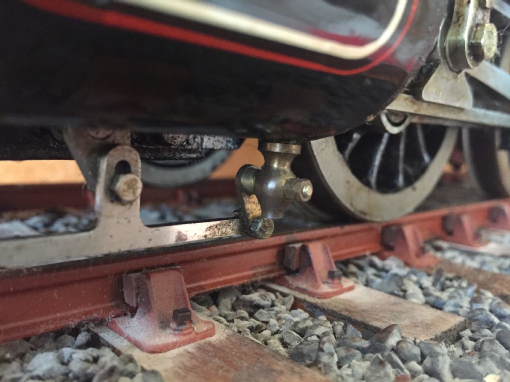

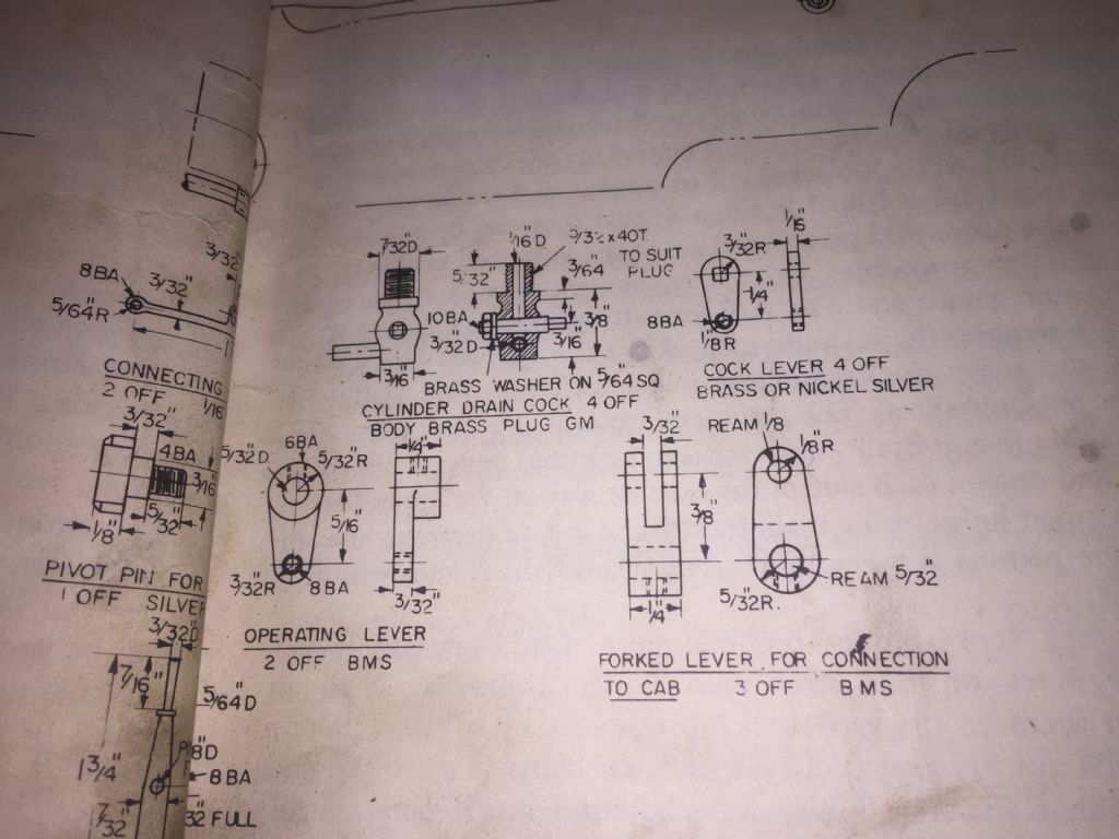

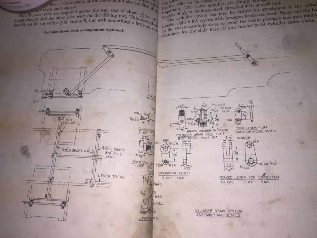

                  Hello Steve and thanks for your reply. My copy of the Rob Roy book has a poorly printed version of the drawings for the cylinder drain cocks. The linkage i think i can figure out. But here are my uncertainties: btw i refer to the drain cock body, the valve stem, which is turned to open/close the drain, and the cock lever, which actuates the valve stem.
                  1. Diameter of the valve stem? And what is the size of the hole in it?
                  2. Where the cock lever attached to the valve stem: a square hole in the lever, and file the end of the shaft square to fit?
                  3. Does the cock drain downward, i.e., straight thru, or is there a side tube directing the flow to the side?
                  Any help will be much appreciated. Many thanks in advance!
                  Cheers, Pete Grigg

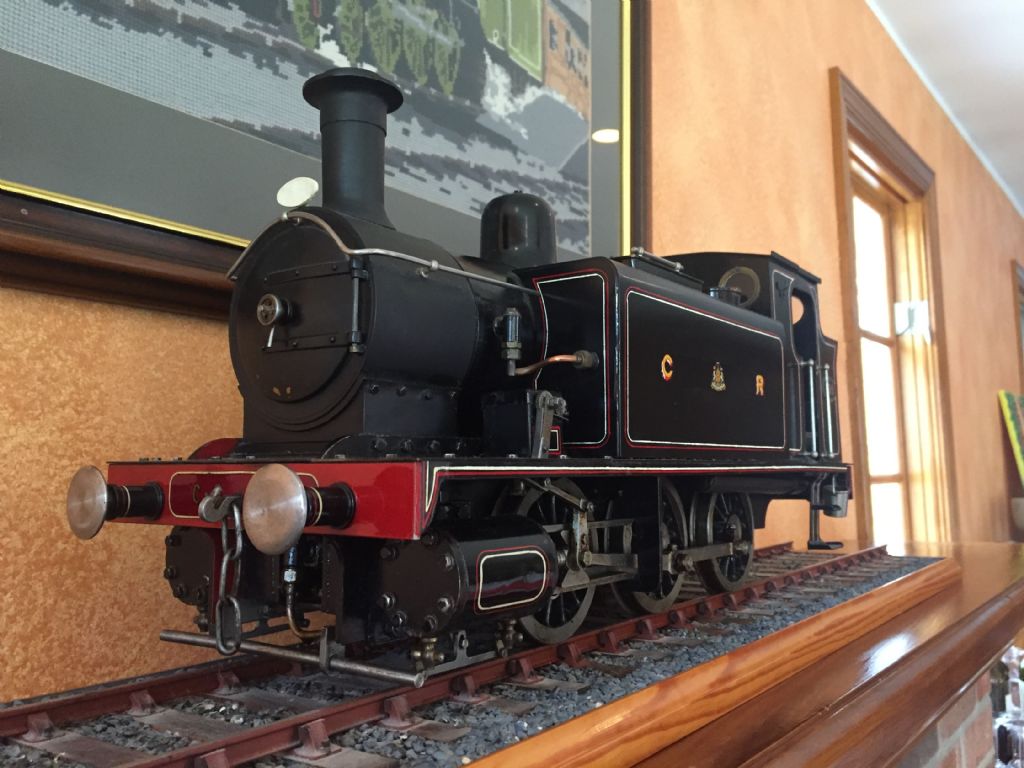

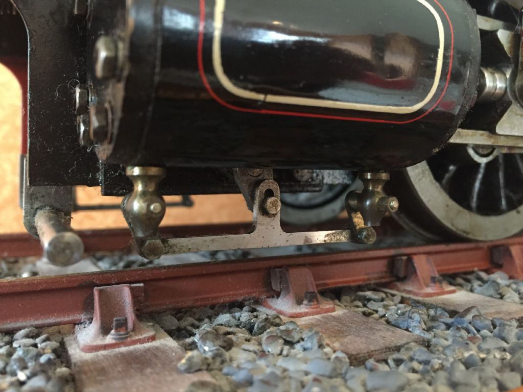

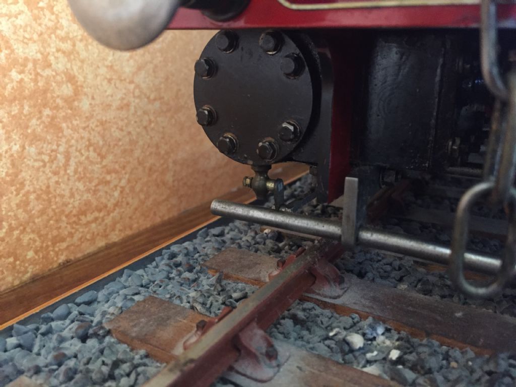

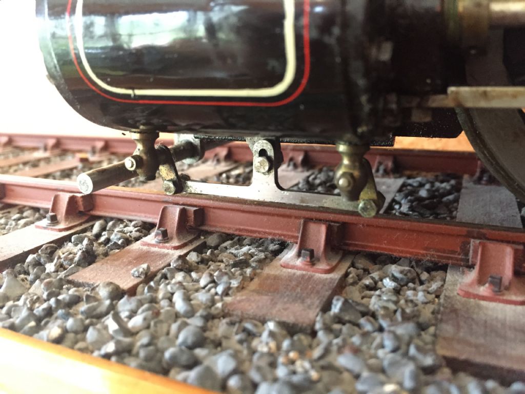

                    Hi Pete,>>
                    Am going to try and attach a few pictures that will hopefully be of help, but if anything isn't clear (or if you have other questions) then don't hesitate to ask. In direct answer to your questions however:>>
                    1a. Valve stem – I made mine from 1/8" brass. Note that it's tapered – you'll need to make up a little tapered D bit and machine your stems at the same time without changing your cross slide angle, that way the stem taper will match the hole taper. Machine a few extra tapered stems just in case .>>
                    1b. Valve stem hole – 1 mm is fine. I wouldn't go larger than 1/16".>>
                    2. The drawing is as you describe and that's what I did (and then silver soldered in place). In retrospect I see no reason why the hole needs to be square as you will be soldering anyway. Drill the drain hole through the stem after you've attached the lever arm, so that the holes are all in the same alignment.>>
                    3. The drawing shows it venting to the side. I didn't do that and have them venting straight downwards. It really makes no difference to their operation but the side vent is obviously more work.
                    Please note that there are a couple of mistakes on the drawings. The ones that come to mind are:
                    a) the cranked valve rod arms that clear the leading axle lie very close to the leading axleboxes and the connecting pin nuts will foul the axleboxes. I modified the pin so that it screwed into the axle-box side of the arm rather than being nutted on that side.
                    b) the blast pipe is too low and the engine won't steam. Experiment with some different length blast nozzles, I think that I had to raise mine about 1/2 inch or so.
                    Best of luck,
                    Steve
                    img_0526.jpg>>

                      Hello Steve: Many thanks for the hints and especially for the drawings and the photos of your very excellent Rob Roy. 1. The hint about drilling the valve stem while installed: a really good suggestion. 2. The photos show there is a slot where the actuating mechanism couples to the bar that moves the levers. The slot = not apparent on my drawings. 3. Your advice / warning about the eccentric coupling and the front axle: Alas, too late for that as I have already installed it and seen the collision with the horn block. Now working on a fix for that. 4. The blast pipe relocation now noted in my book however so thanx in advance for that.
                      I very much appreciate your help on this. If any more issues arise I'll be back in touch.

                        I honestly don't think the slot in the connecting arm is needed – I can't remember exactly why I made it that way but suspect I may have been concerned about the linkage binding if I didn't get the pitch centers of the drain cock levers and operating lever exactly the same. In retrospect I think I was being over-cautious.
                        Good luck with your build, let me know if anything else comes up.

                          As an update Peter, it just hit me that there are two real reasons why the slot is needed.
                          Firstly, and most significantly, the drawings show 1/4" centers on the cock levers and 5/16" centers on the operating lever. Hence, if built to drawings, the mechanism will bind.
                          Secondly, the slot allows for some leeway should the final vertical height of the draincocks with respect to the operating lever vary slightly, for example due to slight variation in the cylinder draincock boss heights and/or the final 'screwed in' position of the cocks themselves.
                          Hence, in further retrospect, I think it would be worthwhile repeating what I did and adding a slot to the connecting arm if you build the other arms items to the drawings. While you could change the center on the operating lever from 5/16" to 1/4" to match the cock levers you would still need to alter the vertical dimension of the connecting arm to suit. I think the slot gives more leeway for 'tolerances'.
                          Good luck
                          Steve

                            Hello again Steve: I agree there must be a slot or it will bind. My plan is to start with a hole and then file it to a slot so as to relieve and binding.
                            Thanks again, Pete Grigg

                              It occurred to me that the late Alan Stepney set up a website that included compiled lists of errors for several locomotive designs. Alan's website is still extant at: https://web.archive.org/web/20130811220810/http://alanstepney.info/index.html
                              I have unashamedly copied Alan's Rob Roy error list at the bottom of this message and can personally attest that the crosshead pump fouls the cylinder jacket, I ended up cutting away a small portion of the jacket to clear. While I didn't use different valve spindle threads, or add gland locknuts, the suggestion is good.
                              One other thing that comes to mind is that the mechanical lubricator linkage causes the lubricator to pump far too much oil as designed. I ended up using a slotted rather than pinned connecting arm between the crosshead arm and the pump arm, meaning that the pump is rotated by two ratchet teeth with every wheel rotation. That's still plenty enough oil to get your face dirty!

                                You have made an excellent example of a 3.5"g Rob Roy.
                                I was very pleased that you showed A B Macleod's rare book. He was a senior manager in the SR and later BR, and a great railway enthusiast both for miniature railways and fullsize especially for the Isle of Wight Steam Railway.
                                I met him once at Havenstreet when he was quite an elderly gentleman, and very dapper.
