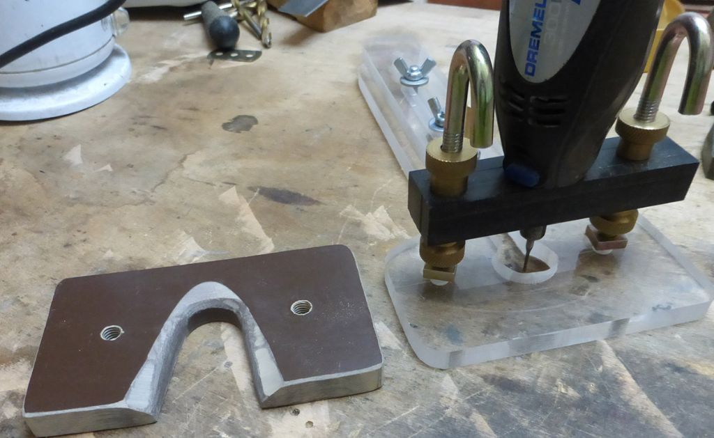

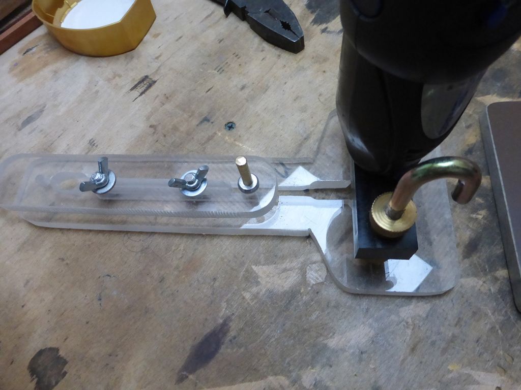

                          Made these the otherday for a couple of acoustic guitar builds. Got rid of all my guitar building stuff years ago.
                          Cheap and cheerful dremel router base and circle/rosette cutter. acrylic , tufnol and delrin scraps and a couple of roofing bolts. Quite solid and works well, only a couple of hours to make.smiley.

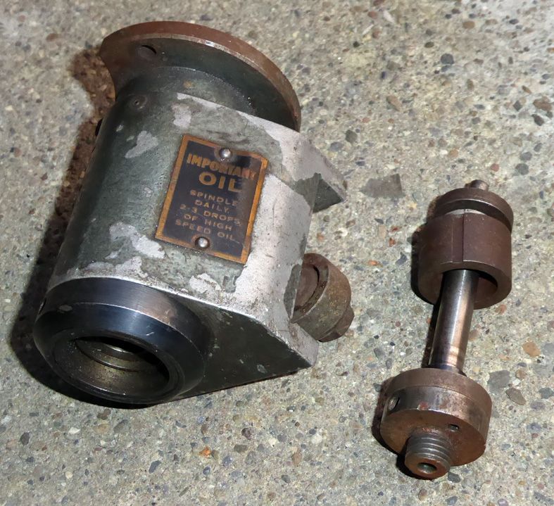

                              Another thought I had was to make a new spindle for the Dowling engraver so it will take parallel shank cutters.
                              I wondered about using ER11 collets, but I have a good stock of the taper shank cutters so never went any further with the idea. The dowling spindle is separate from the actual motor itself, so should not present too many problems in making one with a different nose. These are the bits of a spare spindle and housing I have.

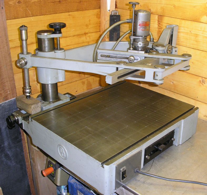

                                Without wishing to derail this thread any further off topic than necessary, I, too, have a David Dowling 848 engraver. When I bought it last year, it came with the original typed operating instructions and a couple of pieces of period adverts for the 858A and 595 cutter grinders as well as some of the David Dowling accessories. I've made the whole lot into a combined Word document and pdf version and tidied it up somewhat. PM me if you want a copy.
                                There are a number of ER11 CNC spindles both with and without power supplies available on eBay for around £50 to £60. They have mounts which, from the pictures, seem to be eminently suitable for grafting onto a DD engraver.
                                My engraver:
                                The machine in its new position

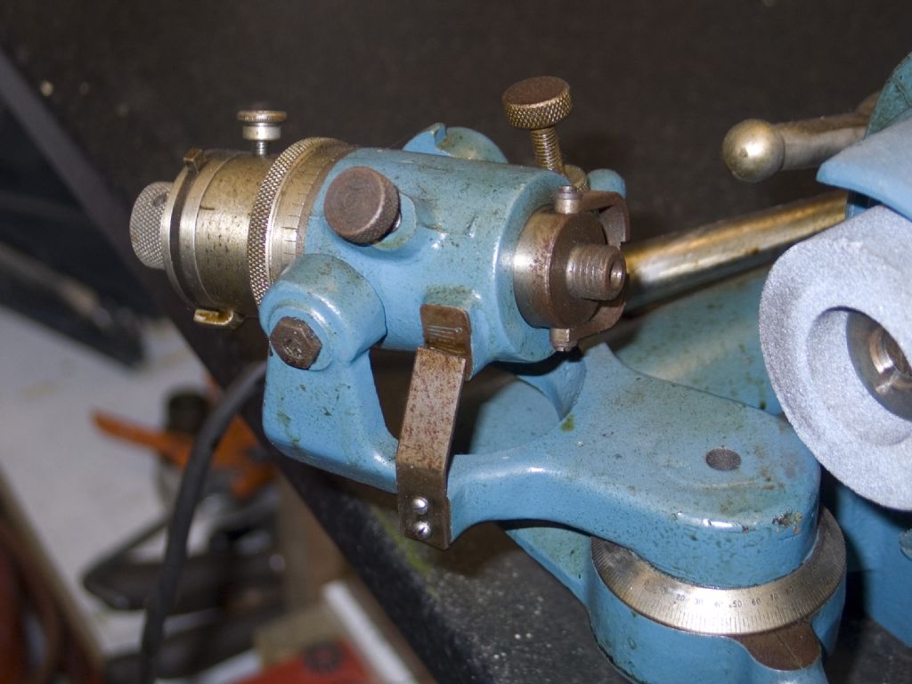

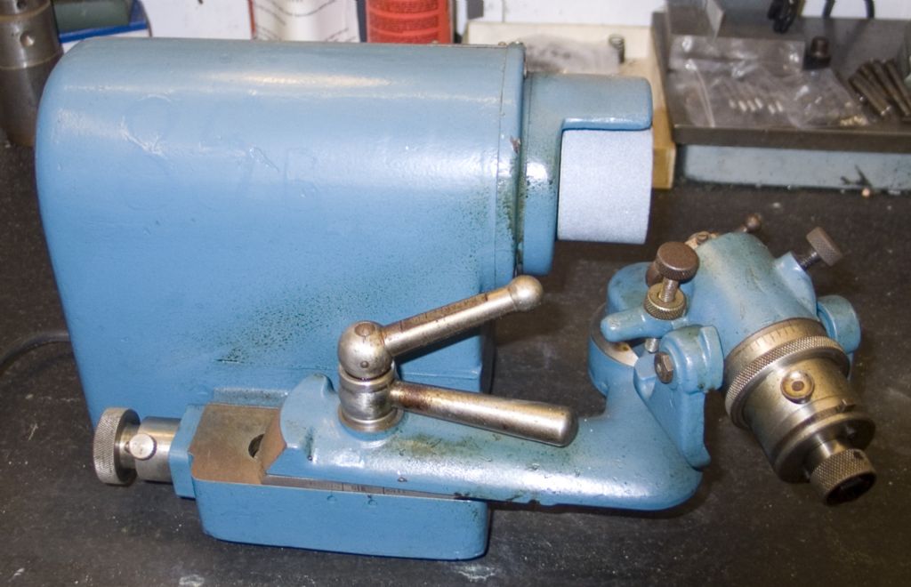

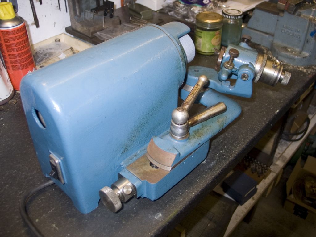

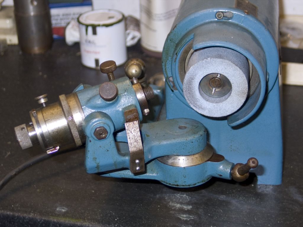

                                Phil P
                                  @philp
                                  Here as promised are some photo's of the David Dowling 858 cutter grinder.
                                  I have the original bill of sale for this and the engraving machine, the paperwork dates from 1957 and has survived intact through various owners of the machines which must be pretty rare these days.

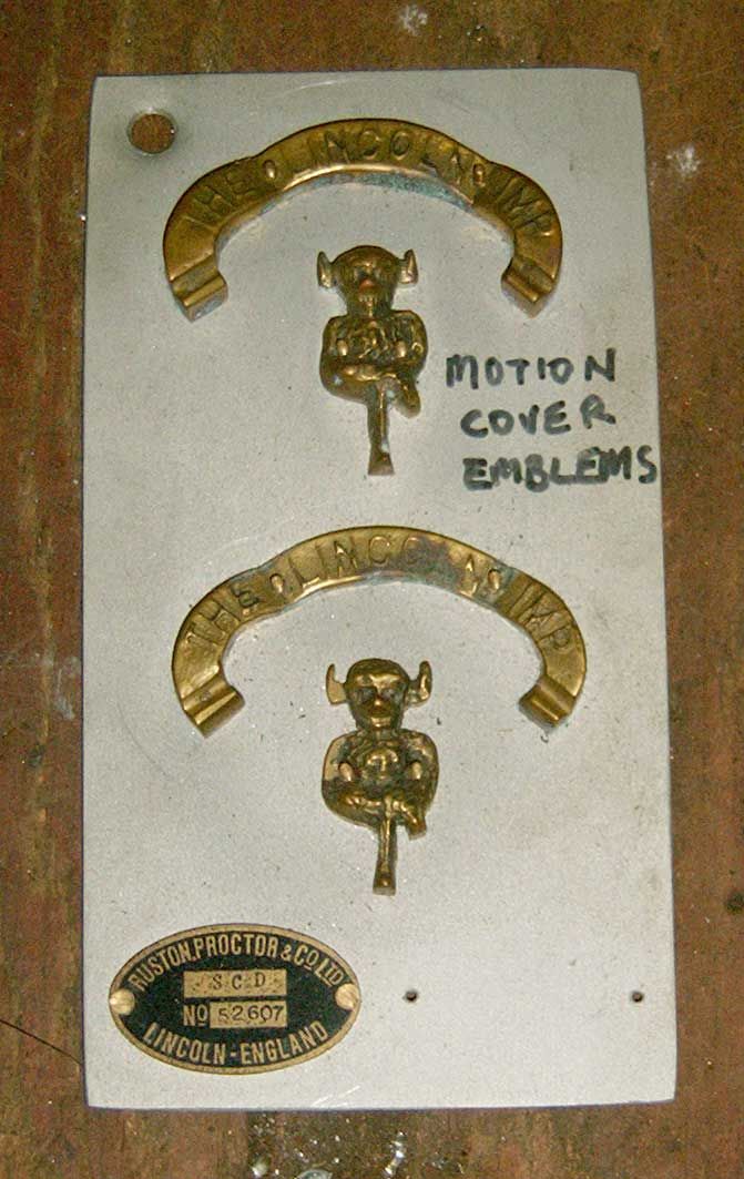

                                  And finally one of the actual engraving machine.
                                  These can do 3D work up to a point. I used mine to copy some brass emblems for a 3" scale Ruston Lincoln Imp steam tractor.
                                  Phil

                                      Phil P
                                        @philp
                                        We used to own the full size engine back in the 70's, so I was on good terms with its new owner and he lent me one of the original emblems off the engine for a while.
                                        I got a full size copy cast from it, and then used that as the pattern for the 1/4 size version on the engraver.
                                        The model now belongs to yet another new owner of the full size engine, but I still have the full size copy of the emblem hanging on my wall as a memento.
