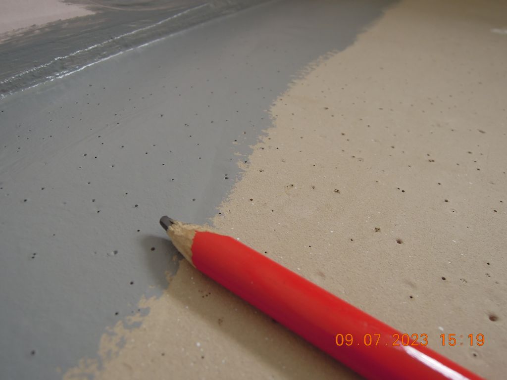

        After a lot of debate I had my workshop flooring completed with a self-levelling latex material. Its actually much harder than I imagined, not cold to the touch, and doesn't seem to chip with tool impacts. I expected there to be some permanent set / indents where heavy objects rest on it for a long time – but it doesn't do this either! So generally I'm very happy with the choice of material.
        What I'm not happy with is the finish. I believe that the builder mixed the resin too fast and filled it full of air bubbles. On laying it, these managed to rise to the surface but the material set before the hole was filled by inflow. The result was a myriad of pock-marks. The pic below shows how it looks …
        At the time I wasn't too worried by this as I expected a final coat or two of paint would easily fill up all the holes. Yesterday I started on the floor painting but had to stop as the holes just wouldn't fill up, regardless of what I tried !
        I experimented with my technique. Vigorous brushing or flooding the area with excess paint seemed to work initially, but by the time the paint had set the holes were back. In an effort to get some flow into the holes I diluted the paint. This was equally ineffective.
        Convinced that lowering viscosity was key, I treated some small areas with a runny cellulose lacquer. I poured it out on to the floor then tried to 'card' it into the surface and force it into the pocks. Even this didn't work properly and on subsequent painting, most of the original holes annoyingly re-appeared.
        I can't be the first person in the world suffering from this and feel there must be a simple known solution or product that can rectify 20 sq.m. quickly. Does anyone have any suggestions ?
        Unfortunately, I cannot add a new substantial layer (i.e. millimeters) of anything as this will create a step somewhere, and I don't want this. In any case, the builder applied 3 layers to get the thickness I needed (40mm), and the bubble holes he created in the first layer, seemed to persist right through the second and third ! …..and no I don't want to call him back to rectify the job. After two months of them being in the background making noise and asking endless questions, its nice to have peace and quiet again

          Polyurethane filler (available from screwstation and their ilk) used as a filler and applied with a broadknife?

            Paint is a poor filler – no bulk to it, and optimised to stick to a flat surface.
            For covering small holes in a levelled floor, I think almost any fine filler knifed over the surface would do.
            When my son had a section of floor levelled with goo, the result was similar – mostly flat with a scattering of small dints. His are hidden under a carpet.

                  Had a similar problem with a latex floor some years ago and resolved using arditex feather finish. Then coated with two part epoxy floor paint from Watco. Not sure how hardness would compare.

                    Michael, yes you are right. Many seem to have a protruding rim and I thought it was this that was preventing the paint etc from flowing into the hole and filling it. So I ran some sandpaper in a block over the surface to find that many didn't have a rim at all ! This type, one might think, would help the paint run in but it doesn't seem to make a difference.
                    Does it matter ? Functionally no, but its the spoiling the ship for a hap'orth of tar thing. I think the knifed in filler might be the way ….but 20 sqm….. thats going to take some time.
                    For interest I've just brushed in some aircraft dope (as a trial) that I had on the shelf for 25 years. Its low viscosity and seems to go in the holes but then up comes a bubble which skins immediately due to the high volatility of the solvent. These then need rubbing down.

                        I think the problem could be the sub floor that the latex has been applied too, something has leached out or still is leaching out to cause the blow holes, all you can do is fill the holes.

                          Did the builder seal the floor before applying the self leveling compound? A diluted coat of PVA usually does the trick.
                          I ask this question because you can get air coming up from the concrete if this is not done. It may well be that the hole in the compound goes directly to the concrete. I would try a small area with some dilute PVA and then try painting that area again. You have everything to gain and not much to lose.

                              to late now but at 40mm a screed of sand and cement trowelled to a smooth finish would have been the answer and a harder surface would have been a granno screed trowelled but I am out of touch with modern methods having been retired for 12 years.But the old way is foolproof at that thickness.

                                Looks like I'll have to bite the bullet and start filling with Arditex or similar, then and rub it all back. Hopefully I'll only do this once.

                                    That floor material should have been mixed with a slow speed paddle mixer then rolled out with a spiky roller. Then it would have had no bubbles.

                                      What about sweeping some powdered filler into the holes to let the air escape before dampening the surface with a fine spray? Then paint when dry.
