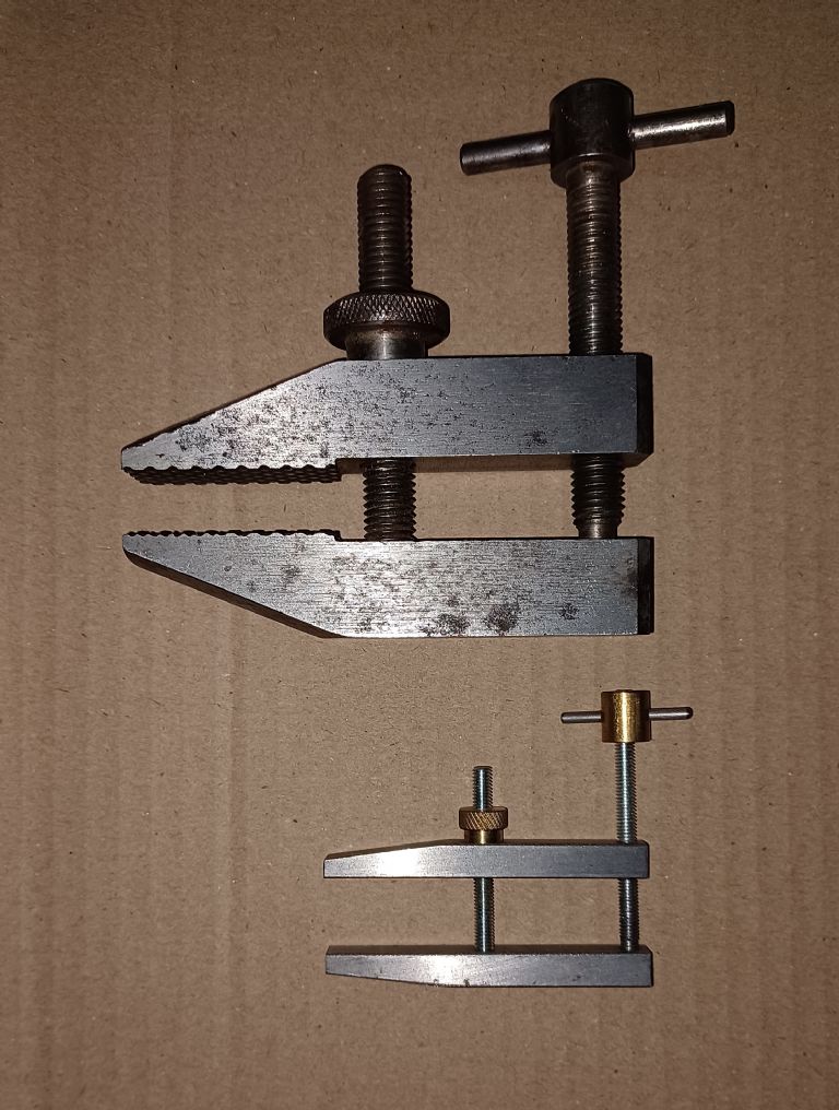

      Recently I has holding a kitchen cabinet hinge in a vice via a toolmakers clamp. Modifying the hinge as one of ours broke and its an unusual design that I could not find on the Internet. On my second adjustment I managed to be a bit hamfisted and broke the clamp across the thread hole. Actually I didn't think I was being that brutal with it, but after tapping their is not much metal left creating a weak point. I made a replacement part. I did wonder if hardening the jaws does make them weaker?
      But it occurred to me that it is a bit of a design flaw, they should be a bit wider around the tapped area.
      It occurred to me that I could have used a larger strong one with a thinner piece that would fit inside the hinge part, but it would be fiddly keeping it all aligned. So why not have a thinner piece that can be screwed to the inside of the jaw or a series of screws that can be used in the gap. Not done so yet but intend to make a couple from 12mm sq mild steel, one that will take a narrow insert on one, perhaps both jaws and one that is tapped for 2 or 3 screws.
      The previous ones I have made are cruder than commercial or neater homemade ones. Simply 2 pieces of threaded rod inserted in one jaw and 2 nuts that adjust and tighten the other one. I thought my crude design was unique to me untill I saw an identical one in a photo in ME. The one I broke was a commercial one that I bought some time ago.
      Has anyone tried a similar modification?

          I made this pair from stuff in the scrap box, definitely not hardened. Plenty of meat around the holes and I don't really see how you could apply enough force by hand to break them. They are after all designed to be tightened by using the knurled knob.
          Or are we talking about a different design?

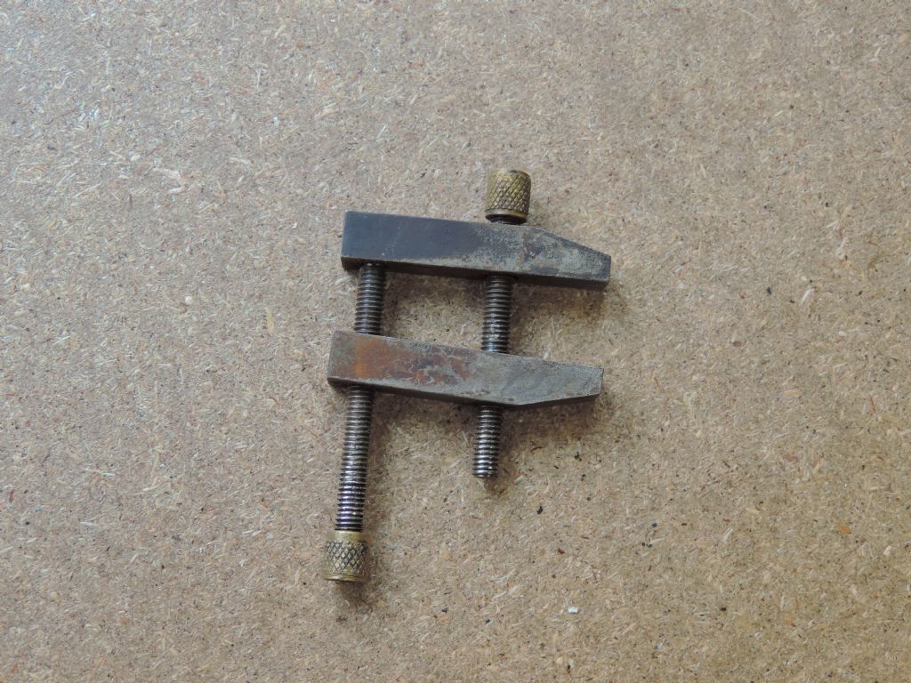

                    Couple of my home made ones

                      The easiest option would be to use rectangular stock. So instead of 3/8" or 10mm square use 3/8" x 1/2" or 10 x 12. Put the holes through the shorter distance then there will be more metal at the sides of the holes for added strength. Then to save the jaws being too wide taper on three sides not just the outer one.
                      I've snapped a couple of cheap no brand ones.

                          Finally got in the workshop today. i made a simple modification to one of my 12mm sq jaws. Fixed a short length of 20mm T section mild steel to the top jaw using a couple of 4BA screws. Works well.
                          I like Neil's idea of using 2 screws instead of my threaded rod and nuts. Next time I make one I will try this.
                          I didn't use Jason's idea as the rear nut prevents the two jaws meeting, although a cutaway where the rear threaded rod enters the jaw would solve this, allowing the nut to drop flush with the jaw.
                          I made these cruder versions of Harold Halls alternative some time ago. His look nicer.
