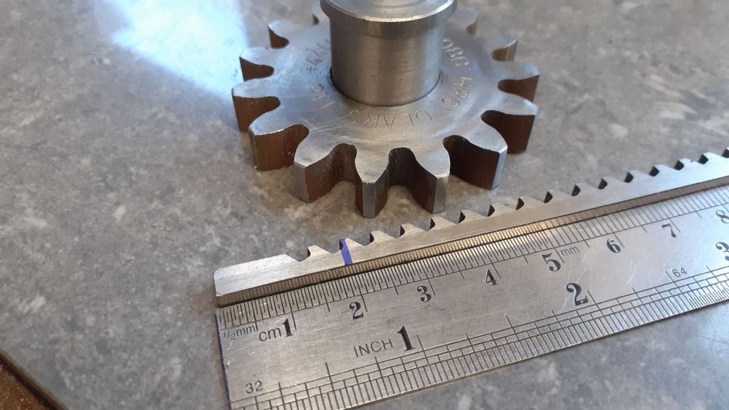

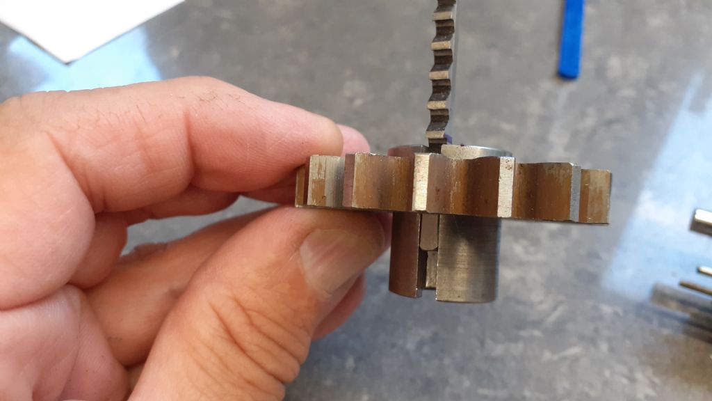

                        #649283
                          This is a 1/8" broach, as you can see the "lead" has entered and can be seen sticking out below the gear, I was just able to push the first tooth into the hole by hand
                          Blue mark was at the top of the bush so you can see how much length could be deducted from the total of part plus O/A broach length. The 12mm or so is what would go in before first tooth.
