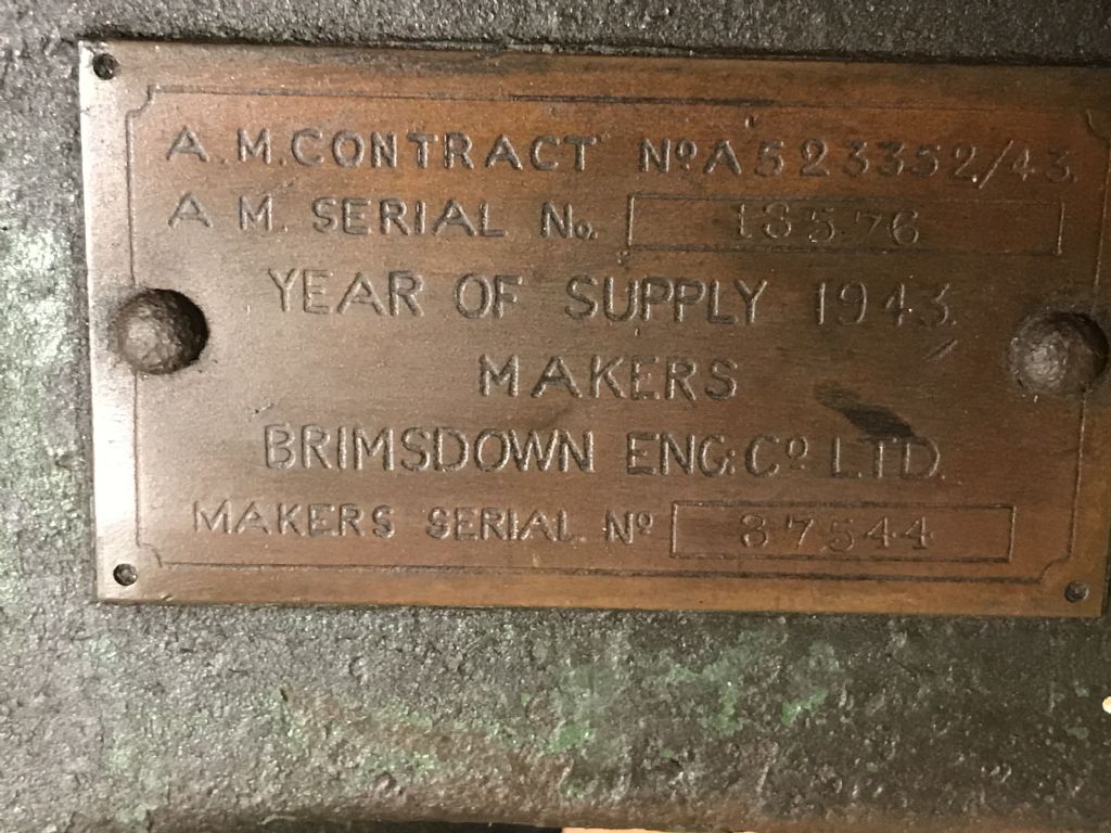

            Hi I’ve just acquired a Brimsdown today it was made in 1943 and last derided in 1947 it has 2 plates on and drills fine it’s had a later motor added at some point the original on off switch still works I’ll put 2 pictures of plates on it has a contact number on it suggesting military work . What you think ? How dio I add pictures ? Ken.

            Rainbows
              @rainbows
              Go to Albums near the top of the page and then select Add new photos. Once you have made an album with photos you can stick them in your post by clicking the camera symbol at the top of the post making box.
