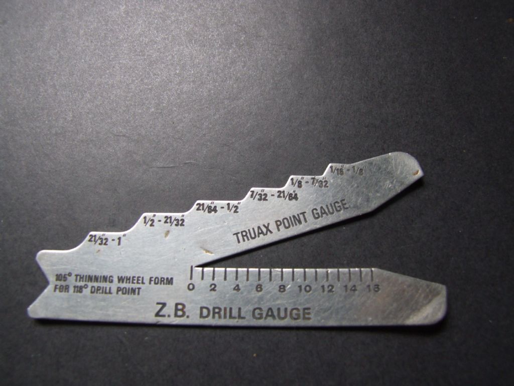

                                          At the suggestion of a couple of members I direct you to another seemingly unconnected thread ! THE MIDLAND – THE ONLY SHOW IN TOWN ! Be patient and follow throught to the start of October where I offered some of my experiences that IF you have a Brierley may be of interest. There are 2 points that see these machines go haywire ! A) The timing of the cam and chuck, this requires careful setting of the gear train and B) a badly balanced wheel, this will cause real trouble, as by the time the machine comes to the likes of us it may be well worn and a badly out of balanced wheel will cause the cross slide to follow the wheel back and forth ! A basic wheel balancer is not hard to make and will prove invaluable in getting this machine to work well.
                                          The V gauge is a piece of metal Thinnish, Markings 0.100" apart, numbered 2,4,6, Etc to 16. and a V cut out to be 0.500 wide at the 16 mark. You will note a notch cut at the end, this gives you the form for the shape of the edge of a dish wheel for point thinning, though you will need a diamond dresser and the tool to go in the chuck. The angle is 105* with a radiused edge for normal 118* inluded angle drill bits. I will try to add a picture. Noel

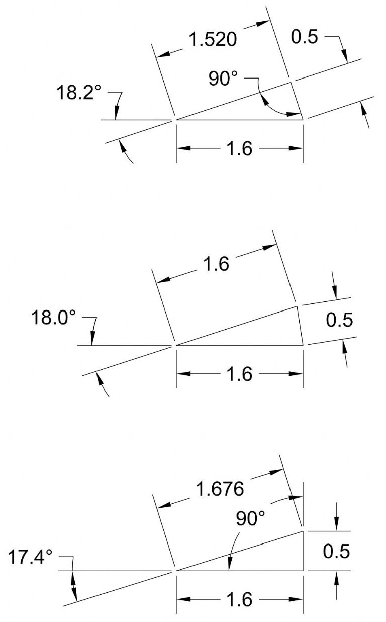

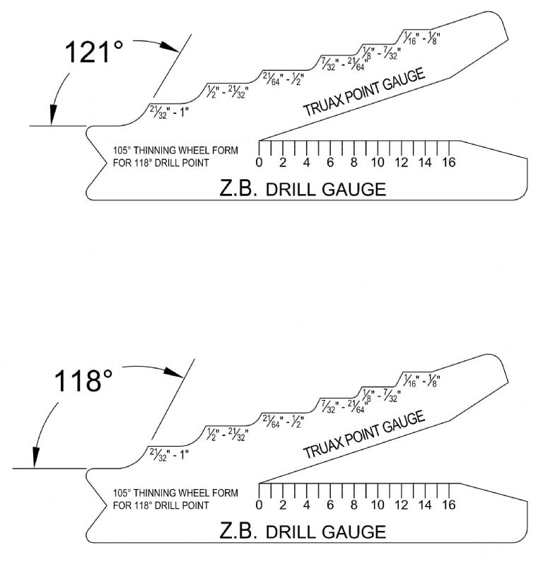

                                          DC31k
                                            @dc31k
                                            Posted by noel shelley on 04/10/2022 12:15:42:
                                            …V cut out to be 0.500 wide at the 16 mark.
                                            … with a radiused edge for normal 118* included angle drill bits.
                                            The descripton above makes it difficult to reproduce as it is open to some interpretation.
                                            See below for three possiblities for V-notch angle using given dimensions. Could you trace the actual angle on a piece of paper and measure with a protractor or put a 1/2" piece of silver steel into it and take a picture?
                                            See also two possibilities for the radiused edge – do you lie the two flutes in the join between 'tread' and 'riser' or is the centreline laid parallel to the 'tread'?
                                            Looks like a crocodile.

                                            #616025
                                            noel shelley
                                              @noelshelley55608
                                              I go with 18* ! You put the drill shank in the groove to give the cutting size, not some reduced area. Although for this purpose 0.6* or 0.2* will not make a significant difference. It was a simple way of measuring a drill bit, the numbers refer to the drill diameter in 32nds of an inch, this being used to set drill protrusion from the chuck and setting the clearance angle on another control.
                                              The 105* for the point splitting wheel is the notch on the left hand end. The notches and dimentions on the top are for form grinding the side of the wheel to generate the truax point which uses cams 11, left hand or 12, right hand, This form became obsolete which is why you rarely see these cams. I hope this is clear ? Noel.

                                              DC31k
                                                @dc31k
                                                Posted by noel shelley on 04/10/2022 23:27:04:
                                                I go with 18* You put the drill shank in the groove to give the cutting size
                                                The 18 degrees is impossible to achieve by putting a 1/2" diameter object between the jaws as it is tangential to neither the top not the bottom. You can verify this by drawing a 1/2" dia. circle on the diagram centred on the midpoint of the 1/2" dimension and noting that it will overlap both top and bottom lines.
                                                From your clarification on the numbers meaning diameter in thirty seconds, the bottom sketch looks more likely, and we can construct the vee more simply by adding a 1/4" circle on the 8 mark and drawing the tangent line.

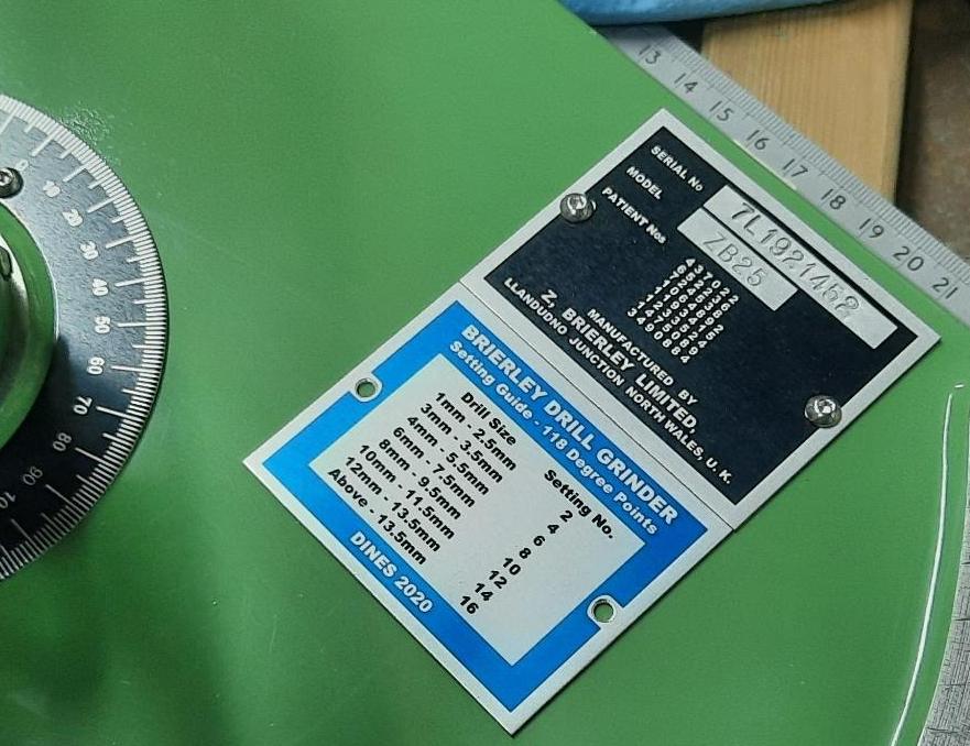

                                                #616039
                                                Howie Dines
                                                  @howiedines14800
                                                  When I rebuilt my grinder I made up a new set of plates. As I didn't have the V setting gauge I just made up an additional plate (shown in blue) with the setting sizes.

                                                    Whether 17.4* 18*, or 18.2 * all you need to know is the drill diameter ! Read it off the shank, measure it with a caliper or micrometer or use some sort of gauge ! Convert this dimention into X number of32nds of an inch and this is your setting number. As has been pointed out by Howie the V gauge is not really needed.
                                                    The need to generate the TRUAX point has been overtaken by split point / 4 facet grinding and the cost of boxes of 10 4 or 5 mm bits making it not normally worth it. To change from normal 118* point to TRUAX requirers a 11/12 cam and a differnt wheel to be fitted and dressed to the correct form for the bit size.
                                                    Point thinning on larger drills is fine if you drill through in one , but it is often quicker to pilot hole in 5 or 6mm first. ! Again you need a second wheel ! Noel.
