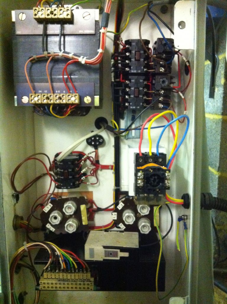

        Hi,
        There have been some very helpful comments on this subject before, so I do hope that a few of you can help me with three specific questions. I have a Leicester made Bridgeport (1984 I think) with pancake motor and belt drive, fed from a Transwave static converter of 2.2kw. It has been fine for a couple of years and I only ever run the motor at slow speed.
        But, I was switching between forward and reverse, probably did not wait long enough for the motor to stop properly, and now if I press 'run' no contactors are latching so it will not spin up.
        I have checked the three feeds from the Transwave arriving in the cabinet and I am getting 420v, 420v and 0v across the three pairs (which I think is correct), the six fuses (FU1-3, SFU1-3) all test ok, and if I manually press contactor C3 the motor runs but does not latch.
        Q1: could anyone let me have a detailed circuit diagram for the cabinet please? I have the 1979 drawing from the manual but it tells me nothing I can follow. I want to be able to trace from the 'run' button to contactor C3 that I would guess is not firing.
        Q2: anybody have an idea what may have blown/tripped if I did reverse the motor too quickly?
        Q3: A year ago I did have in mind fitting a 90L frame motor on an adapter plate in place of the pancake motor with a Newton Tesla inverter and remote handset; maybe this problem might spur me to do it. My question is how to keep the 6F long feed working if I take all the three phase out of the cabinet. I think the 6F control board only needs 110v, so is it sensible to rewire the input to the big transformer from 420v to 220v and use a new 220/240v fused supply? Will the contactor for the long drive still work so that I can isolate it still from the front panel?

          Have you checked if there's an overload tripped ?

              As the motor runs up OK when you manually operate the contactor its likely that the problem lies with the overload cut out system. As far as I'm aware Bridgeports of your era are, like my slightly earlier machine, fitted with overload cut outs which can be set for either manual or automatic operation. If set to manual you have to operate a small switch on the input side to reset the device whilst in automatic mode it self resets after a suitable interval. The selector / reset switch usually ends up close to the cabinet side and its pretty much impossible to see whether its set to automatic or manual. Automatic re-setting can become unreliable on older machines. Presumably because it sits there for years and stuff builds up so the spring or whatever that provides the re-set action isn't strong enough to bring things back into position. Mine decided tor randomly trip out and not reset for, presumably, similar reasons. Cure was a good spraying with contact cleaner lubricant accompanied by operating the manual / automatic / reset switch a few times.
              For all practical purposes wiring diagrams for machines with DC motor driven feeds, 6F / 8F, are interchangeable with the transformer, contactor and overload connections clearly shown on the left hand side. All the contactor overloads are in series so if any one has tripped and not returned nothing will work. The feed control part is always bit cramped and not exceptionally clear.
              The feed and contactors all run off 110 V, usually marked LL1 and LL3 on the wiring diagram so if you switch the transformer input to 240 V everything in the electrical cabinet will work as it should.
              Replacing the pancake motor isn't as easy as it seems. The output shaft is much longer than a standard motor so you need to put an accurately concentric extension on. Any error and it will vibrate like nobodies business, as my pal John found out. Mounting is bit tricky too. John butchered the front bell end of his pancake motor to make a mount and fixed the adapter plate to that. Personally I'd fork out for a quality re-build on the pancake motor if it went wrong. Its a high quality machine and almost certainly far better than anything affordable found via the usual sources. The one major weakness for home shop folk is that its not particularly happy on static converters so if its not in pretty good order a static will kill it given enough time. Probably several years in a home shop but fail it eventually will.
              Static converters should really be set by equalising winding current and getting relative phase as close as possible. Not practical for most folk who must resort to getting the phase voltages as close as possible hoping the passing errors are similarly small. Unfortunately even quite small voltage errors, 10 to 20 volts, can be associated with much larger current errors to which some motors are more sensitive than others. I would never run a Bridgeport pancake motor off pure static converter. Putting an pilot, unloaded, motor in series makes them much happier.
              Clive.

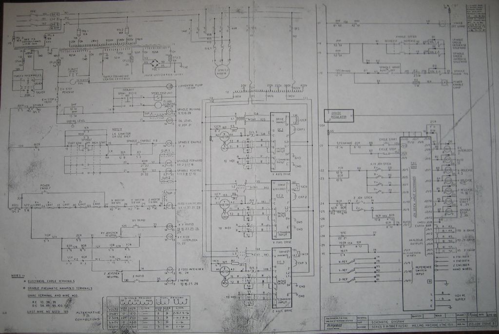

                Hi Norm,
                Have you checked that you have the 110 volt output on the transformer ? I think this is use for the control circuits.
                Here is one schematic I have that may help you to trace the fault.
                Les.

                  In the picture of your cabinet, it appears that the screw in fuse (if that is what it is) on the extreme left of the cabinet is blown, as its indicator is not visible in the window. . The output from the3 phase transwave should be 220v on each phase when tested between phase and ground (earth). Check through the overloads with a multimeter (POWER OFF!) to confirm continuity. It is possible that the missing phase is one of the phases that operates the starter coils in the contactors, so the motor runs up when you manually close the contactor but will not energise when you press the start button. On pure three phase systems, the Coil on the contactors is rated at 440v and operates between two phases, if either of these phases is missing the start button will not work. Is there a button marked "reset" or possibly "STOP" (Reset). if there is push this and try again!
                  #225843
                  Phil Whitley
                    @philwhitley94135
                    OK, swift rethink, can't actually make out the circuit diagram, but if there is a 110v control circuit you will have to test for this voltage to earthy at the start button. If it is not there, that is the problem. Is there a neutral in the cabinet, or is it just 3 phase?
                    Phil

                      Hi Norm,
                      The file I have of the schematic is slightly better quality than it is in my post on the forum. If you would like it emailing to then PM me with your email address.
                      Les.

                        Thanks for all the replies.
                        I feel a bit of a fool because I had not noticed anything that looked like a trip that had released but with all the suggestions about the overloads, when I poked OL3 it clicked and now it all runs. Dooohh…..
                        Phil, the Transwave only gives a voltage on two of the pairs when no or minimal current is drawn, that is how they work. The third phase is generated by inductance (I think) when the motor starts to draw current. Yes that fuse is missing and someone before me bypassed it with the fuse unit that lies in front.
                        Chris you have kindly confirmed my thoughts that I can rewire that transformer to 220v input and I note that yours is working well.
                        Clive your comments are very helpful. I must see if the trips are on auto or manual. Yes I can see that extended running on the Transwave static might compromise the pancake motor. But since the motor is strictly 440v only I guess my only options are a 2kw rotary converter which at £700 is more than a new 220v motor+inverter+ controller at around £500. I have found your helpful comment on 21/07/15 http://www.model-engineer.co.uk/forums/postings.asp?th=109038 about the Direct Drive inverters but my Bridgeport is the only one my machines still needing 440v.

                          Hi Norm, Not familiar with transwaves, but gathered afterwards that the third phase is generated by the motor itself. then checked in my Brooks book, and it all came flooding back! Yes, it is usually something simple! I am lucky, I have real three phase! Glad you solved it!

                                          It's here two version of the U.K. Bridgport circuit schematic. Enjoy!
                                          https://groups.yahoo.com/neo/groups/bridgeport_mill/files/Johns%20stuff/
