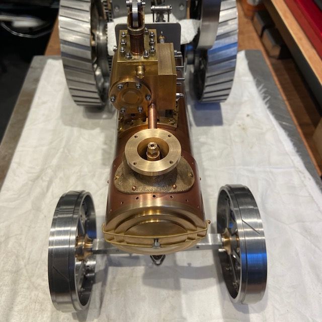

          Another bit done, least the smoke can escape now!

            With the chimney saddle now complete i am going to look at drilling the exhaust port in the end of the cylinder,
            The chances are i will never steam this engine, but just in case i ever did, or maybe someone else does, should i allow for a gasket between the boiler and cylinder? and am i correct to say there is no need for a gasket between the chimney saddle and the smoke box ?
            Thanks all.
            #452795
            Jon Lawes
              @jonlawes51698
              I would imagine not; there isn't any pressure there.

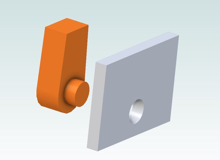

                        Hit a slight snag on the engine. When I machined the side of the boiler I made a mistake and took it a little undersize.
                        Looks like the 1/16" reversing link should run between the side of the boiler and the horn plate, anyway, mine won't.

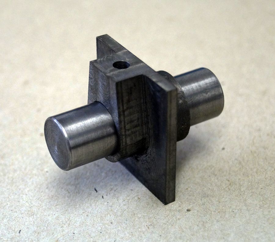

                              Henry, have you considered one piece cast iron bearings, thats what I am going with for all the bearings in my electric version. C/I is reasonably cheap, machines very well and as I understand it a good bearing material which I would have thought fine for a slow moving vehicle such as a traction engine.
                              A picture below of a test bearing I machined for the main axle.
                              Sorry to intrude into your thread Brian, your Minnie looks excellent by the way very nice indeed.

                                Hello Ron. Thanks for the reply.
                                I was thinking about cast iron but i ordered some steel square this morning.
                                Your cast iron one looks good though.

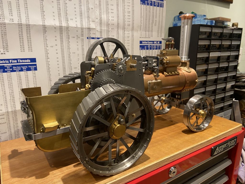

                                                  #480685
                                                  Brian Abbott
                                                    @brianabbott67793
                                                    Hello All
                                                    I am having a problem with a bouncing link assembly when in reverse.
                                                    Thought a video might explain it better than i can, just hope it works.
                                                    Any help would really be appreciated.
                                                    Thanks
                                                    Link Arm
                                                    Edited By Brian Abbott on 18/06/2020 13:04:42
                                                    #480702
                                                    Dan Jones
                                                      @danjones77555
                                                      Brian,
                                                      It looks like you’re holding it up too high or there isn’t enough clearance between the bottom of the radius link and the die block. You might find that when you hook it up to the reversing lever it’ll hold itself in place and allow you to set your notches/time it all properly.
                                                      It all looks good apart for that, good work!
                                                      Cheers,
                                                      Dan
