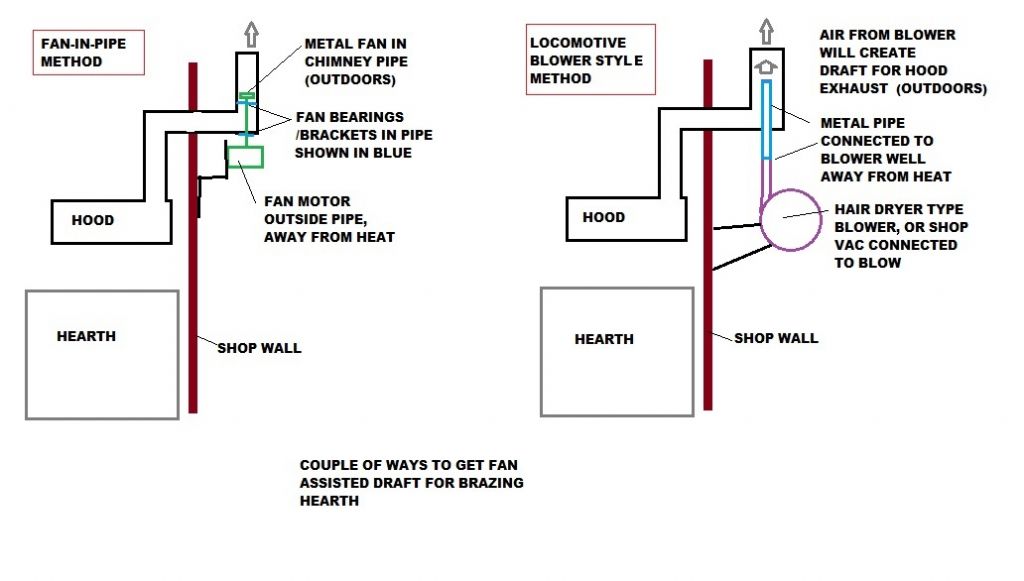

      I am about to embark on my first boiler and I am setting up a brazing hearth. My workshop is a double garage, integral to the house. I have obtained a used Flamefast hearth which will be sited against an outside wall of the workshop. There is already a 6" dia hole through the wall above the hearth. In order to ensure maximum safety I plan to have some sort of hood over the hearth with an extract fan exhausting through the wall.
      I am seeking advice on how to construct this and what kind of fan to use, bearing in mind the possible temperatures involved a few feet above the brazing operation and the need to ensure safety from fire. I want to keep costs sensible too!
      How have others tackled this issue.

          Couple of ideas for fume extraction below in sketch. Just food for thought. Standing by for the usual arguments disagreements etc from the armchair engineer fraternity. I've used both methods with inexpensive "found" motors / fans / blowers, they do work.
          #391443
          Jeff Dayman
            @jeffdayman43397
            Re my sketch in previous post – needless to say a tee or rain cap should be used on the outlet pipe to keep rain out and away from fan or blower pipe. For the fan in tube method, a coupling and extension shaft from motor to fan will be needed. Nothing fancy needed though, mild steel shaft and ordinary ball brgs w metal seals will last quite a while in the heat. The blower method has no rotating parts in the heat, just a simple to fit metal tube. If a shopvac is used for blowing, it can be disconnected from the metal tube outdoors and brought indoors for other tasks when hearth is not in use.

              You could also use a compressed air jet in place of the fan (or shop vac) in Jeff's second method. Use small drillings in the nozzle to reduce the volume of air used, if you three or four small jets appropriately angled (like a loco blower) you can get maximum effect for minimum compressed air volume.

                By the time the hot air reaches the fan it will be well diluted, I'd just use a 6" shower extractor fan and see how it goes.

                  Hmm, Spark arrestor – you wouldn't like any sparks going op into the soffits of the roof.

                      From what I remember of using a flamefast brazing hearth the extractor was very powerful, if you let go of a sheet of paper it would lift it into the canopy only stopped by the wire mesh. Probaly looking in terms of cubic meters min not per hour which bathroom and kitchen extractors are measured in.
                      Also don't forget to let air in otherwise your fan will just be pulling a vacuum
                      EDIT, just looked on Flamefast's site and their extractor is rated at 650cfm or 18 cubic meters per min
                      Edited By JasonB on 17/01/2019 08:01:43

                          From the comfort of my well-appointed armchair I see Jeff's fan requires outdoor electrics. In the UK (240VAC) that means Building Regulations, at least for a permanent installation. I suppose it would be OK to power the fan with a temporary extension when needed, and not use the hearth in the wet?

                            In sketch 2, move the fan inside the building, mount it above the hood, and inject the air into the first bend , you could even take the pipe round the second bend if you are one of those picky perfectionists like me! Funnily enough, this is exactly what I was working on today, I also have an old flamefast hearth, the round type with the revolving table. I am making the flue ducting from sheet galv steel, and the flue will accomodate a woodburning space heater, a forge, the brazing hearth and a welding fume extractor, each will have a seperate shut off to maintain flue vacuum, and I have a selection of centrifugal fans of varying powers. When it is all finsihed (couple of weeks depending on time off for snow!) I will post some pics up if anyone is interested.
