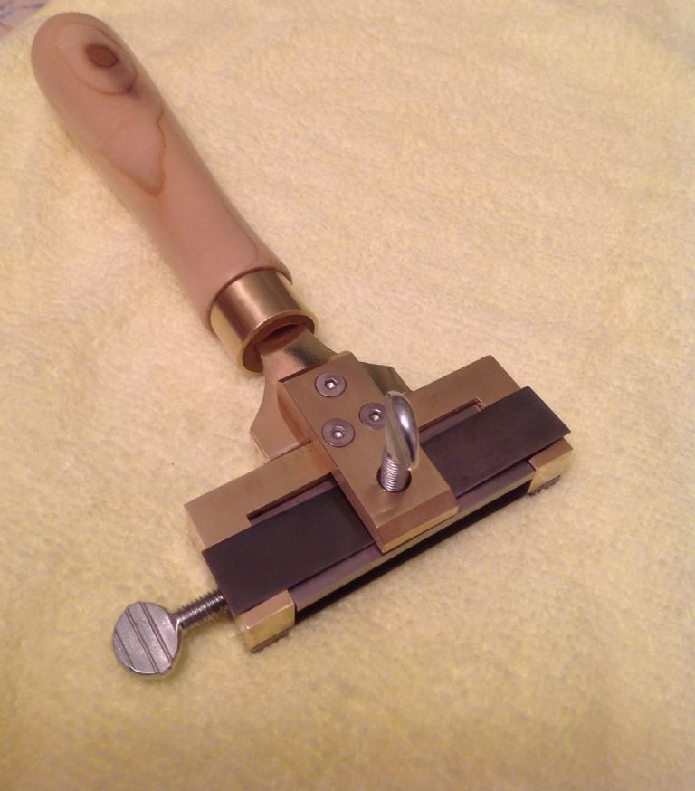

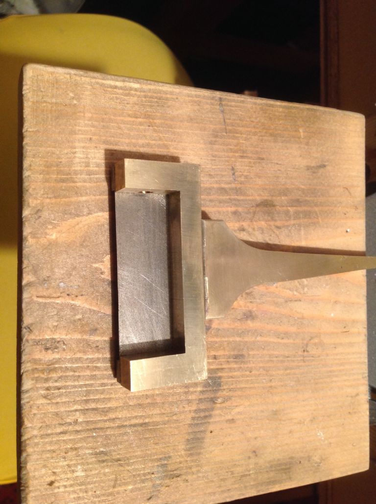

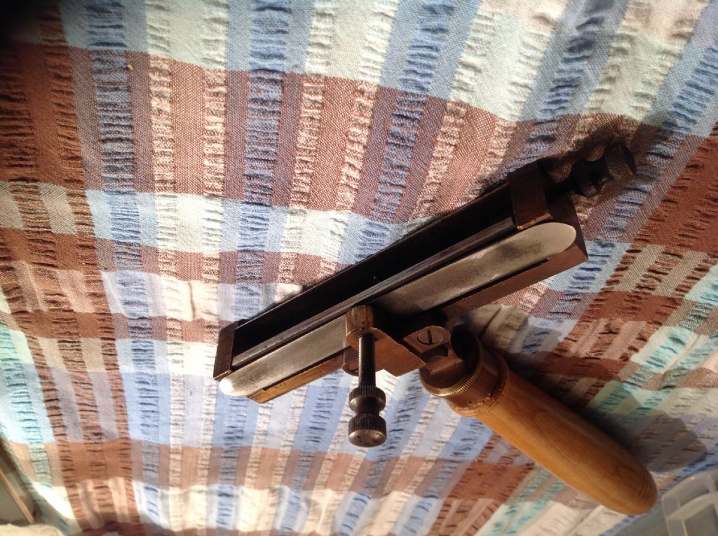

      The images show two typeholders, one made commercially many years ago and one still in the process of being made by me.
      As you might expect, typeholders like this are used for holding moveable type, but specifically bookbinding type, which is typically brass.
      I milled the brass channel (about 2.5" long) out of brass bar, and would have liked to do this after brazing the shank on to it, not before, but since, in order to get square not rounded inner corners, this milling needs to be done with the open side facing upwards, and the tiny Proxxon milling machine I have doesn't allow me to stand everything upright once the shank is in situ, I had to mill the channel on its own before brazing.
      The reason I'm posting this is that I noticed after I had brazed on the shank that the formerly perfectly flat, long internal edge of the channel was no longer perfectly flat, but was ever so slightly convex. I'm fairly sure this is a result of brazing with the open end facing downwards and the weight of the channel and shank being supported by the "arms" at each end. Essentially, I think the channel sagged slightly once it got to a very high temperature and stayed that way after it cooled.
      My question is, if I do this project again but this time lie the channel down for brazing rather than standing on its arms bearing the weight of the shank above it, will the perfectly flat, milled long edge stay as flat as it was before brazing, or is there still a chance movement will occur?

          I see little chance of the part staying exactly the same shape before and after brazing. If at the moment the brazed joint 'sets' there is any difference in temperature in between the two lumps of metal, or the way the two masses cool down than there will be an element of differential contraction. I doubt the orientation whilst brazing will make the distortion you experienced.
          Most extruded brass (and other materials) change shape during machining because if internal stresses.
          Is brazing essential, why not fix the shank mechanically?

            On all of the many commercially made typeholders I own, some going back possibly 150 years, the shank and inner body (i.e. the brass channel) are either an integrated casting, or in a few cases possibly cut from a single piece of metal; I have never actually seen one where shank and body appear to be connected by brazing.
            The few examples I've seen where a mechanical connection was employed were all recent and rather naff home-made affairs, and the connection used was only questionably up to the job of dealing with the constant heating and cooling and the considerable forces that are applied when the typeholder is in use.

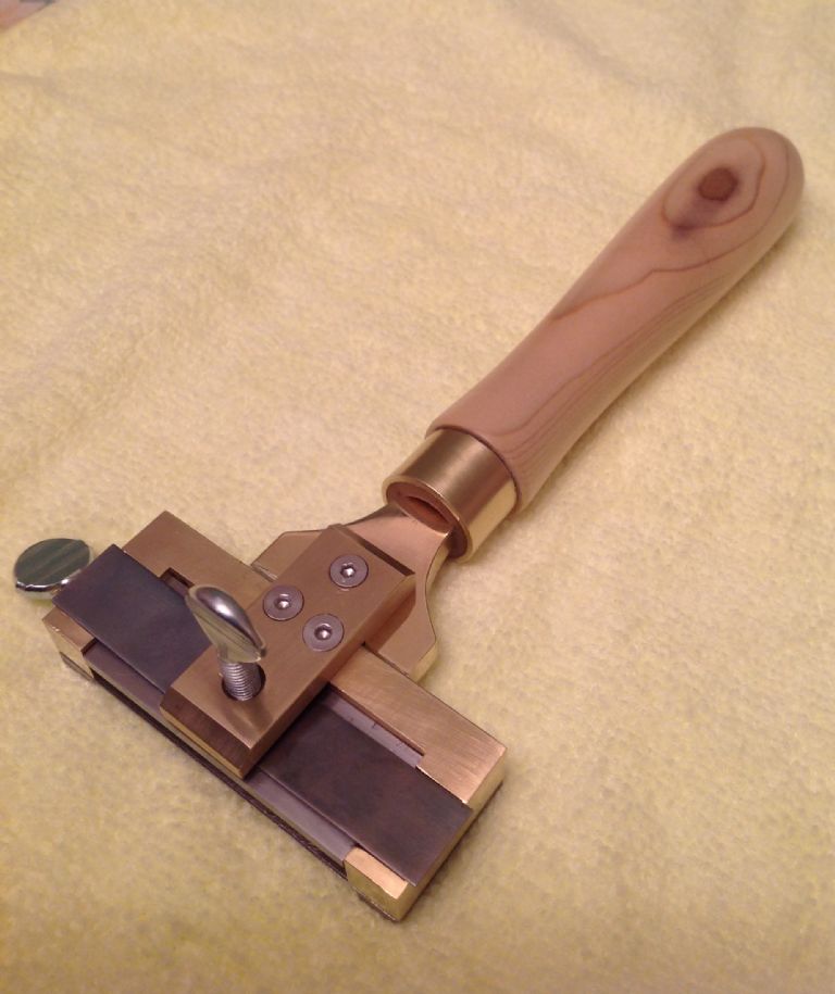

                              I've now completed this project. I ended up hand-filing the long edge flat. I'd have liked to be able to make knurled thumb screws, not use bought ones of the kind pictured, but I've no metal lathe to knurl with (or do anything else with) at present.
                              The tool handle is made from a Magnolia that I planted 22 years ago and lopped some branches off last year.
                              Perhaps the newest aspect of the project for me was hardening and tempering the spring steel (sold annealed). My technique seems to have worked in producing the desired elasticity, but I'm slightly unsure what the optimum tempering method is for spring steel, i.e. what colour to look for in the steel. Some say straw coloured; some say blue. I veered towards blue without managing to retain it exactly in the finished look.
