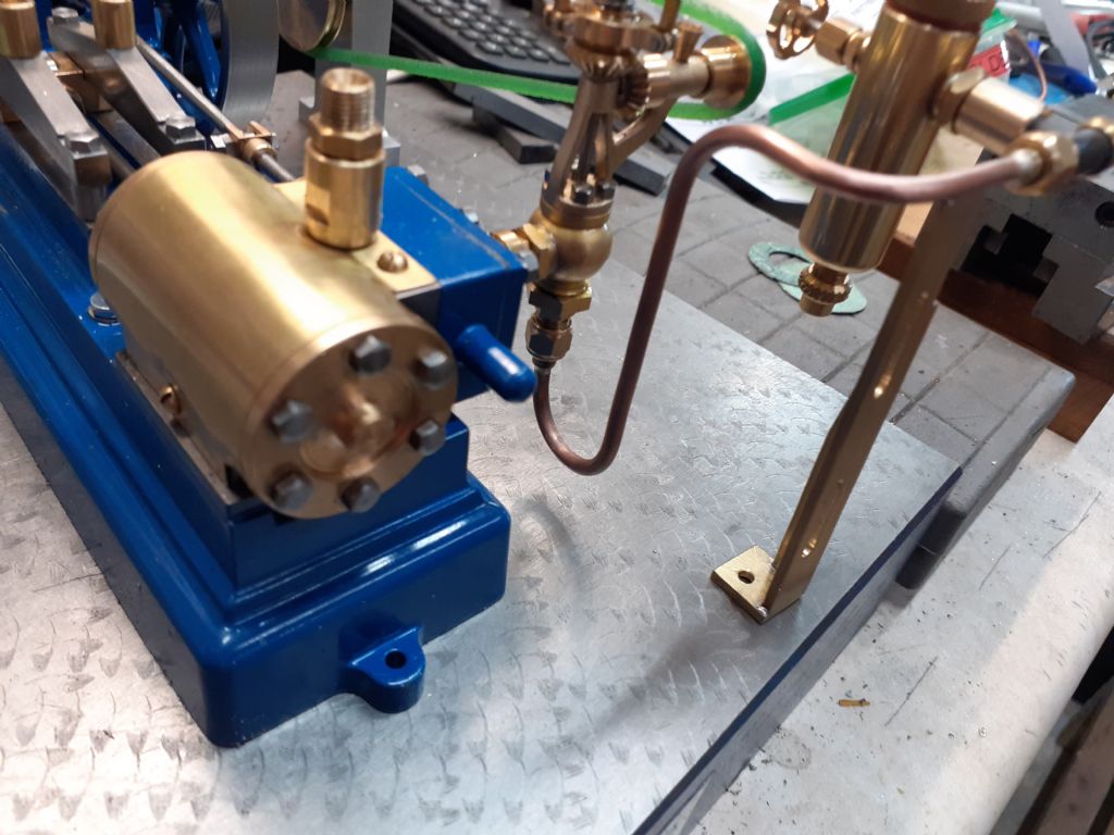

      Hi guys, I have reached the stage on my Emma Victoria build where I need to source some sheet for boiler cleading. Henry Wood suggests 26 swg brass but having difficulty in finding the right size from all my usual suppliers, these are not big enough but metal stockists talk about industrial size sheets measured in metres and at hundreds of pounds of course.
      What do you guys use brass or steel and any pointers to suppliers.

          Try M-machine, they will likely cut to size.

            Hi Bill here is my cladding from M- machine metals.
            David

              Hi Bill try EKP
              **LINK**
              26 Guage in that size is probably available in shim stock so it's worth searching for that instead of sheet.

                26swg brass will dent very easily, For my locos I’ve used stainless steel cut from a ‘pound shop’ bathroom pedal bin.
