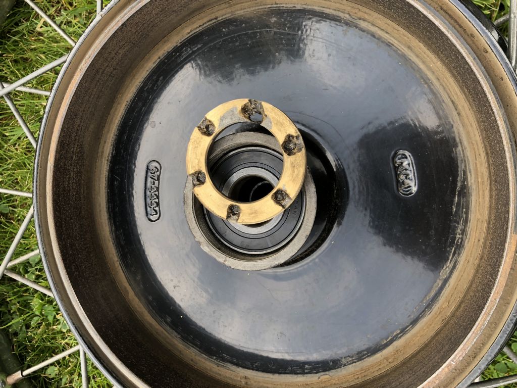

      I need to make some bearing retainer rings for a set of BSA bike wheels, ( possibly originally B44 for a metisse build). They are just over 2 inches diameter so not critically 55 ml, – 2 ⅛ inches would do.
      I need about 6 inches.
      Can anyone recommend a supplier?. Or has anyone got some they want to sell ?

                M machine are usually quite decent .. does it have to be copper? Since these are rings could cast hollow PB be used? It might reduce cost.depending on id.

                  eBay item number: 273050215411
                  A 200mm length of 55 diameter is £60 delivered – out of touch with metal prices, so don't know if that is par for the course or OTT

                    At those prices I would be making them out of a decent grade of aluminium. Are they like the seal retainers found in models like Ariel front and rear hubs?

                      Most bearing retainers I've seen have been circlips…………

                          Chris – thanks , good point , no idea what arials look like but the wrecked ones in are brass so I will be sticking to brass.
                          Bill, – not much good at keeping the mud out tho.

                            Thanks chaps , some good suggestions – seems the £60 isn't too bad when I will get about 6 out of it. A supplier of vintage parts is charging £20 for a single in aluminium.

                                If it's of any help, I've got some 3" CZ121 bar you could use How about £25 for 6" and £6.50 for Myhermes shipping?
