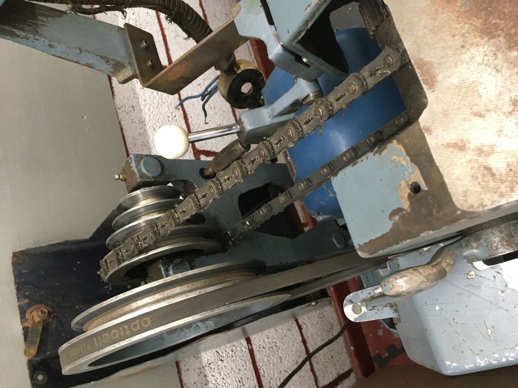

      I have recently bought a Boxford C lathe but it has no accessories so could some one advise me where to get the correct Tailstock Centre & Drill Chuck?. I have tried the home of Boxford but nothing doing!
      Steve

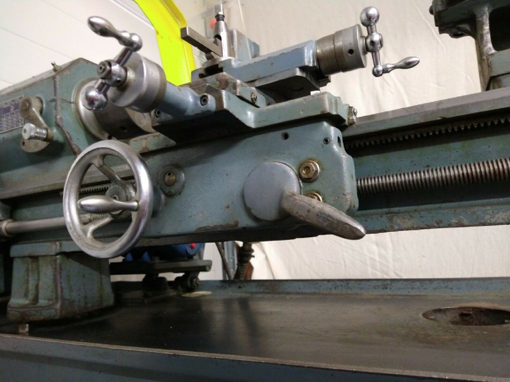

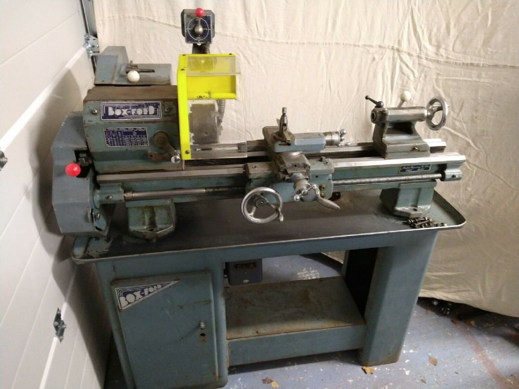

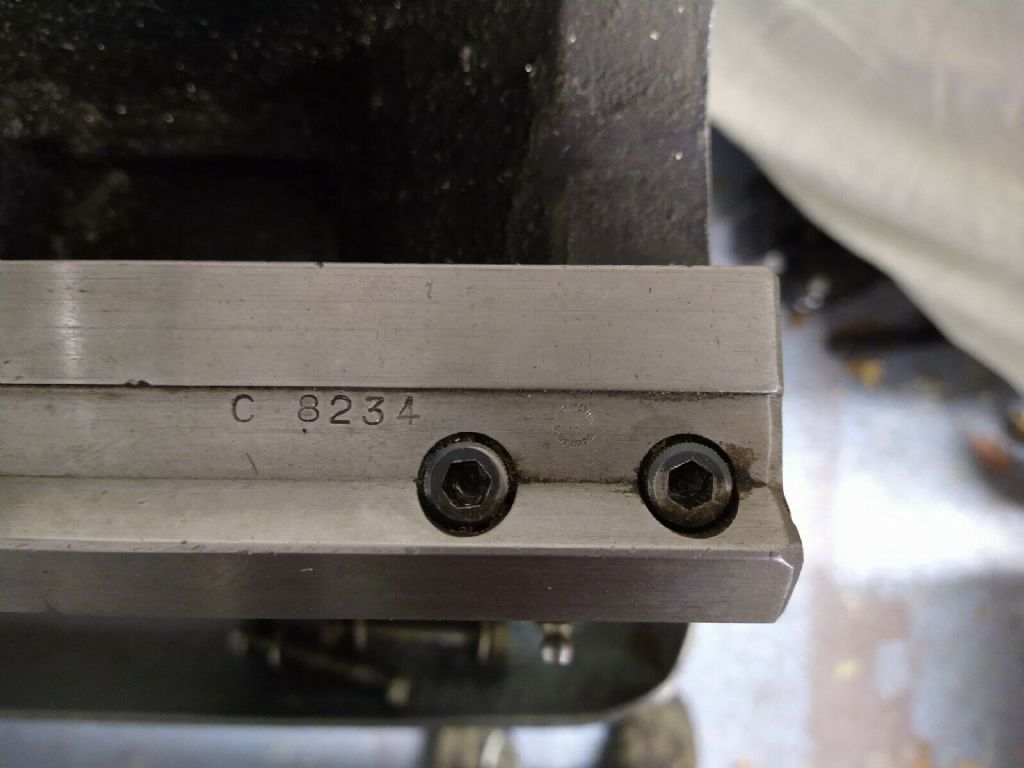

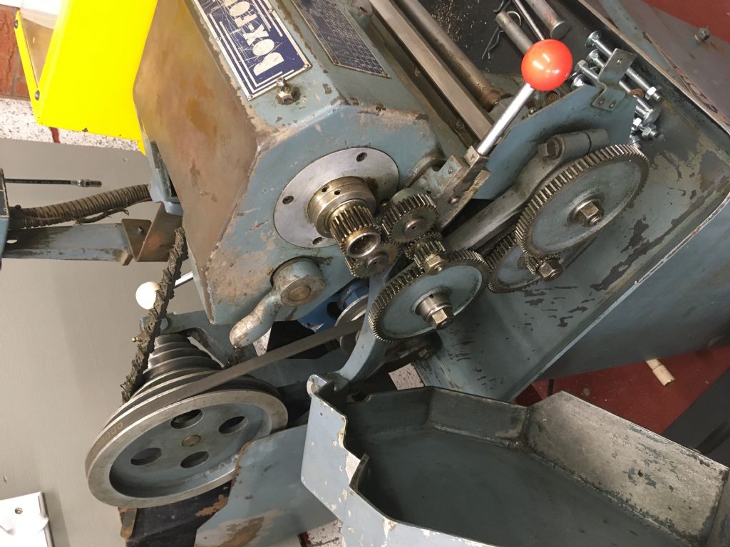

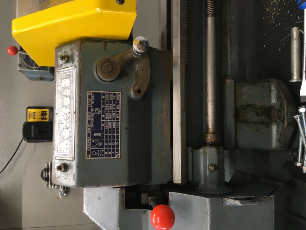

                Because I’m a novice to using a lathe I was wondering if anyone could identify my boxford lathe model because the home of Boxford said I had a Boxford BUD, but I think I have a Boxford C lathe?
                The lathe is stamped: C8234
                see pictures below. What do you think?
                Steve.
                Edited By Steve Jones 20 on 14/04/2020 14:17:06
                #464603
                Yngvar F
                  @yngvarf
                  You are right , it is a model C made in 1958.
                  Your lathe has the same rear drive as the original South Bends.
                  Most later Boxfords had the motor inside the stand, or a under drive UD.
