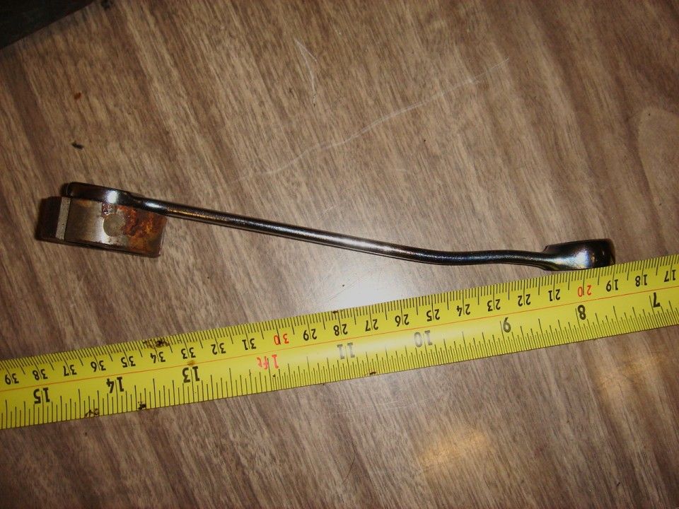

                          #218721
                          Ajohnw
                            @ajohnw51620
                            This what a suitable spanner needs to look like
                            I would tell you the size but it's another thing I have yet to find again. You can check for fit at the change wheel end.
