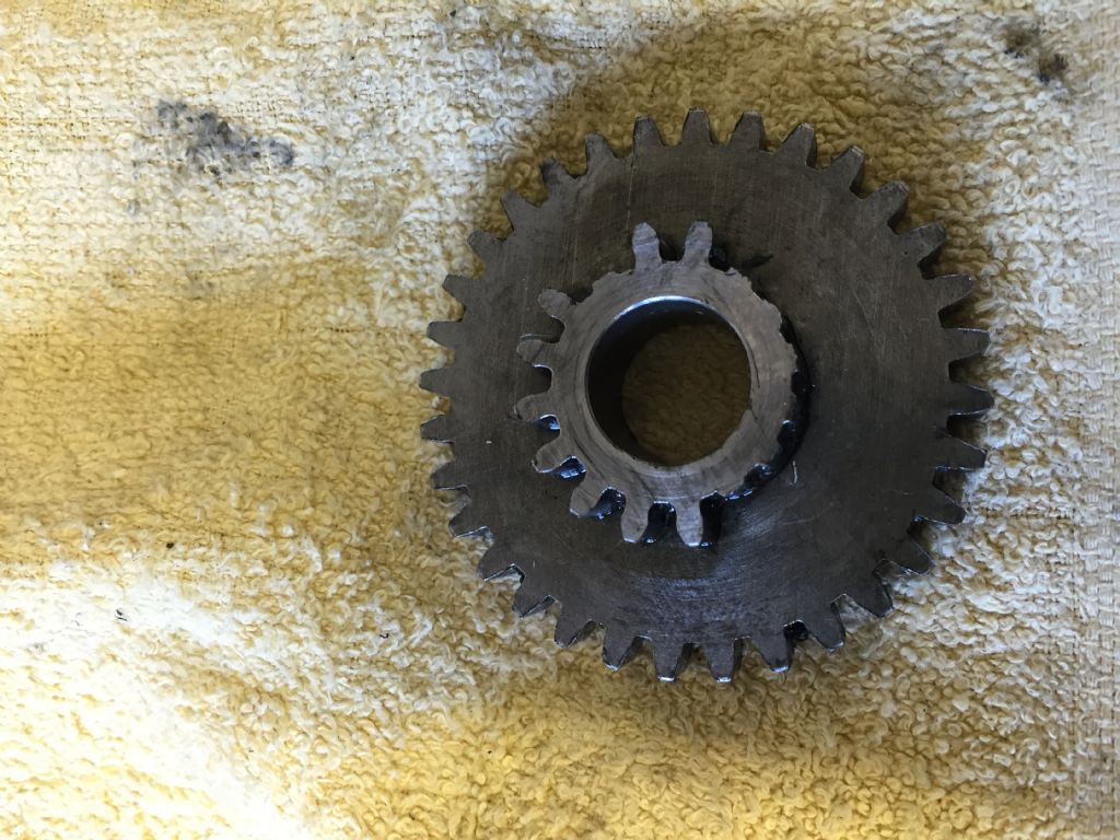

                Thanks guys, got the gearbox off ok and found the cause of the problem… half the teeth missing on the middle 16t gear (partno 292) on the intermediate shaft. I say 16t gear but sadly it's now more like an 8t gear lol!. Could only find 3 of the broken teeth so I assume it's been a gradual process of destruction.
                Looks like it's going to be a long and expensive process to fix. Hey ho – wish I'd bought a model B now and stuck to changewheels for screwcutting.

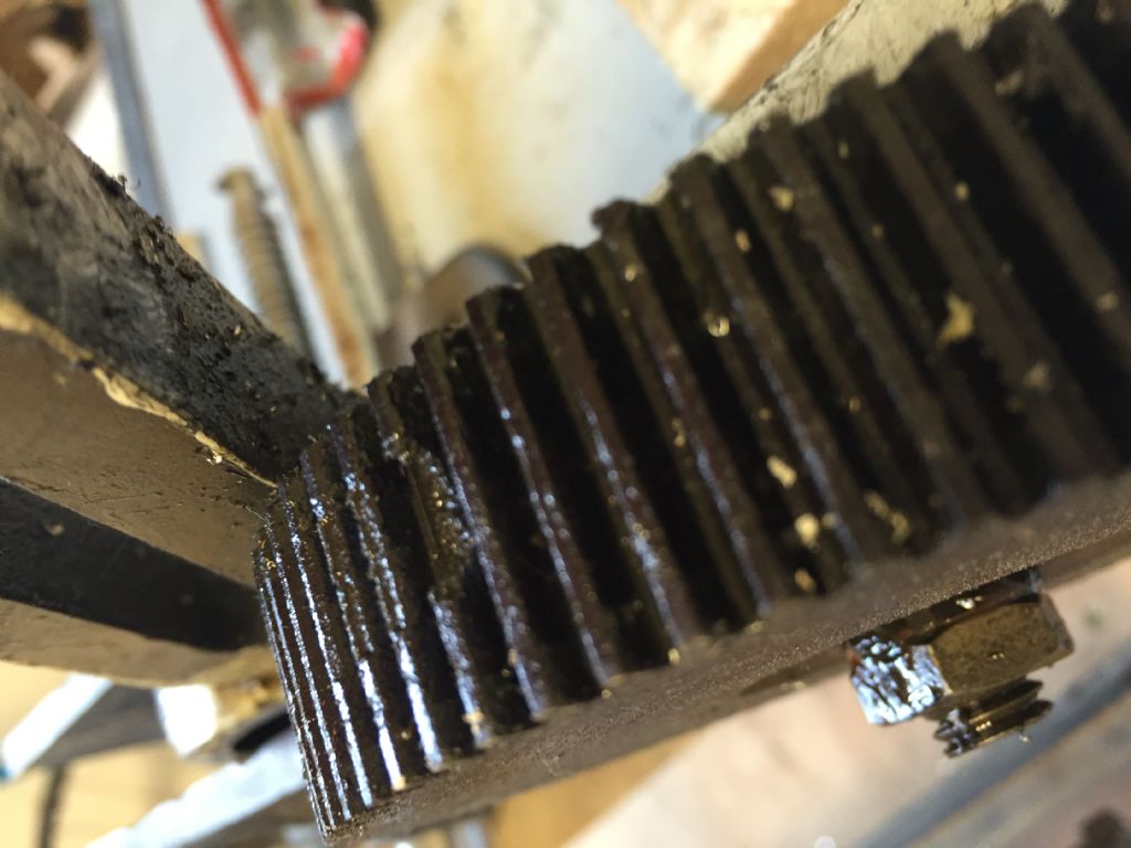

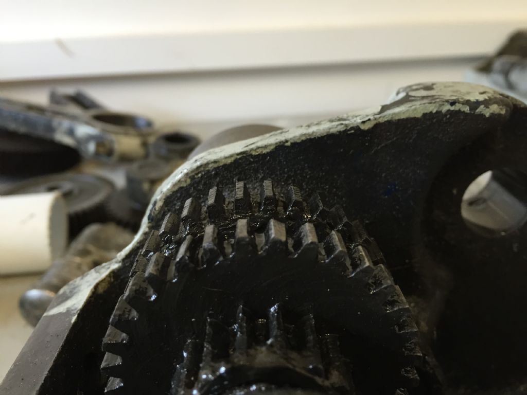

                            I have dismantled the gearbox and found the cause of my troubles. I have included a photograph of the middle 16t gear (pn 292) which is missing 7 teeth. I have emailed John Ward to see how much a new gear will be.
                            The gear it meshes with looks ok apart from two teeth that appear to have their tops ground off – I have added a photo of that too. Any views on whether that one needs replacing too? I am hoping not.
                            A couple of other photos too. The 80t tufnol idler has a tooth missing and an couple have gone – presumably where someone tried to change from forward to reverse while the spindle was turning. I am not sure how much of a problem that will cause – any views.
                            And finally, the great at the changewheel end of the main spindle is also quite worn… I assume there's nothng to be done about that unless I source a new spindle ?? I am surprised it has worn as it meshes with a fibre reverse gear but amybe it had steel revers gears in the past
                            Any comments or advice welcomed, thanks!

                              That's a rather sorry sight, Steve … and it's the design weakness that I mentioned on this thread.
                              I have never seen one that badly damaged. That lathe has certainly not had an easy life crying 2

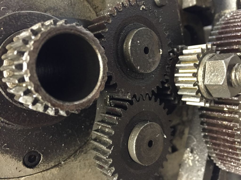

                                I can't really tell from the photo but the gear on the end of the spindle looks ok to me. Not sure why but next to the tufnol gears the teeth always look shallow / less sharp. While Michael thinks it's a design fault and could be right having been on the yahoo boxford group for a long time now I've not noticed anyone having problems with it. Maybe because it's heat treated steel like the rest of the spindle. A better photo of the worse looking teeth would help. Hard to tell from an end on shot but I expect they are ok.
                                As strange as it may sound tufnol gears are known to outlast metal ones when in contact with them. They use the tufnol to quieten the train down.
                                The 80T looks like it has a tooth more or less missing. Best not use it as it is likely to damage another. That sort of thing can happen for all sorts of reasons. I wonder if some one has screw cut into a stop on the bed. I theory it can happen if the mesh is set way too tight. That may explain the broken teeth in the gearbox as well. The newer lathes of this shape have a different power feed arrangement and that can be run into a stop without any problems. It's easy to tell if the lathe has that. There will be a slot running along the leadscrew and a feed tension adjustment knob sticking out of the saddle.
                                I wouldn't be happy with the gear with a bit of the top missing but one way of telling if it's likely to be ok is to watch what happens as it meshes with one hand holding one side of the train and the other the other to provide some tension. You'll be able to feel if it meshes cleanly in that area or jumps etc.
                                I don't know if you have joined the yahoo boxford group but it may be worth while. Some one may have a spare 80T and unlikely but some one may have the other gear as well. There are also generally boxford and southbend gear on ebay. It can be worth asking one ebayer – theplaneironshop othewise known as
                                **LINK**
                                Many of the model engineer type used machine tool sellers may have them.
                                One thing for sure looking at the photo's all needs a really good clean and fresh oil before you use the gear train.
                                John Ward can be rather hard to get hold of. Visiting is one option if you are close the other is the phone now and again. Great bloke etc but he's often hard to get hold of and may not answer emails or reply to messages. He probably gets lots. Boxford will soon tell you if they have parts available.

                                        John and Michael, if you look at the centre portion of the spindle gear where the tumbler engages there is clear evidence of wear in the photos as presented. The ends of the teeth in the one o'clock to 5 o'clock position look like they have been stripped off.
                                        If a new spindle is out of the question but the general state of the rest of the machine is in good condition I would suggest it is a potential CNC conversion. A spindle index pickup and X and Z axis drive is all that is required to make a machine that can still be used for turning and screw cutting. The gear driven drive train is redundant when such a conversion is carried out.
                                        If you think this is beyond what you want out of a lathe you should be aware that by using manual data input (MDI) you can drive a CNC lathe just like a manual lathe but without using the drive train or turning handles to move the cutter around the workpiece. If you want to go further into what is available in CNC you would have the basic setup required with that setup.
                                        If you think you want to stay away from CNC then maybe you could sell it as a machine that someone else could convert to basic CNC turning.

                                            That looks like it's down to the angle the photo is taken to me and if stripped off I would have thought the OP would have mentioned it. edit – the teeth don't go to the end of the spindle, they stop well short but not leaving enough to easily fasten an extension on.
                                            Some people on the electronic leadscrew group have finished up driving the lathe with what is effectively a servo motor complete with a tacho to get accurate screw cutting. Must admit I have wondered but can see the possible problems with spindle speed variation.
                                            Anyway really the bottom line is will it turn reasonably well or to an acceptable level. The gearbox isn't needed to look into that.

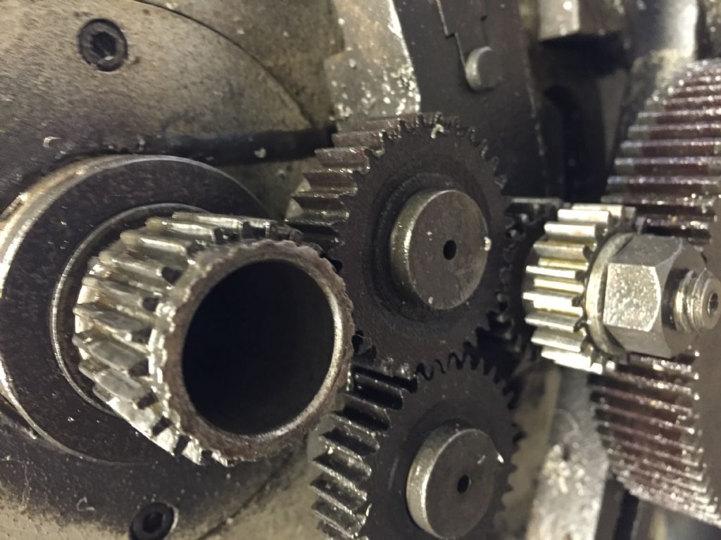

                                                  It might be worth showing people what has been posted where the parts can be seen more clearly
                                                  It's pretty easy to see why swarf can get on the change wheel set up. The one to worry about is bottom slight left of centre. I set my gears to the correct clearance so that they are quiet – a bit got on that one and bent the stud very very slightly. Easy to fix fortunately.
                                                  The browny tinges are photo effects from a residual oil film that seem to have been augmented by a new strip light I fitted recently.

                                                    It doesn't matter if the spindle gear is worn as long as it has the right number of teeth. It is not there as a high efficiency high power transmission system, it just has to keep count for screwcutting with quite low force for a metal gear. That's why some lathes can get away with plastic gears.

                                                      image.jpegOk many thanks everyone for all the comments and advice. Interesting that the Spindle gear is attracting more comments than the original gearbox problem! But that could be because it's a potentially more serious issue, I guess.
                                                      I'm sorry that the photo is not very good I've posted the other one I have below which might be better but any further more focused photos will have to wait until the weekend when I am back home with the lathe.
                                                      However, just to be clear, none of the teeth on the main spindle gear are missing its just that they are quite worn. I think the original photo makes them look worse than they actually are, so I am quite hopeful that it is not terminal.
                                                      For my part, it's quite clear that the lathe has had a hard life – I assume in a school – but I would guess that the gearbox issue resulted from trying to change gear when the lathe was running and the idler gear was similarly damaged by someone trying to reverse whilst the spindle was running
                                                      Prior to finding a problem with some of the gears in the gearbox I did have the lathe happily running power feed in both directions and screw cutting feed albeit not under load.
                                                      Anyway, here's the other photo (oops it's gone in above!). As ever any advice gratefully received!
