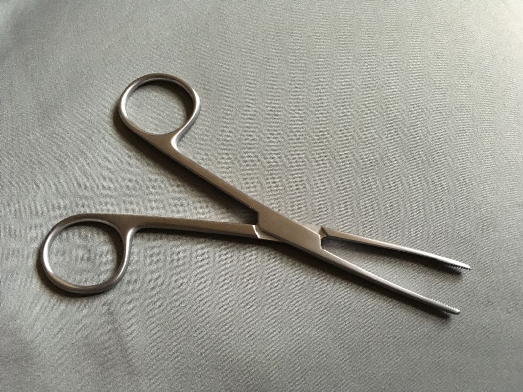

        Good morning folks. I have several pairs of CK box joint pliers. I am just wondering how they are made. There doesn't appear to be enough metal to expand the hole in one leg, then insert the other leg and then close the hole up particularly with end cutters

          Blacksmith technique is
          start by forging the hole the "correct" shape
          then heat it to red hot
          stretch it with a shaped chisel type tool
          push the other jaw through
          reheat to red
          forge the stretched eye back to shape
          make hole for pin
          Video of the blacksmith method here
          **LINK**
          Industrial techniques will be basically the same but adapted to series production. I suspect the apparent lack of metal to expand the hole in you CK pliers is due to grinding down to size after the pliers have been made.
          The bit I really don't get is how they manage a precise fit in the hole with just enough clearance for operation but not so much that the jaw wobbles sideways.

              Another thing, why don't the two halves weld themselves together at white heat ? Mystery.

                          The halves will not weld together because firstly the steel is only heated a dull red, and secondly because the joint is only closed enough to fit.

                              Although the ones I photographed were purchased ‘non-sterile’ … I feel pretty sure that they are a surgical design: and as such, they would be sterilised in an autoclave.
                              Edit: __ That pair don’t have the locking mechanism; so technically they are not ‘Artery Forceps’ … but this should confirm my supposition:

                                I have a pair of forceps like Michaels and I would say that because the length of the slot is long in relation to the thickness of the part that has to pass through the slot, they could be manufactured by the blacksmithing method without even needing to apply heat,
