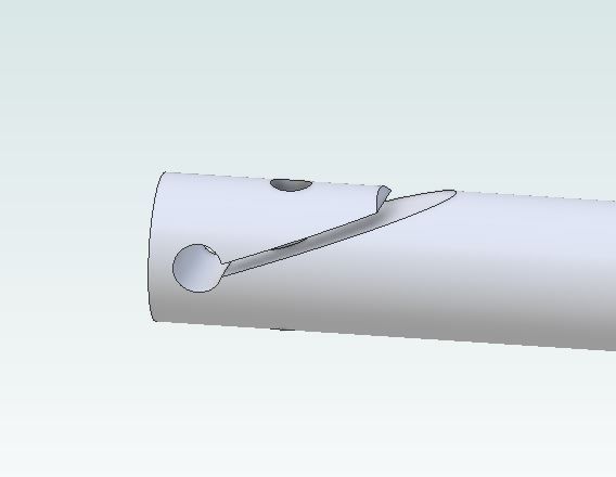

                        I'm not seeing why they should be forged. Looks like they are just a bar cross drilled for the tool bit, drilled and tapped at 90deg to that and then a slitting saw cut at a shallow angle. Should be possible to remove the screw and slide them into a round holder.

                            Don't know Michael but searching e-bay for "armstrong boring bar" I can't see any bars that look to be forged ( or forged ones in your link). The comment about better than a grub screw would also make these a candidate as there is more thread engagement and a bigger hex which would be an advantage.

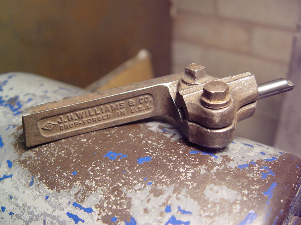

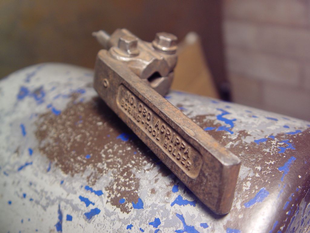

                                    dsc02703.jpgI'm talking about these, more properly boring bar holders, they will take round HSS or the boring bars above
                                    Plus a normal Armstrong tool holder.

                                      I looked at that listing at the outset and couldn't see how the bar itself would be held.
                                      Thanks for your drawing; the arrangement looks superior to the usual grub screw.
