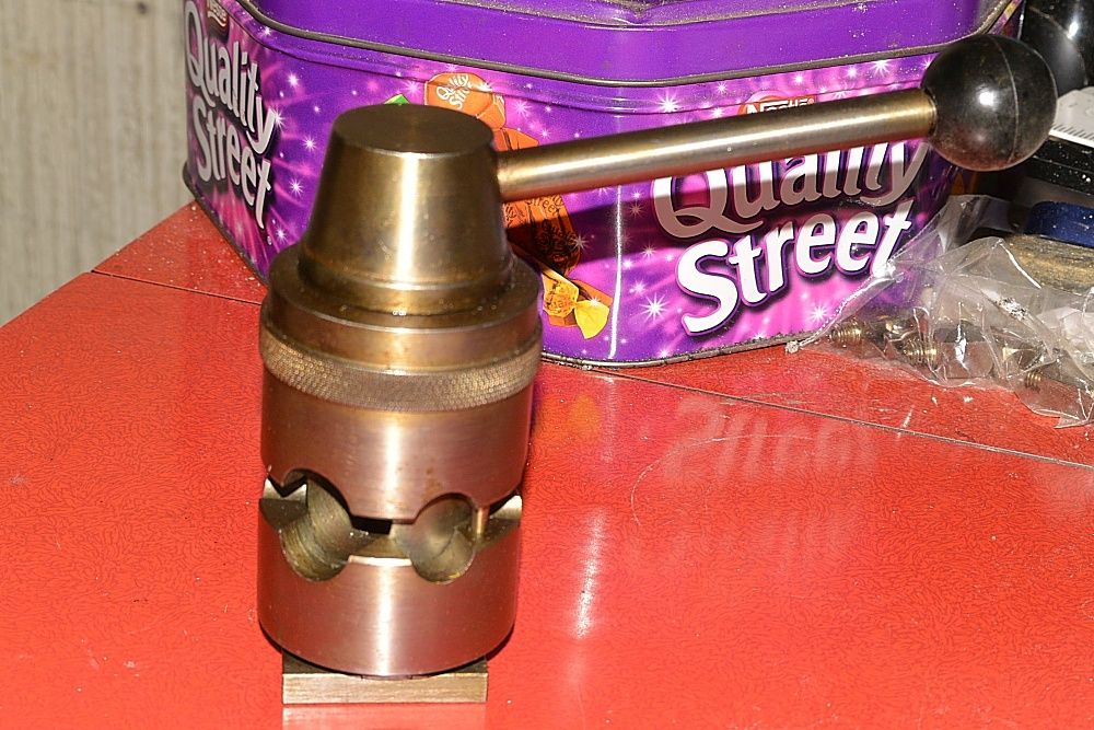

                        KWIL
                          @kwil
                          Myford style QCTP
                          16mm boring bar on Myford QCTP (non standard size holder)

                              Where from. I have looked all over the place but wont machine more of the normal holders. Not keen on setting up the angles on the blocks to the required level of accuracy either. It's more the sort of job for a horizontal miller with correctly ground cutters. Some on the boxford made lots that way.

                                  I was going by the colour photo at the beginning which shows one fitted to a Myford Cross slide. If it is just for the topslide then I see even less point in it today, may have been relevant when the old style toolposts were in common use.
                                  Kwil, whats the actual clamping thickness of your 16mm bar allowing for the top & bottom flats?

                                    Boring bar passes through 16mm hole in block, I can check the actuals later.

                                          Flat to Flat dimension is 15mm.
                                          My Holder is 1.140" in height, Base of holder is 0.255" below flat, 0.3000" above flat and the holder clears thetop slide by0.115". Centre line of Bar to centre bolt of QCTP, 1.9" approx.
                                          Holder home made on vertical mill, angle setting a piece of cake with X & Z DRO readings the same!
