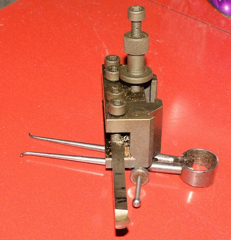

                              #198342
                                Not a briliant pic, but I find one of these, angled slightly is the stiffest style for any given hole size.
                                boring bar
                                #198351

                                    Neil, not clear from your pic but is the round tool steel just ground on the top to about half way and on the end only, leaving the rest of the bar round, with the slight angle providing the necessary clearance? What size are we talking here?
