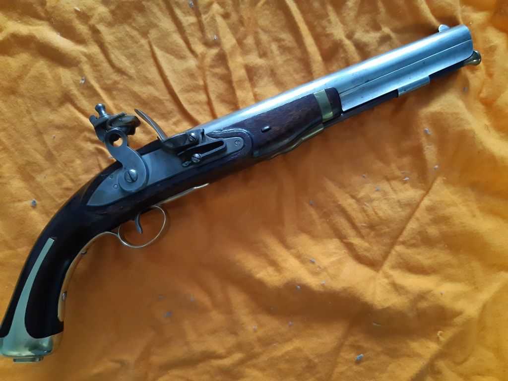

                        Thanks for the replies. As its a replica the replies state theirs no need for a straight through bore. My uncle made a flintlock many years ago and my first effort is not up to his standards, he did make it at work soimg-20211025-wa0001.jpg must of made the barrel bore in one go, his gun all works but has no charge hole so safe. My first effort is not up to his standards but the lock works perfectly, the hardest parts was the pan and frizzen to make. This is a photo of my uncle's gun my first effort is under flintlock in my albums. A nice cannon Mick made its a shame you can't try it out, but the law won't allow it,it's odd that you can buy all the ingredients and make gunpowder, two really as charcoal is easy to come by.
