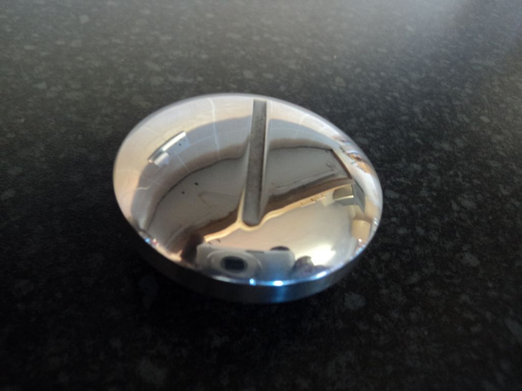

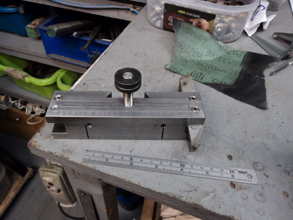

                  jimmy b
                    @jimmyb
                    I'd go for a form tool and a "sprung holder".
                    I've done some big rads on a few stainless jobs that way. The head is about 1 1/2"
                    Jim

                            Beautiful work which I would hesitate to touch with a screwdriver!
