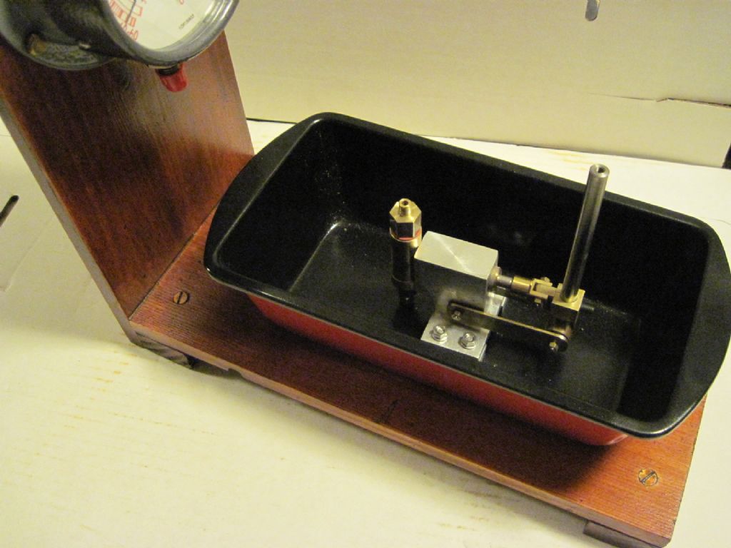

              #425749
              IanT
                @iant
                Bill,
                Mine was loosely based on a design that appeared in EIM ( I don't have the reference no. to hand but I'll scan the article for you if you'd like it – just PM me) – and uses O-rings to seal the valves. I just used off-cuts I had to hand, so the cost was minimal. It's all mounted in an old bread baking tin my wife was throwing out that got re-sprayed. The pump bore was just drilled to take the stainless piston with O-ring seal – no reaming – I didn't have the right size to hand if I recall correctly..I was worried if it wouldn't work or wear too fast – but it pumps just fine and for my testing use only get used very occasionally.
                Photo was taken a few years back during construction but you will get the general idea I hope.
                Regards,
                IanT

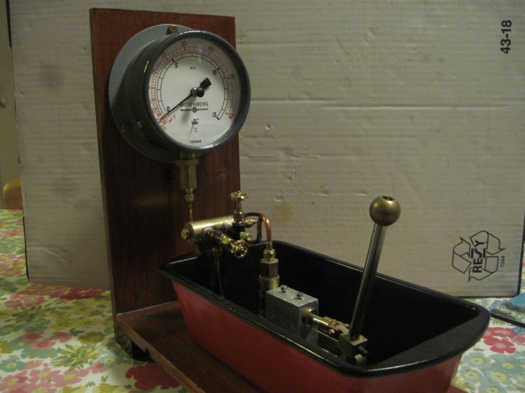

                        IanT
                          @iant
                          Well yes, it probably makes sense just to buy one – but it can be good fun to make things too …
                          Perhaps not the most elegant piece of engineering but then there are not too many others quite like it…… laugh
                          Regards,
                          IanT
