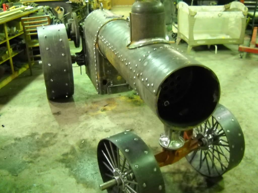

                            #50690
                              Kwil, judging by all those thickening plates there is certainly a lot going to be hung off that boiler.
                              Ian, I was planing to keep the smokebox door closed so no-one could count the tubes
                              And just for those that think a lapped and rivited boiler can’t be done here is a pic of a model being built at the moment.
                              Does help that it’s 6″ scale and being built in the US where it seems almost anything is allowed in some states regarding boiler construction. The rest of the build can be seen here for anyone interested, there is some very good fabrication work as its being done without castings, wish my welding was upto it.
