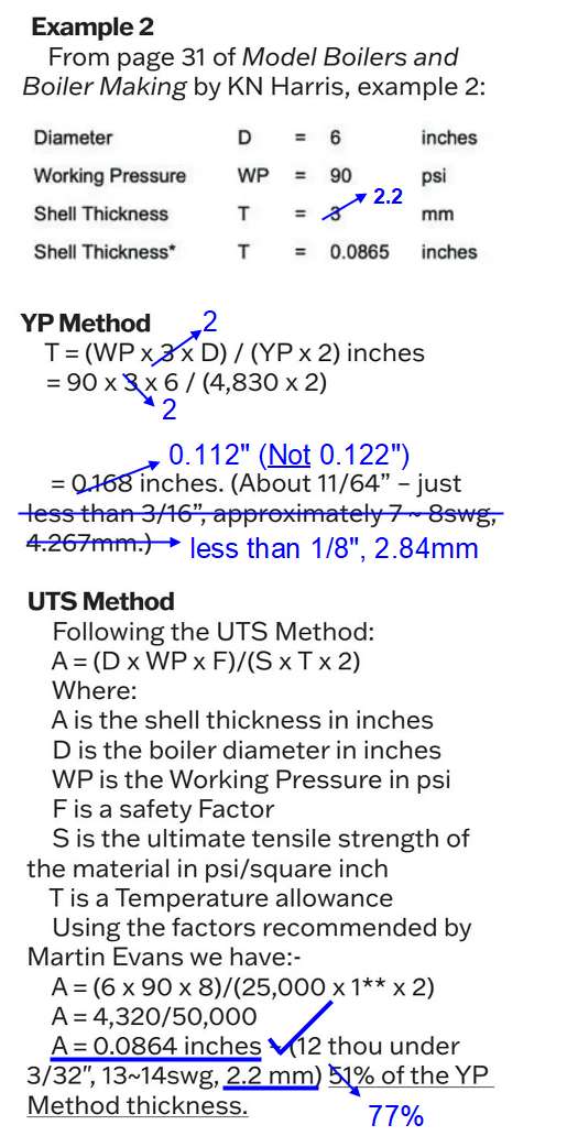

                        #800607
                        MEinThailand
                          @meinthailand
                          On JasonB Said:
                          boiler 3
                          Icon-Image-Email-20 Thank you JasonB for pointing out an error under Example 2, a boiler by KN Harris. The figure 3 in the YPM formula should indeed be 2.
                          This results in a calculated YPM thickness of 0.112″ (Not 0.122″ as you stated) resulting in the Harris thickness being 77% of YPM not 55% as in the Article.
                          I do apologise to MEW and our readers for my mistake.
                          Please note that this in no way detracts from the philosophy nor the conclusions of the article.
                          A revised section of the calculation referred to is shown below.
                          Response-001-250531-799596-JasonB

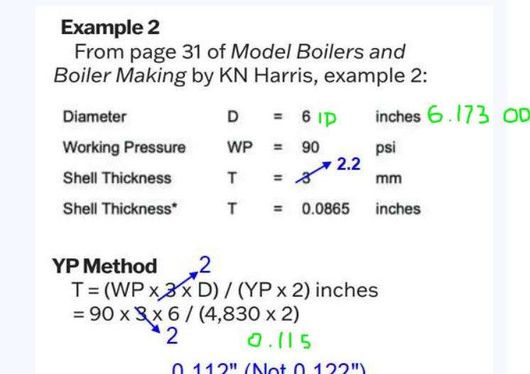

                            #800614
                              Thanks for that and also correcting my Typo, just looked at what I wrote when working it out and it was 0.112.
                              That was based on your 6″ but for the Harris example his 6″ is the Inside diameter in which case 6.173″ should have been used in the calculations, this gives 0.115″. However as this has a similar effect on both methods the percentages stay about the same. (Assuming Evans is using OD as I don’t have his book)
                              od
                              I’m sure those that have posted hera are keen to know why we have not seen boiler failures using the old methods and will therefore need convincing of the need to change the way things are done particularly as you say your results consistantly give a thicker boiler shell which will add to the already hight cost of a copper boiler and the resulting thicker barrel will have a knock on effect on room to get tubes in, reduced water space and reduced grate area. What are your thoughts on this and assuming the flat plates are also annealed what do you propose to calculate their thickness and subsequent stay spacing?

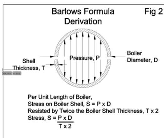

                              #800625
                              Charles Lamont
                                @charleslamont71117
                                Erm … The pressure is exerted on the inside of the boiler shell.
                                #800627
                                  Yea-But the failure will start on the outside skin, which is in tension
                                  [ just a thought from one uninitiated in the art, but observing from afar ]
                                  Please shoot me down if that’s nonsense.

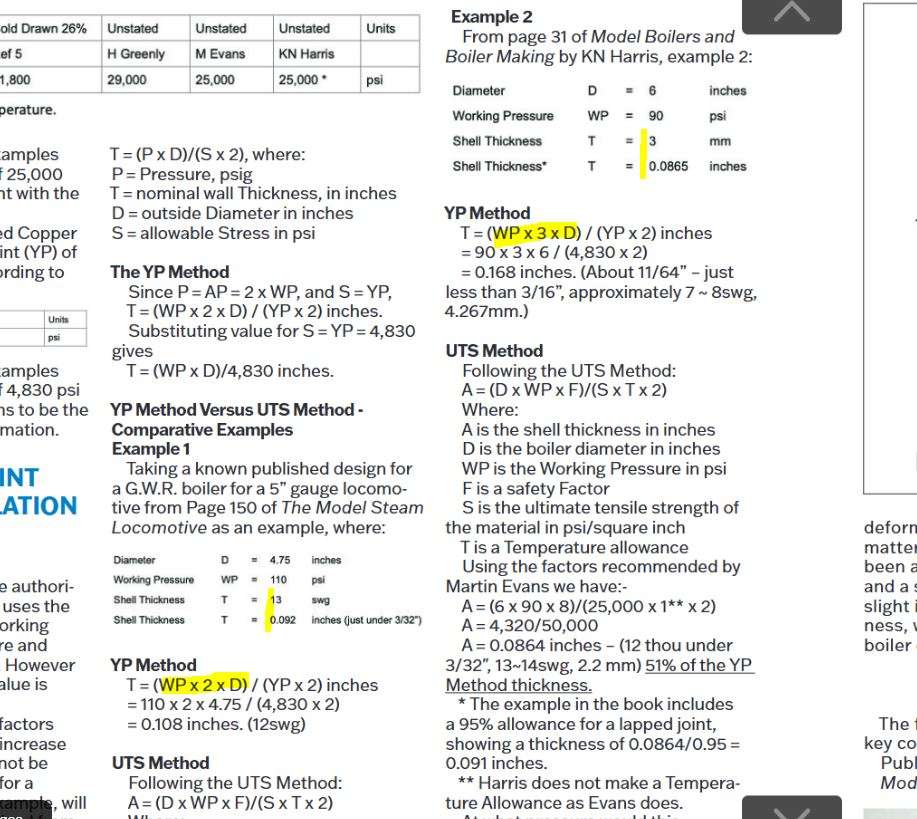

                                  #800631
                                    Charles, I was making the point that the suggested YP method as in the article used D as the OUTSIDE diameter so should have been altered for the calculation. If however the ID should have been used then that is not what is shown so could that be another error?
                                    outside
                                    #800639
                                      Online calculator also used OD of tube.
                                      Interesting if you put the OD of harris’s boiler in and fiddle with the thickness until you get 180 (2 x WP) the number that works is 2.35mm. Now to me that is not far off the 3/32″ that Harris says “will be perfectly satisfactory”  Though the online calculator does not allow for a butt strap.
                                      #800641
