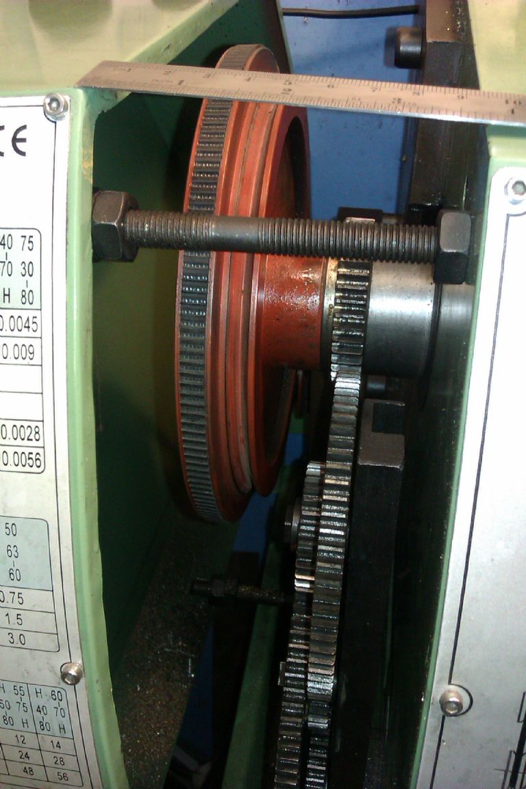

                                  Having spoken to Bill, I think his problem isn't working out the normal gear ratio, it's dealing with the extra 40T gear.
                                  Most lathes have a stud driven by a gear driven 1:1 from the spindle for the first gear in the train. This lathe has a 40T idler on a stud instead.
                                  My suggestion is to always start with a 40T gear as the driven gear in the first gear pair, but leave it out of the calculation.

                                    So, there is a permanent 40 tooth gear at the start of the chain as Bazyle says. How bizarre, that would seem to me to be extremely limiting. Being a Myford man that kind of limitation simply doesn't apply. Is that true for both imperial and metric versions of this lathe?
                                    ​I am beginning to regret my offer now !!
                                    What seemed at first to be relatively easy has become a minefield of confusion leaving me out of my depth working blind with important bits of the information concealed. Jason has to be right for the wheels listed, nothing else makes sense.
                                    I think the calculator sites can have it after all, they obviously know about these little pitfalls and have correction factors built in.
                                    Regards

                                      Golly, no wonder I'm confused. I've been making assumptions again. A picture of the gear chain would help.

                                          This is the same basic set up on my WM280, the 40T on the spindle is easy to see.
                                          Ant just to confuse you more there is a little lever or knob on the front of these machines which will give the lead screw or drive shaft a 2:1, 1:1 or 1:2 ratio so that same gear train will also cut 13tpi and 54tpi, you can just see in teh bottom left how each gear setup has three different tpi listed below
