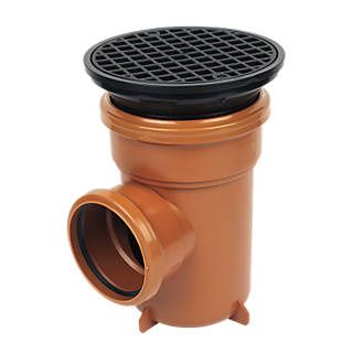

        I’ve just managed to unblock a drain outside our kitchen. It had quite a few stones and some lumps of solidified fat in it. The blockage seems to have been trapped between a black plastic funnel shaped sleeve and the drain itself. Anyone know the purpose of the sleeve? I need to modify the pipe that feeds the drain but until then it’s working nicely without the sleeve. I will refit it once I’ve done the pipe. Just wondered what’s it’s for as the drain flows quicker without it.
        The Sleeve.
        Drain.

          Hello Vic,
          I have the same fitting at my house. I think the sleeve forms the water trap to prevent foul smells to atmosphere.

            The sleeve dips into water and forms a seal – more compact than a 'U' bend and can be cleaned by removing the sleeve.

              Hmm that's an interesting one. Often you would have some kind of grease trap on a kitchen sink outlet like that. But I can't see how this unit would work as a grease trap, from the pics shown. Also, the kitchen drain pipe coming in the top would not be kosher.
              Is that round black top lid that covers the hole an open grating that lets rainwater from the yard drain down into the drain? It looks kind of like it but I cant see for sure. In that case, the funnel is probably to restrict the flow of rainwater coming in so it does not enter faster than the drain can take it away. Otherwise the rain water might back up the other drain pipes.
              I don't know about the plumbing rules where you live but most places you don't have kitchen grey water from the sink going into the rain/stormwater runoff system. Kitchen usually goes into the sewerage system along with toilet and shower water etc and rain stormwater runnoff goes into separate drains. So maybe something is not quite right there? Different places have different rules on that though, so maybe not.

                I think it is just the top part of this:-
                Push-Fit Single Socket Round Grid Bottle Gully 110mm. Any trap would come after the outlet.

                  I think it is one of these:-
                  A Push-Fit Single Socket Round Grid Bottle Gully 110mm. Manufacturers blurb says :- Bottle gully with circular lid. Designed to hold water to stop foul air escaping from the drainage system. Will accept waste water from kitchens, utility rooms and ground floor bathrooms, or rainwater from paved areas or roofs.

                      Re: above it is indeed a trap. A Push-Fit Single Socket Round Grid Bottle Gully 110mm. Manufacturers blurb says :- Bottle gully with circular lid. Designed to hold water to stop foul air escaping from the drainage system. Will accept waste water from kitchens, utility rooms and ground floor bathrooms, or rainwater from paved areas or roofs.

                        When removed should give access to rod the pipework if needed. Must remain in place to prevent foul air.

                              Ok, jobs done. The trap is back in place. I bought a screw connector and cut the pipe. I can now easily remove the grate and the trap. Hopefully though it won’t need doing again for another ten years!
