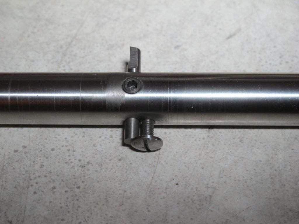

      I'm about to bore out a cyliinder using a between centres boring bar that uses a 3/16" circular bit. I've never been sure of the correct way of grinding these bits, can anyone offer me some advice please, preferebly with a sketch?

            Hi Brian
            Tool heel clearance is what gets most of us into trouble when it comes to grinding boring tools. Especially with smaller bores.
            If you have access to a decent CAD program I suggest that you do your own version of Jason's first sketch dimensioned appropriately for your job. Do it at a large scale so you can see exactly whats happening to clearances at the cutting edge and at the heel of the tool. Many folk suggest that the tool tip be set a touch above centre height to win a bit more clearance below the cutting edge. Something that a large scale drawing will help you assess.
            Boring tools in general and between centre bars in particular are somewhat less stiff than conventional lathe tooling. Of necessity the cutting edge has to divine its support at considerable distance so on our sizes of work deflection is pretty much a fact of life on all but the very smallest of cuts. Another reason why some folk advocate setting little above centre, the idea being that when deflection occurs the tool comes back to centre height. The smaller the job the harder it gets as slender tools are disproportionately less stiff than fatter ones. As ever no substitute for experience. But it really helps if you start off properly as per Jasons sketches.
            The detail geometry and tip radius of the cutting edge are essentially the same as that of a left hand lathe tool and need to be appropriate to the material being worked and finish required. Large tip radii tend to promote pushback and deflection so use the smallest radius you can commensurate with the desired finish.

              Do make a little holder, piece of bar, correct size holein the end and a grubscrew to nip it up. If you use square bar you get constant registration on the grinding rest. Much better than fingers or pliers.
              Ignore me if you are already there.

                I do appreciate that you already have a between centres boring bar and would therefore be loathe to make another – as was I. But having got into various difficulties, especially trying to measure the radius of cut and then precisely advance the tool, I put it aside. Then built the one designed by Geo Thomas and with the geometry of his boring tool. It was time well spent and probably saved scrapping a big cylinder block casting. The 'bar has been loaned out several times to others who've expressed….ahem….. complete satisfactionsmile p.

                  FF: The cylinder I am machining will end up with a 1.5" bore. My boring bar is 3/4" dia, the bit is at right angles to the bar so the bit will end up projecting by 3/8" and hence not very rigid. I will have to make a number of passes at the same setting to ger rid of the spring. With the bit at 45 degrees as in the Geo Thomas design the bit would be 41% longer and hence even less rigid..

                    Brian, likewise the bore of the cylinders I was machining had to be 1.5 ± 0.001" and my original b/bar was also 3/4" D. It just wasn't substantial enough, as you acknowledge "not very rigid". The early cuts were causing the bar to flex noticeably – particulalry when entering the bore and thus leading to a 'lip'. The Geo. Thomas one illustrated was 1.25"D and worked very well for those cuts to final, exact size. As he pointed out in his article, the other big advantage of the angled tool is the comparative ease with which you can measure the radius of cut c/f a radial tool where it protrudes below the bar. Perhaps a b/bar of just 50% of the required hole diameter will cause you problems irrespective of tool point geometry?

                      You are right, I should have a more subatantial boring bar but I thought that I would give this one a go before going to the trouble (and expense) of making a larger one that I would probably use only once. I actually don't have a great amount of metal to remove. Unusually the casting was not cored and most of the metal has been removed by successively larger drills and use of a boring head in the mill. Unfortunately the mill does not have sufficient headroom to bore it in one go so I had to attack it from both ends, with the inevitable result of a mismatch in the centre in spite of very careful setting up.. I'm just waiting for the delivery of a diamond wheel so that I can grind the bit to Jason's drawings and give it a go.

                        If you "don't have a great amount of metal to remove" is it worth considering a double-ended tool in your small diameter b/bar to reduce flexing? The tool would obviously have to be ground to o/a length of the precise final diameter.
                        I've not had to employ the method and can't now find the reference I once had. No doubt others can testify or otherwise as to its effectiveness.

                          Could You put another hole for the tool bit in another location to gain the range needed? It would be cut and try but it would match up.

                            Oh dear, I've just discovered that my boring bar is too short! I thought that it was a foot long but is actually only 11", which means that with a driving dog on one end it won't clear both ends of the 5¼ inch casting. DOH!!
                            I have just ordered a foot of 1¼ inch bar as per yours but will still have the bit (which can now be a more substantial 6mm dia) going straight across. The reason is that Jason's drawings are for that arrangement and I don't trust myself to shuffle things around by 45º and get it right. But still many thanks for taking an interest in my problem..

                                Brian, may I ask whether you've used a radial tool with a between centres b/bar previously? If you have then presumably you've encountereed the buggeration and calculations needed each time you want to determine how far to advance the tool and then check it's been moved precisely. Even with a tool not protruding from t'other end there's the added difficulty of the open end and how that might affect a micrometer or vernier reading. OK, you could make a smooth surfaced plug but that'd have to be removed and replaced for every measurement. Life is so very much easier with an angle tool as per Geo Thomas and other's designs. However I can appreciate the attractions of just making a radial hole for the tool.

                                  See the photo. The 40tpi screw advances the bit by 25 thou per revolution so judging one thou is not too difficult. I'm not too bothered about the odd thou or three, I shall just make the piston and cylinder head spigot to match.boring bar.jpg

                                    Never found the straight across bar to be a problem myself. Just measure the bore to see how undersize it is and you know the tool needs to be advanced half that amount where ever you measure it from within reason.
                                    You can always tap the opposite end of the cross hole to take say a 40tpi or 0.5mm pitch screw and know that x amount of rotation of the screw will move the tool Y amount.

                                      I should first confess to a late-in-life realisation that Geo.Thomas’ rather pedantic articles on model engineering were actually sound and not as doctrinaire as I had naively thought. It was whilst observing the flexing of my home-made b/bar when machining GM twin cylinders that I looked up his writing on the subject. In terms of the normal, radial b/bar he wrote “..my design attempts to provide a suitable means of advancing the cutter ended in severe weakening of the bar at the point of maximum bending-moment”. I thought that might be the explanation for my non-parallel bores and with only about 10 thou left to machine, I made his angled tool design from a wider silver steel bar which he claimed would not only flex less but also make using a micrometer for measuring tool point radius much easier. It certainly wasn't a five minute job !
                                      I don’t decry the use of 90 deg radial tool b/bars; but merely offer that GT’s design did work much better in my particular case and has produced perfectly parallel bores without a problem many times since.

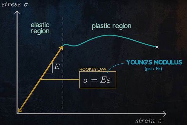

                                          Contrary to widely held belief, silver steel is not stiffer than mild. Young modulus is a matter of chemistry, and both are very largely iron

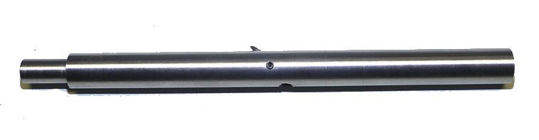

                                            Having made but yet to use a Hemingway Kits between-centres boring-bar set this thread is of particular interest to me.
                                            These bars have radial cutters set using a simple micrometer which also forms part of the kit. The instructions tell you to mark the head of the micrometer screw but since the graduations have no fixed reference-point with which to align, I am not sure how helpful that is.
                                            To answer Fowler's Fury point about a "smooth plug", I assume as plug-gauge.
                                            I'd pondered that and suggest not a solid plug but a ring-gauge, bored out to an easy fit on the bar. Hold this at one end of the bar using a rubber band, close-fitting O-ring or something of the sort, while actually cutting metal.

                                                Here are some minutiae, which to a very reasonable approximation support Duncan’s assertion:
                                                **LINK**
                                                https://amesweb.info/Materials/Youngs-Modulus-of-Steel.aspx

                                                  So, why is it harder to bend a high tensile bolt than a cheap hardware store grade 2 bolt if the Young's modulus for alloy steels is the same, virtually, as mild steel such as 1020?

                                                    Posted by Hopper on 23/05/2022 04:38:03:
                                                    Because ‘reasonable approximation’ and ‘the same, virtually’ are just ‘working assumptions’
                                                    Reality is much more complicated.
                                                    Note the punch-line on that page that I linked:
                                                    ”For all practical purposes, modulus of elasticity of all tool steels in all conditions is about …”
                                                    … some carefully chosen words there ^^^

                                                      PostScript :
                                                      This calculator page goes some way towards answering Hopper’s question:
                                                      **LINK**
                                                      https://eurocodeapplied.com/design/en1993/bolt-design-properties
                                                      Note the introduction of two new terms
                                                      Yield strength
                                                      Ultimate tensile strength
                                                      … both of which differ between various classes of bolt.
                                                      … and in case it’s not obvious: What the ‘high tensile’ materials do is shift the Elastic|Plastic transition … thus increasing the width of the Elastic region on this graphic.
