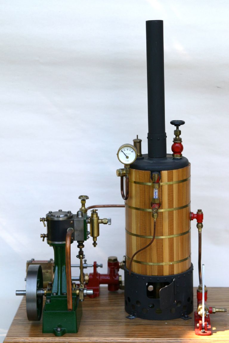

      Paul Lousick
        @paullousick59116
        John P.
        Where did you get castings and drawings for the steam pump behind the engine in your photo ?
        Paul
        #606711
        John Purdy
          @johnpurdy78347
          Paul
          It's a Stuart Turner model, #34-50-72475 on their current web site. I acquired the casting set back in the mid '90s along with a number of other unfinished ST models from a fellow down the road. Finally got to build it about 10 years ago. Haven't run it on steam yet but it tics over (?) nicely on a few PSI of air. I keep meaning to tee it onto the steam line from the boiler but haven't got around to it, got as far as making the displacement lubricator for it. The most difficult part of building it is the valves and valve chambers which require some very accurate positioning and machining if it's going to work.

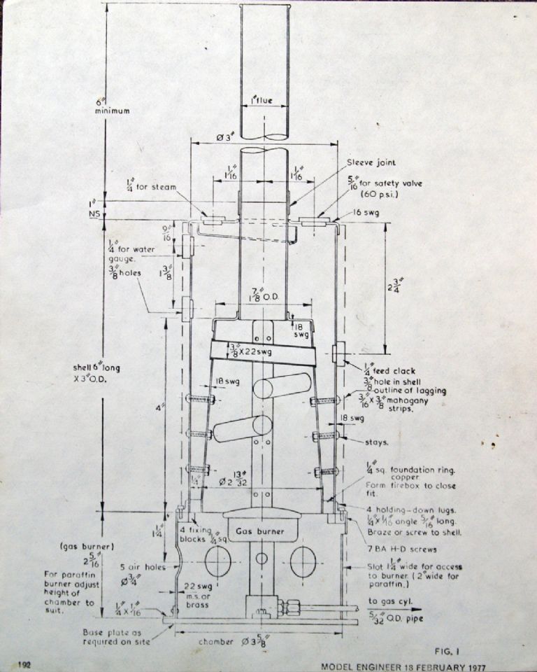

            michael sutton
              @michaelsutton34078
              John, thanks for that. the links still not working for me but I found them in your albums.
              A little too complicated for our needs yet, my 12 year old grandson is building an S50 and boiler as a first project. I have no experience with steam at all so we are both on a steep learning curve. I drew up a basic boiler but didn't realise that it needs to be matched to the steam requirements of the engine, along with safety issues but we're getting there
              The machining of the parts isn't a problem, I have a pretty well equiped workshop and welding bay, the research is taking the time.
              Best regards Mick
