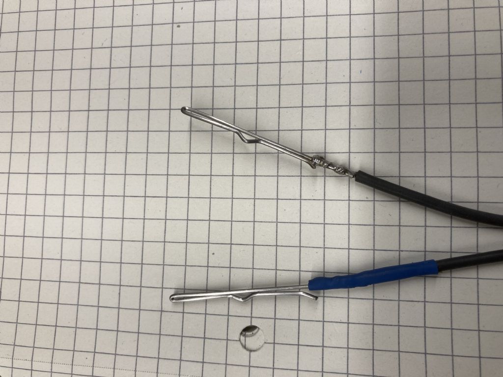

              I have just bent these clips from 0.8mm piano wire. It is good quality wire that I buy in coils for making tether car cables.
              It bends no problem at all with no failures. The squares on the paper are 5mm.
