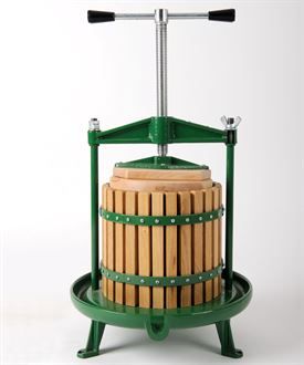

      Rather than trying to trying to frame my question in abstract terms, I'll give you the case in point.
      I've got involved with making stuff for a charity. On of the projects involves modifying a fruit press:
      The latest requirement is to lengthen the arms to get more torque and hence more pressure on the 'fruitcake' to squeeze the maximum amount of juice out.
      OK, slip some pipe over the handles. Eventually though the 'arms' will bend, assuming nothing else gives way first.

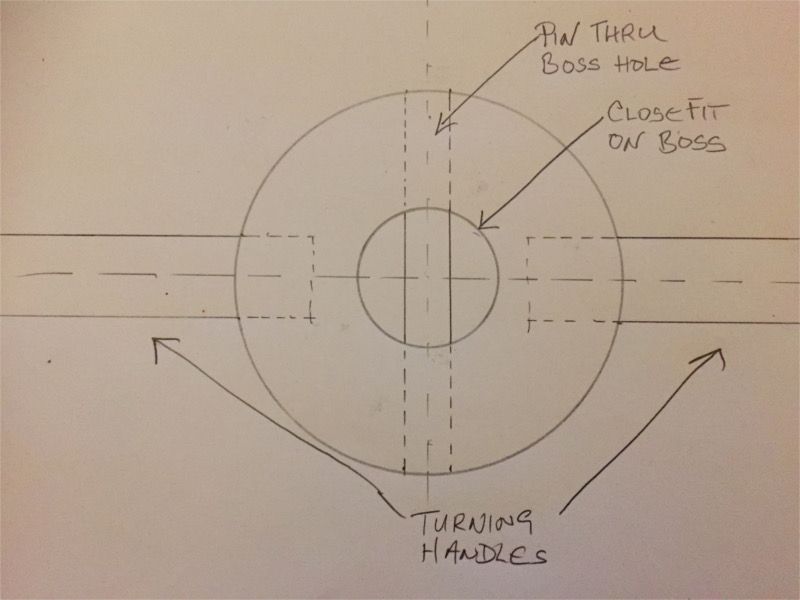

      So to arrive at my question. If I made something like this:
      would it be stronger than the simple 'bar through a hole in the boss on the screw'? I have a gut feeling that it would be because if the parts fit closely, the pin experiences shear rather than bending force. Gut one in my ruminations tells me that it's harder to shear steel than to bend it, but gut two says I'm getting something for nothing* so than can't be right and I'm not thinking about this in the right way.
      Apologies for my roundabout approach to the question – if I had to vocabulary to express it more succinctly I'd probably know the answer.

                              Thanks for replies. Interesting as always, but no one has addressed my question directly – quite possibly because it was a daft one.
                              I'll try to express my confusion in another way. Scenario A. You have an infinitely hard and rigid boss cross drilled to diameter D. You bung a bar through the hole – the bar is idealised only to the extent that it also has diameter D, so a perfect fit. Otherwise normal metal. You put torsional forces on the bar and eventually it fails in the sense that it it becomes permanently deformed into some sort of S shape.
                              Scenario B. You make something like the sketch in my original post. Everything fits perfectly, and the only thing that can fail is the pin which also has diameter D. The pin is subjected to pure shear force in this scenario. I think! In this case 'failure' is any sort of plastic deformation of the pin.
                              Is there anything to choose between the two scenarios? I now think not, but still not sure!

                                Posted by Robin Graham on 08/03/2020 00:58:44:
                                So far, so hypothetically good, Robin … except to note that that if ‘everything fits perfectly’ then the load on the pin is indistinguishable from the general internal loads … The nearest practical implementation probably being to secure all those elements with something like Loctite 638 retainer.
                                If, however, your boss is actually a ’bearing fit’ on the shaft … yes, your pin will be in double shear.
                                Given suitable choice of size and material for the pin: It is likely that either of these is simply transfer the problem area up to your new handle-fixings [which is where I came in], or [as Jason wisely noted] to the support structure.

                                          Perko7 – you have correctly understood my question. There was an implicit assumption that the new 'handles' would be more rigid than the originals in my framing of the question, but perhaps I should have been explicit. Thank you for your answer.
                                          MichaelG – I think you said the same thing , but I didn't understand what you meant by 'bearing fit'. Presumably the same thing as Perko7's 'press fit'? Thanks for your response.

                                            Posted by Robin Graham on 09/03/2020 23:11:14:
                                            Not quite, Robin … ‘bearing fit’ [relating to the fit of your new boss onto the feed-screw] was meant to describe something which slides together, as distinct interim between ‘loose’ and ‘press fit’ [i.e. the fit you would expect to find in a plain bearing] : This is the circumstance in which the pin could most reasonably be considered as being loaded exclusively in shear.
                                            … It matters not.
                                            Edit: for clarity … your sketch uses the term ‘close fit’

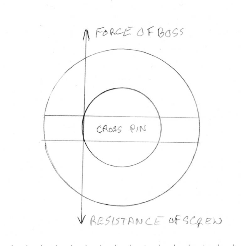

                                              Hi Robin, shear stress, or shear strain is when something has two opposite and parallel sliding forces acting upon an item, like a pair of scissors or a guillotine. Your pin will have shear stress on it, but your handles won't.
                                              The double shear mentioned, will be the same forces on the other side, but in the opposite direction. Your pin will only have bending forces on it if it is a loose or sloppy fit, but they will be small and limited by the clearance in the holes.

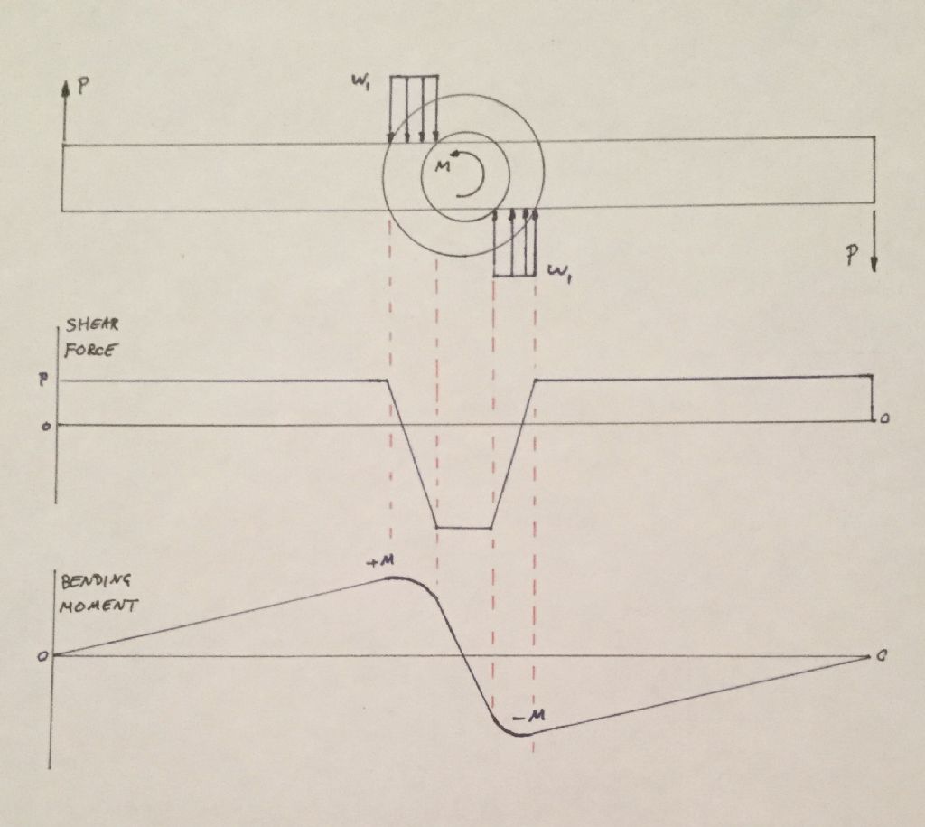

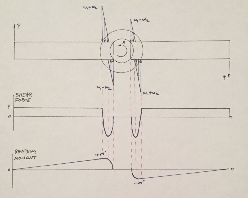

                                                    There does appear to be some confusion about shear forces and bending moments… To clarify my earlier post, I have drawn up a pair of sketches of a bar passing through the centre boss and a similar arrangement with two stub pins. They show the shear force and bending moment diagrams for the bar and for the pins. As I said before, the peak bending moment in the through bar is very nearly the same as that for the pins (for the same force, P).
                                                    The real difference is in the pressure applied to the boss. For the through bar, this is roughly uniform at a level of, say, w1. For the pins, however, the moment is transferred by very high pressures between the pin and boss. The triangular pressure distribution required to react the moment at the end of the pin gives a peak pressure (w1 + w2) of about 6 times higher than w1. This commonly leads to a bearing failure in the boss.
                                                    There is the alternative load path for the pin-in-socket, as shown by Micheal G. I think that I have only had to use a "Desperate Dan" analysis like that once in over thirty years of doing stress analysis of aerospace structures! The pin-in-socket, below, is the standard method.

                                                      Posted by DrDave on 10/03/2020 21:48:05:
                                                      Sorry, Dave … I’m a little bewildered now
                                                      Aside from one hyperlink, the only thing that I have ‘shown’ is Robin’s original sketch.
                                                      The rest of my input has been ‘thought experiment’ verbiage.
