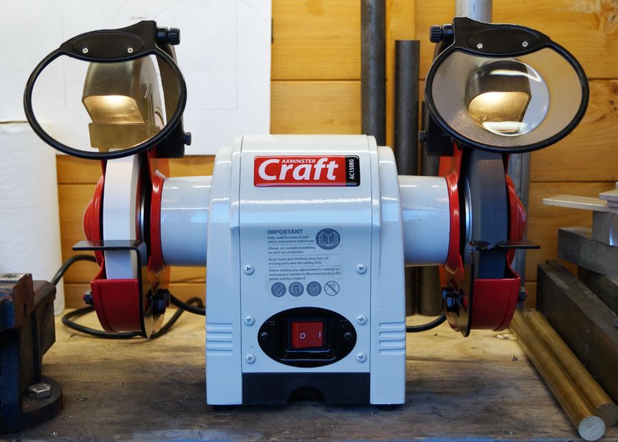

            The grinder arrived and first impressions are good, it certainly looks to be decent build quality. I only have the old ebay cheapie to compare it with and that would make anything look good.
            It has the usual sheet metal tool rests they are a decent gauge and have 2 bolt fixings but a bit limited in their range of adjustment. In the future I will probably make some better fully adjustable ones more suited to tool shaping/sharpening which is what this grinder will be mainly used for.
            Where the eye shields fix to the mounting arms looks weak, as Mark suggested I can see those easily broken. I am impressed with the right hand magnifier though its quite powerful and could be quite useful. The built in lights..? well they do add a bit more to the work area.
            I ran the grinder for 20 minutes and it was barely luke warm so pleased with that, I couldnt touch the old one after 10 minutes. I am awaiting for a diamond dresser but the supplied wheels are very good, quite true. I have replaced one of the wheels though with a green wheel for carbide.
            The rating is 250 watts and I suspect that is a good 250 watts as I went in quite hard shaping a piece of 8mm tool steel and it made no attempt to slow and stall.
            So overall I am pleased with it and I think good value for money and I guess thats what counts.

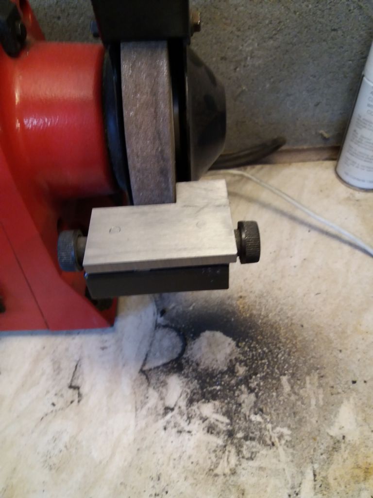

              Those tool rests look very flimsy to me I bought a Crusen and they are more stable but I still had to reinforce them.20171103_101306.jpg

                The tool rests seem to be typical of most grinders in this price range and as I said I will improve on them in the future. However they are not "very" flimsy they are quite adequate for the type of tooling work it will be used for, I wont be putting large lumps of steel to the grinder its use will be quite light duty.

                  Another hint about a motor's service rating is its power to weight ratio; heavier is better. I see the Seeley claims 450W on a weight of 11.5kg, whereas Ron's Axminster claims 250W on 17.5kg. (Don't take this too seriously when the motor is an old one – they're always heavier than new motors because the heat resistance of the insulation available was inferior to modern materials.)
