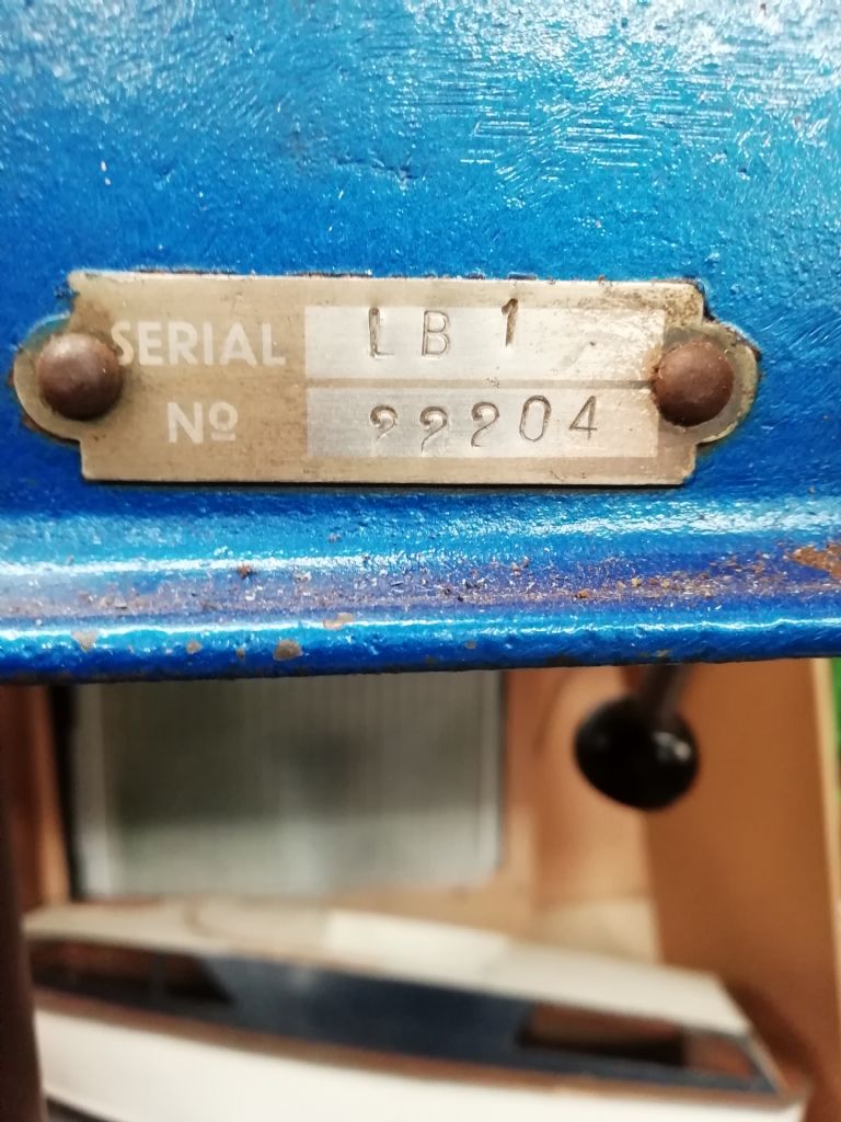

        This is the only id plate on it:

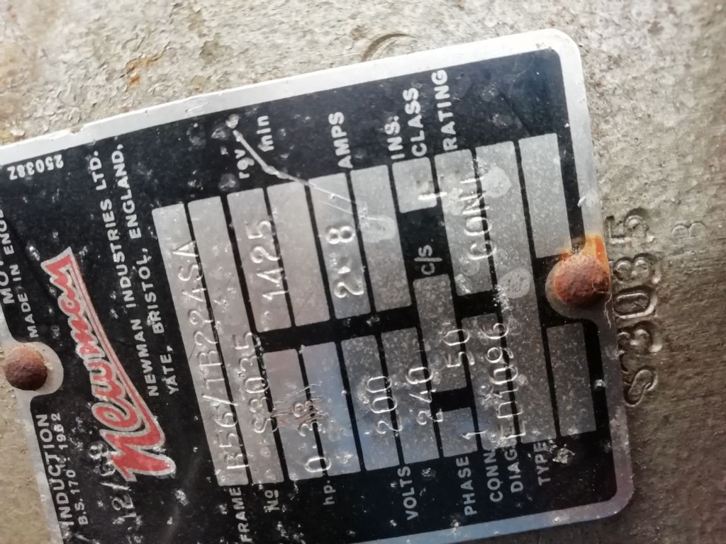

        and this is the motor plate:
        I don't know if this is the original motor or a replacement?
        My reason for asking is that I want to replace the chuck but don't know if it is in a taper or threaded!

        #508694
          Can I chose between a Coconut and a Goldfish for my prize ?
          **LINK**
          http://www.lathes.co.uk/meddings-pacera/

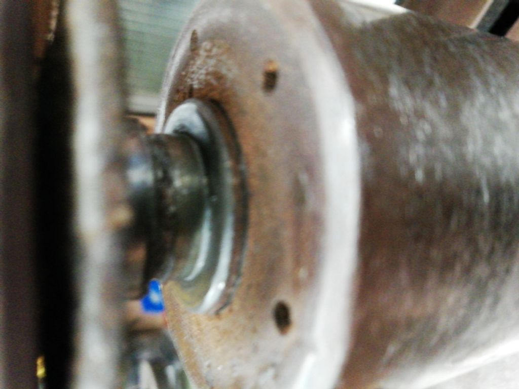

                        Posted by KWIL on 20/11/2020 16:19:34:
                        Close up photo of the chuck/spindle area would assist. It appears to be a taper fit so the opposed wedges type of remover would work OK.
                        Edited By KWIL on 20/11/2020 16:19:59
                        As requested:
                        I can get better pics of the inside tomorrow if they help.

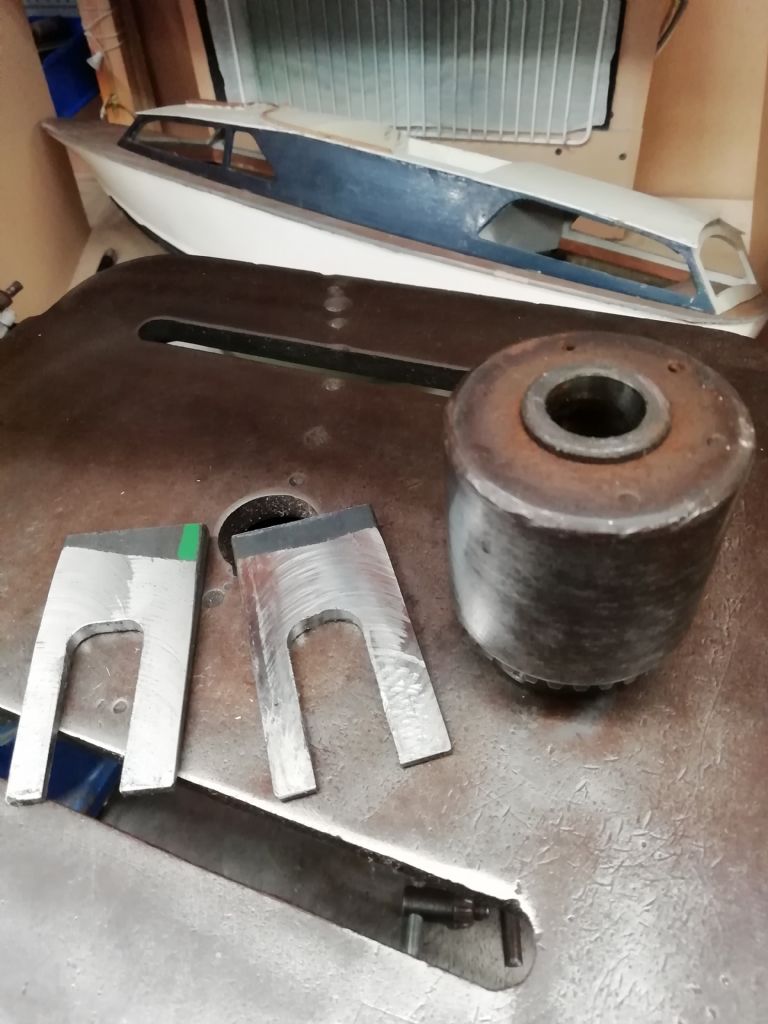

                          Looks to me like a male taper at the end of the spindle, a pair of chuck wedges would establish the truth.

                              Definitely looks like a taper; to hazard a guess I'd say Jacobs No 6 but might be better to wait and see if Meddings respond.
                              It looks to be a very useful drill though.

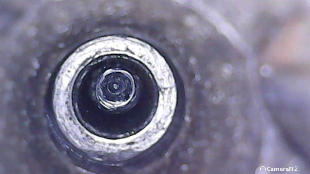

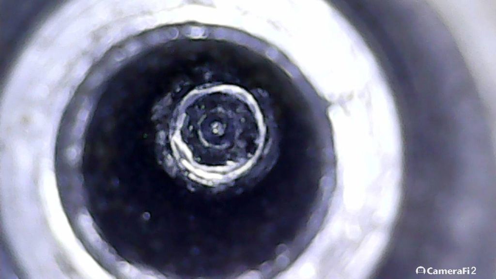

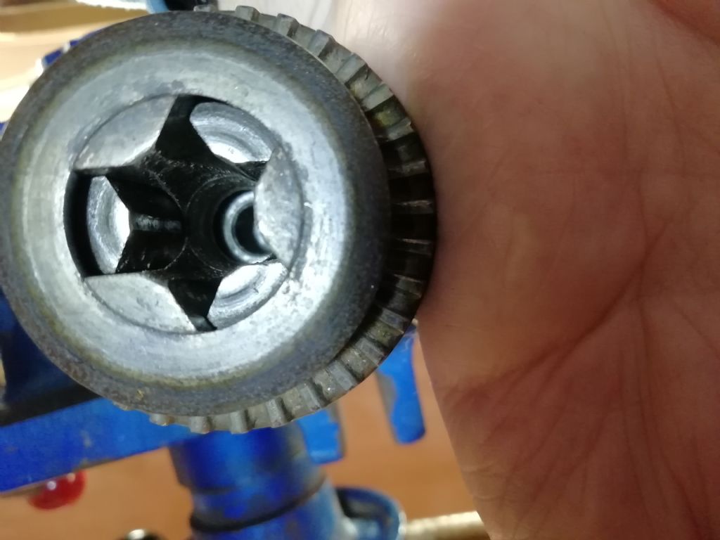

                                        As promised here is a couple of photos from inside the chuck. Do they help with identifying if it's a taper or a screwed chuck?

                                          This looks to me to something of a red herring !
                                          #509018
                                          DiogenesII
                                            @diogenesii
                                            Is that hole threaded? ..it looks exactly what I'd expect if some former owner has used it to jack the chuck off it's taper before.. ..the 'witness' further in looks as if the end of a bolt has borne on the end of the taper within.
                                            Pretty sure that the other Meddings "lightweight" offering, the Driltru, has a male Jacobs Taper on the end of the spindle. Certain that the smaller Pollards do.
                                            I'd always thought that screwed chucks only really became widespread on pistol drills?

                                              Woohoo! success laugh
                                              I made a couple of wedges after seeing the price of commercial items and orft it jolly well popped. smiley

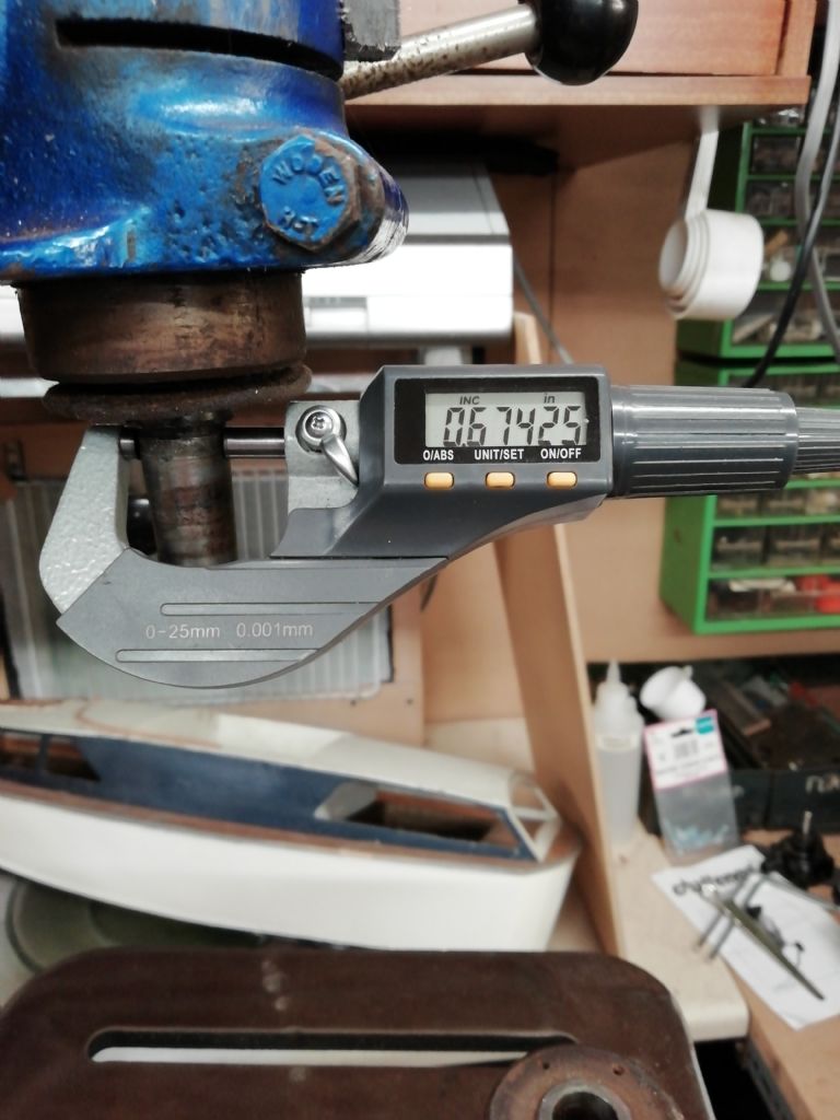

                                              The top taper measured approx:

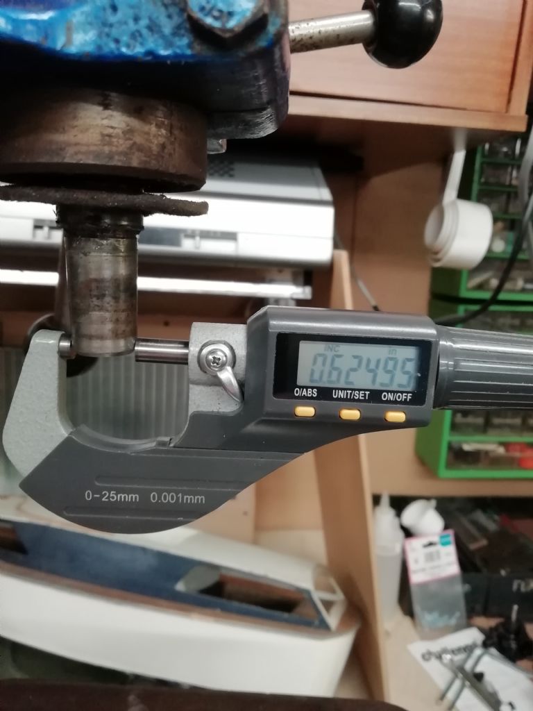

                                              and the bottom:
                                              So it seems to be in the realms of a J6 taper.
                                              Now to give myself a heart attack and see how much a half inch keyless chuck is going to cost Santa! devil
                                              Thanks for all your help and advice, much appreciated.
