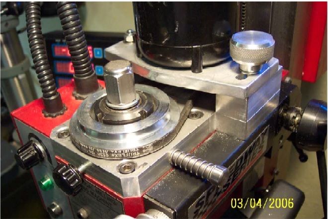

          A Google search for your mill threw up several pictures of a mill that I recognised as a clone of one I once owned. This is going to test my memory somewhat. Way back in late 2012, I had an Amadeal XJ-12 Mill that suffered from noisy and exploding nylon gears. Internet searches lead me to The Little Machine Shop in the USA, from where I ordered their belt drive conversion kit. In my haste, I failed to read the warning regarding the bore size of the spindle pulley. Of course, mine was 28mm and the supplied pulley was 30mmØ. No matter, I thought, I'll make one on the lathe. I did and it fitted. The hole spacing for the mounting plate were at a slightly different pitch on my mill as well. It was turning out to be an expensive purchase, with few parts that were a direct fit Undeterred, I went ahead with the mods and ended up with a working example. The only surviving photo is this one:
          Belt-drive conversion
          I also stripped the gear head and removed the stock two-speed gears and shaft, further reducing the noise. This involves the removal of the head from the mill – awkward but not difficult.
          I have a pdf file of a scratch built conversion with full drawings (in Imperial units) and a couple more photos of it which I'll email to you if you would like it. Just PM me with your email address.
          Just had a look in the workshop and I still have the original unused spindle pulley with 30mm diameter through hole and its associated belt. You are welcome to these, if it will help your project along.

                  Looking at Johns photo the design looks seriously over chunky. There would seem to be considerable scope for dropping the motor lower if a flanged weldment with thinner base were used to hold the motor. I've made that sort of thing work in the past when my welding skills and equipment were much more rudimentary than they are now so it's not stupidly difficult. No working milling machine then either.

                    Looking at Johns (sic) photo the design looks seriously over chunky. There would seem to be considerable scope for dropping the motor lower if a flanged weldment with thinner base were used to hold the motor. I've made that sort of thing work in the past when my welding skills and equipment were much more rudimentary than they are now so it's not stupidly difficult. No working milling machine then either.
                    Clive
                    Clive,
                    Your perception of the chunkiness of the plates might be skewed by the scale. If I remember correctly (always a rash assumption) the base plate was 12mm thick and the motor mount 10mm. As they came from the USA, more likely Imperial equivalents. As an aside, the plates in the pdf to which I referred (also of USA origin) were 5/8ths and 3/8ths respectively. This is the photo of that installation lifted from the pdf.
                    belt drive 2006
                    Sizes are selected to facilitate the alignment of the belt, I suspect. Chunky or not, it worked OK. And I'm quite a fan of "chunky" over "wobbly"!
