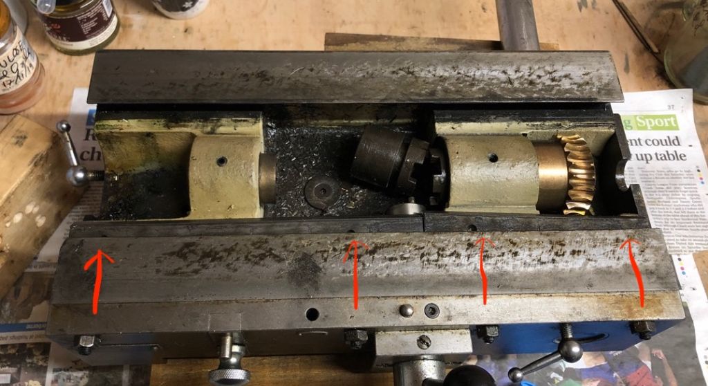

      After a while spent cleaning and re-oiling my Senior M1 mill, I was hoping for guidance on how to correctly setup the 3 axes' gibs.
      Here are my thoughts so far. Please bear in mind I am *not* an engineer, so please make it idiot proof.
      • Ive read posts that say one need to account for unequal wear on any s/h machine (most in the middle portion vs ends of travel). Not sure How I account for that in practical terms.
      • The x-axis (table) has two gibs (~2:1 length ratio). Seems unusual yet obviously an engineering reason.
      • Does the z-axis (column) need a different approach, due the large weight it carries, plus being a vertical surface fighting against gravity
      • To do this set up properly, will I need expensive clocks/gauges whatever, or can it all be done by feel?

                  The Tom Senior light vertical has only one X axis taper gib, I cannot figure out how two would work on an M1.
                  The Y axis has a strange one piece gib which is held in two planes. I think it is a bit of trial and error to get it right by slackening the plain bolts a little and then adjusting the screws and nuts. The plain bolts have to be tightened and then the movement is checked. It needs to be just a tiny bit tight, but movable over the full range with only slight extra tightening at the ends of the travel.
                  The knee gib is similar to the Y axis in design. Practice with getting the Y axis adjusted first. The knee is likely to get tighter near the bottom of its travel.

                    I don't understand your remark 'The x-axis (table) has two gibs (~2:1 length ratio)'. Please could you explain? Never seen that…or am I being thick?
                    Yeah wasn't very clear was I! Photo below should explain all. I meant why is there not a one gib covering the entire dovetail. Perhaps it affords more control to central wear, having 2 gibs?

                      Your M1 with the power X feed has a very different setup to the light vertical. Your gibs are conventional screw and locknut adjusted type, the lv uses a sliding tapered gib. Have you taken the gibs out? There is a possibility that it started life as one piece and broke, it should be easy to check.

                        I have a Light vertical and an M1 both gibs are identical, Not sure about the age of the M1 photoed above but it's not the same as mine. Both of my machines have the long X axis gib which is adjusted with two large headed screws which work from both ends of the table and lock the gib into position.

                            Strange. I've never seen a gib strip in two pieces, like the pic. The manual for an earlier version of the M1 identifies only a single gib strip for the table. Sometimes one gets the impression that no two Senior machines are the same, however I think yours is probably non-original, or has been broken (and then fettled?).
                            I don't see why a two-piece gib strip shouldn't work OK in this application. If you think about it, gib strips are not very stiff, so the bit between where the screws bear really isn't doing much. This is in contrast to tapered gibs, in which there is well-fitted contact on both of its surfaces – and they're easier to adjust too. Altogether preferable.
                            I suggest you get the machine up and running, and then you can have the satisfaction of making a new gib strip…
                            Gib strips need to be restrained from moving lengthways. IIRC, and as the pic suggests, each of the Senior's screws locates in a pocket in the strip. However, if there were only one pocket doing the restraining (and the other screws have, for example, a ball end which bears on the strip's surface), the non-pocketed bit of your two-part strip could move.
