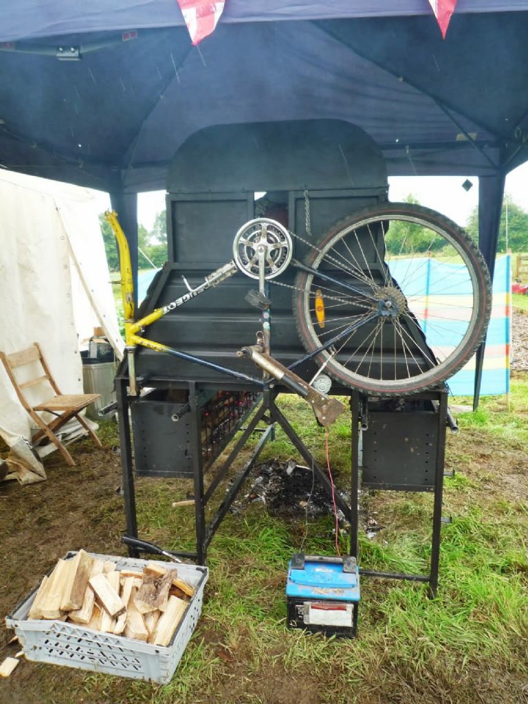

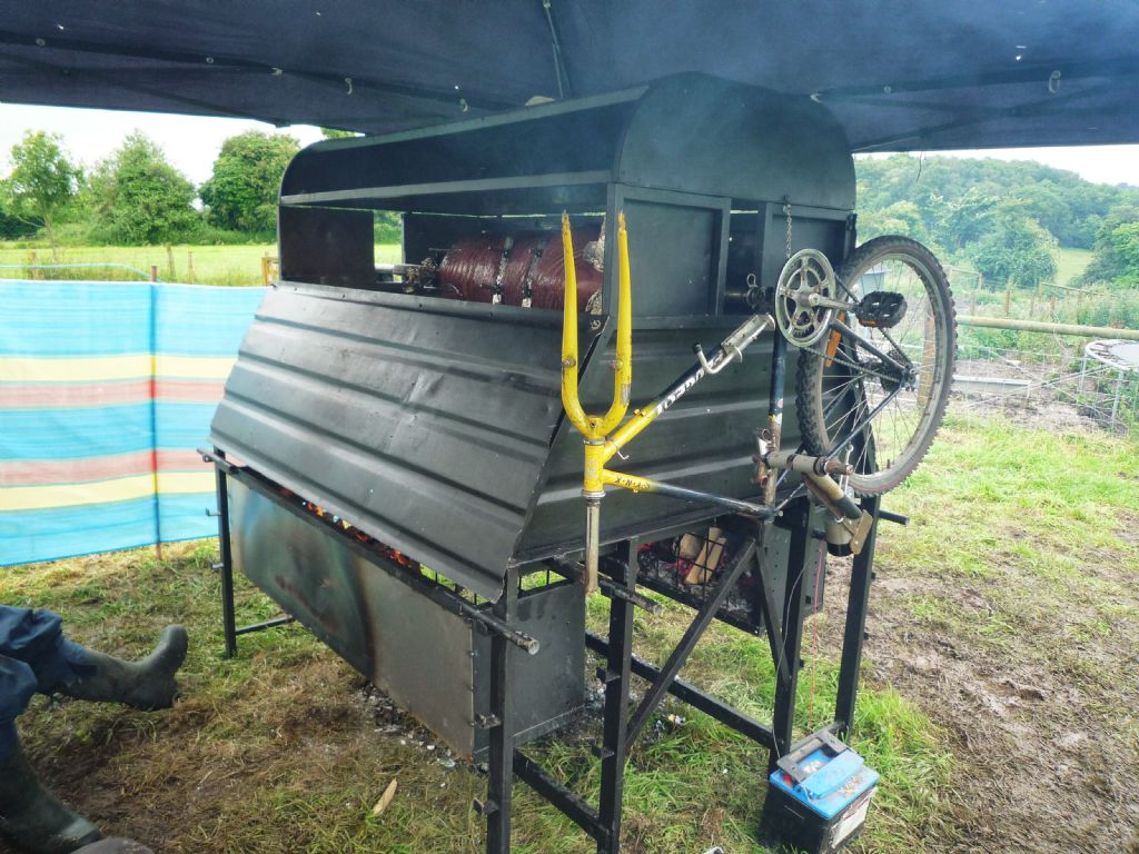

                                    p1000172.jpgPosted by not done it yet on 01/06/2022 09:43:49:
                                    Do you have a suitable motor for this project? 10HP would easily cope. Possibly just a little smaller?
                                    Motor speed might be important? 2 or 4 pole motor? Two pole at 2800rpm might be the best?
                                    Three phase with VFD or a brushless DC might be best for wide speed variation choices?
                                    Add to this lot the huge fan required, to supply the combustion air, and you are nearly home. Automatic. ash pan, grate clearing, etc might be a high priority?
                                    Might also need a chain saw to cut down the oak trees for the smoking chips. Saw can be electric, of course – better for the environment than using fossil fuels.
                                    I think bearings are likely fairly low on your list of priorities.🙂
                                    Yep the things you mention I already have got covered off from when I built my hog roast machine. I'm really interested in improving the bearing set up hence my question but thanks for your inputsmiley
