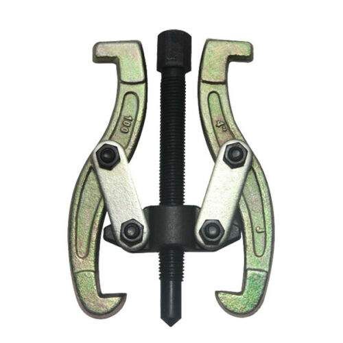

      I need an external bearing puller for a 52x25x15mm wide bearing. Whilst it may never be used again I don't want to order something that simply doesn't work and a lot of the Amazon reviews of cheaper pullers are very uncomplementary. I'm in Italy and will have to order online or pay a fortune, there simply isn't a market here for this kind of item to hobbyists. Many companies have quite high minimum charge for orders. What should I look for? I presume 3 arms are better than 2?

          #530829
          Paul Lousick
            @paullousick59116
            I only have an inexpensive gear puller which has served me well for 20 years. (this one advertised on ebay for $12.50) Also available from hardware stores and car accessory stores. (there must be similar stores in Italy where you can check the quality before buying)

              Sykes Pickavant are probably one of the best names in pulling equipment but prices are high. The bearing described is unlikely to present much of a challenge even to a cheapish puller. My personal preference is for a 3 legged puller but check the access for the legs of the puller, some have quite chunky ends and space can be tight, I have had to modify the ends to get into position on occasion. My apprentice made puller has served me well for nearly 50 years and it is made from mild steel.

                  Hi, I have one similar to this Gear Puller which works OK on most bearings.
                  Although this one is more like mine Hydraulic Puller
                  Regards Nick.

                          Agree with NDIY that for a one time job making rather than buying is a good option.
                          I'd take inspiration from something like this :- **LINK**
                          Many, many years ago I made one with simple arms fixed to the cross bar at the right distance apart dropping down to hook over the bearing with something spectacularly crude to stop them springing apart. Usual thing. Sunday morning, had to be done for Monday and the only puller much younger Clive had to hand wasn't quite wide enough!
                          Although I have one of the multi arm 2 & 3 legged spider sets like Nicks' link and Pauls' picture, expensive Pickavant too, I'm no great fan. All too often the leg ends are too cumbersome, the angle of dangle is unfortunate, assembly takes longer than I'd like (especially if I get one leg wrong way round!) and the thing flops about in 86 different directions simultaneously when trying to fit it.
                          Much prefer legs solidly fixed to the cross bar.
                          If you do make one use a fine thread on the bolt.
