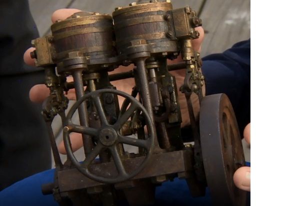

        On BBC Flogit ( repeat ?) there was an antique mechanical item described as an air compressor or was it really a compound steam engine? It looked like it had a reversing arm, and the "Drive Pulley" looked large enough to be a flywheel.
        If it was a stem engine, it fooled the expert, the auction house and the BBC – What did the team think?
        #470976
        Bazyle
          @bazyle
          Series 17 episode 13 30minutes in.
          yes this was a twin cylinder steam engine with slide valve reversing gear, perhaps made by an engineroom fitter in the style of engines he was familiar with but the valve chests are rather short and the reversing gear control wheel way out of scale so perhaps something he found.
          Value way out too. Pity that a decent modeller didn't find it at the boot sale.

                  Two cylinders the same size, not compounded, where reversing is a major function. Mill engines and pumping engines only run one way. Although ship engines reverse they need to be energy efficient, hence small HP and big LP cylinders, which this model doesn't have.
                  My guess it's a model rolling mill engine, the sort where hot metal is passed to and fro through a pair of rollers to make sheet, strip, angle girders and rails. Rolling engines need to be powerful rather than efficient, and the operator continually starts, stops and reverses them, which might explain the giant control wheel.
