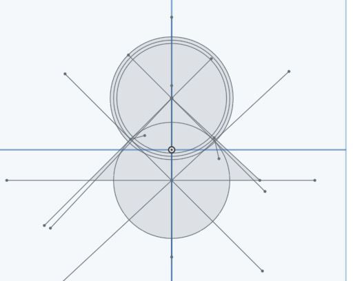

                        Escapement Teeth Spanned
                        I designed the pallets and escape wheel using the method shown below, which I found in a various forms in different places. The two short lines near the horizontal line and either side of it are the start of the pallets. Why is it better to span more teeth than this?

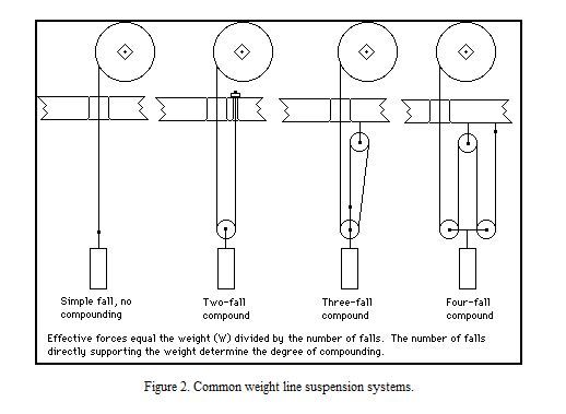

                                          #235954
                                          James A
                                            @jamesalford67616
                                            I have modified my gear train in light of the suggestions made and am now trying to work out how long the clock is likely to run for as it stands. Assuming a drop of four feet, I come up with a running time of about three days.
                                            I have been thinking about how to increase this duration and have come up with:
                                            Raise the clock to increase the drop
                                            Possible, but not going to make a huge difference.
                                            Increase tooth count on the driving wheel
                                            Difficult due to size restrictions of my lathe. The maximum comfortable diameter is four inches.
                                            Reduce tooth count on the driven pinion
                                            Possible, although I am trying to avoid really small pinions due to their fiddly nature. I have looked for the ready cut lengths that someone previously mentioned, but cannot find any.
                                            Introduce another gear into the motion between the driving gear and the next wheel
                                            This seems to be the most feasible option.
                                            Some sort of rewinder
                                            Not sure,
                                            Have I missed an obvious method? I have looked at ways of looping the rope or chain over other pulleys, but I still come back to the limitation of the drop.
                                            I should appreciate any suggestions.
                                            Thank you.
                                            James.
                                            #235959
                                            Russell Eberhardt
                                              @russelleberhardt48058
                                              1. Suspend the driving weight from a pulley and fix the cord at the top, loop it round the pulley and back up to the barrel.
                                              2. Reduce the diameter of the barrell.
                                              3. Mount the clock higher.
                                              4. Change the gear ratios.
                                              Russell.
                                              Edited By Russell Eberhardt on 24/04/2016 11:06:39
                                              Damn! can't seem to delete duplicated postsad
                                              Edited By Russell Eberhardt on 24/04/2016 11:08:37
                                              #235961
                                              Russell Eberhardt
                                                Normally a drop of about 1 m is required for an 8 day long case clock with the pulley arrangement as 1.
                                                Russell.
                                                #235987
                                                James A
                                                  @jamesalford67616
                                                  Russell,
                                                  Thank you. Do you mean a bit like the second example in following picture for the looping? If so, I am being really dense as I do not see how it increases the effective fall. I can see how it will require a heavier weight due to the compunding effect, but not the running time.
                                                  #236030
                                                  Russell Eberhardt
                                                    Yes, the second example. If the weight drops one foot the total length of cord is extended by two foot hence the running time is doubled for the same drop. Of course the barrel has to be able to accomodate twice as much cord.
                                                    Russell.
