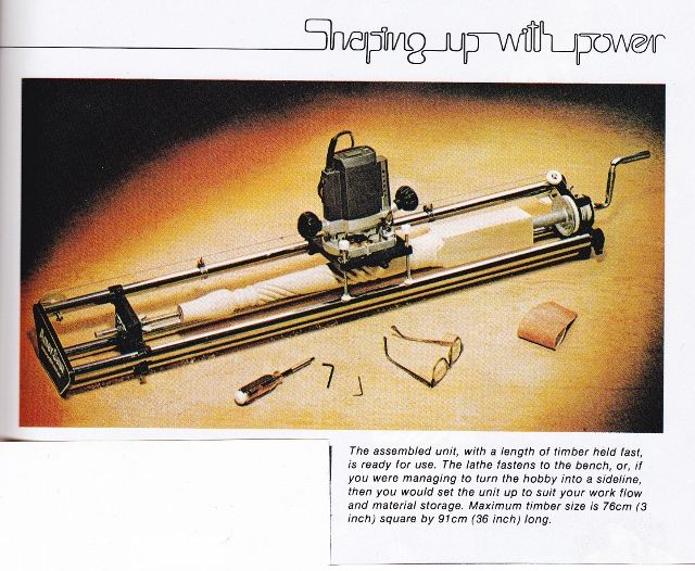

                            The lathe I'm thinking of is made of four steel bars about 1.5M long and 30 mm dia. these are mounted parallel in a box form, and the top two form a guide for a router. The wooden cylinder that is being worked onis mounted between centers in the middle of the bed below the router. The center at the right hand end is turned by a hand crank, this has a pully on it with a string that is attached to the router, and as the crank is turned, the router is dragged along the bed. Its a whole lot cheaper, and simpler than the one on E-Bay. Ian S C
                            #110711
                            RJW
                              @rjw
                              Ian, it's called a 'Routerlathe', made by Trend, they get snapped up very quickly on eBay and fetch relative fortunes compared to what they originally cost!
                              I've been looking for one for quite some time, but none ever become available within sane driving distance to me, and no one will post them due to their length (postal restrictions).

                                    Problem with the trend lathe is the distance travelled is always the same.
                                    We used to have barley twist lathes at the piano factory but these were modified simple wood lathes and had a series of cable wheels made from plywood of different diameters.
                                    Most of the barley twist we did were the open type for spindles in high class kitchen furniture which was a side line we did as well as piano actions.
                                    The lathes were to Taiwanese round bed wood lathes as brought into the UK by Poole Wood Equipment, since wound up.

                                      A better version of the Router Lathe is the American Legacy ornamental mill, does far more intricate and complicated work.

                                                  This will give you a rough idea of the little machine, spiral may be left or right, or staight flutes.
