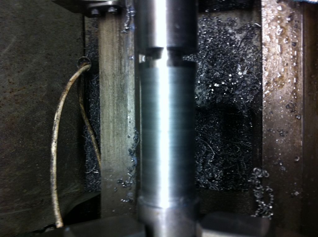

      Hi chaps I'm having a finish issue with the Bantam Lathe it doesn't seam to mater what different tools I use the problem is still the same, what I end up with are lines in the finish but they are not the same on any piece of steel what I'm trying to say is there is no pattern to the lines I've checked everything I can think of and all seams well. no lose gib's or motor but there is something lose that maybe I can't find, could there be something wrong in the apron a missing tooth on a gear perhaps but if it was that the line that's left on the steel would be in the same place I thought, I've been using mild steel and have tried all different speeds and feeds but it still does it, you could have the first 1/4 inch ok then all of a sudden you see a line appear then it be ok again a bit further on it will do it again, if these lines we the same distance apart it would tell me something but they are not there random, the lathe has always been like this since I bought it but now I seam to be getting a bit better at this hobby I would like to get to the bottom of this problem, hope someone can help.
      Regards Alan.

          Random pattern would suggest the tool is cutting then being pushed away before cutting again. What type of tool are you using and does it do it on all tools or just the one.
          Pic would help

                  This is the best picture I have at the moment will try to get a better on tomorrow when I get home from work.
                  Al.

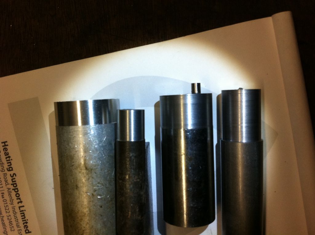

                            Looks like "good commercial quality" mild steel from the photo. Pretty awful stuff but cheap. What finish do you get on Aluminium?
                            I have a single phase Bantam and get no vibration problems but cheap MS can only be machined with HSS tools with a 1-2mm radiussed point and 15-20° rake with oil, WD40 or suds and slower cutting speed if you want a finish. Or polish with emery if you are in a rush……

                                      Hi chaps tonight I ground up the tool again (should have taken a pic) this time put a bit more relief on all angles as Trevor suggested and nipped up the cross slide and top slide a bit more, now they would be to stiff to use but left them as just to see what happened, starting from the left ally and then a bit of a drill arbour from my core drill set it was bent so thought I would give it a go, next EN24 followed my mild steel, used WD40 with the ally and cutting oil with the others, all cut at 340rpm 1thou per rev feed, will try doing something with the motor next and see what happens, tonight's adjustments have made things better but not sure if was the extra relief on the cutting tool or nipping things up a bit, what does every one think, sorry for the photo quality IPhone I'm afraid.

                                          The surface finish is exactly what I would expect, your drill arbour is pretty good quality metal. EN24 and the mild steel always look like that when machined on mine, or any lathe I have worked in the last 40years old and new, so I doubt there are problems with your machine – more likely to be the old iron bedstead thrown in the melt to make the mild steel. You will get a similar finish with Silver Steel.
