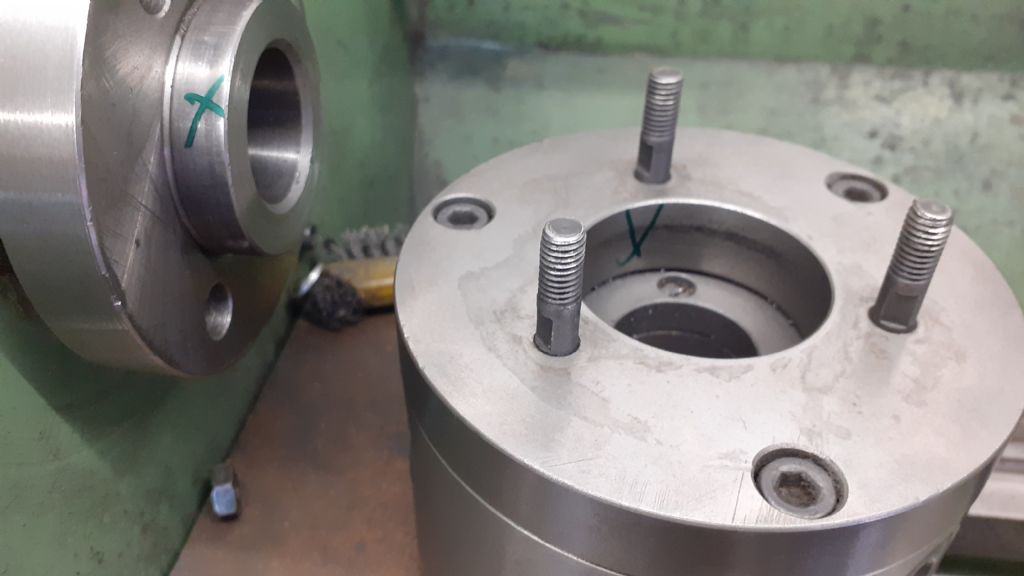

                                          For those that don't know what they are talking about this is the spindle of my Warco WM280, the WM250 is the same
                                          The spigot on the spindle marked with a green cross is 52mm nominal diameter. The hole in the chuck backplate also marked with a green cross is 52mm nominal diameter. On the other side of the backplate is a 95mm spigot that the chuck registers to.(125mm chuck)
                                          The three hole sin the larger flange on the spindle are approx 9mm dia and easy clearance for the three M8studs sticking out the backplate and positioned on a 75mm PCD.
                                          To change chucks the nuts behind the flange are undone, the backplate complete with chuck slid off and then another chuck slid on and the nuts replaced,
                                          Worth pointing out that as supplied the backplate on my Warco 3-jaws chuck is a tighter fit than that on the 4-jaw and faceplate. This is because the fit of the 52mm diameters is what registers the chuck/backplate combination to the spindle each time it is changed. The fit is so close that the nuts need to be used to jack the chuck off and nipped up in turn to pull it back on. Originally this had to be done for the full length of the spigot but if you look closely at the hole in the backplate I have added a 1degree taper to 2/3rds it's length so only nee djack about 3mm before it is loose enough to pull off by hand.
                                          A quick measure with the digital callipers shows my spigot spot on 52.00, the hole in the 3-jaw backplate also 52.00mm and the hole in the 4-jaw backplate 52.01mm allowing for the fact digital callipers are not exact on internal bores I would say there is maybe 0.01mm clearance but I machine the other backplates I have to fit by feel not measurement.

                                              Your backplate needs to be a snug fit bon the 52 mm register, and the collet chuck needs to be a snug fit (virtually size and size) on the register von the backplate.
                                              Those registers detrmine the concentricity, and therefor the accuracy, of the work held in the collet chuck.
                                              Howard

                                                Hi Jason & Mike thank you for your latest posts. Especially Jason's photo.
                                                I have enough ammunition now.
                                                I want the exact dimension of the register so I can make a plug gauge to bore the hole in the new backplate.
                                                I cannot keep stripping down the chuck to test it on the nose!
                                                I find it extreemly funny (and anoying) that this basic dimension is not in the manual.
