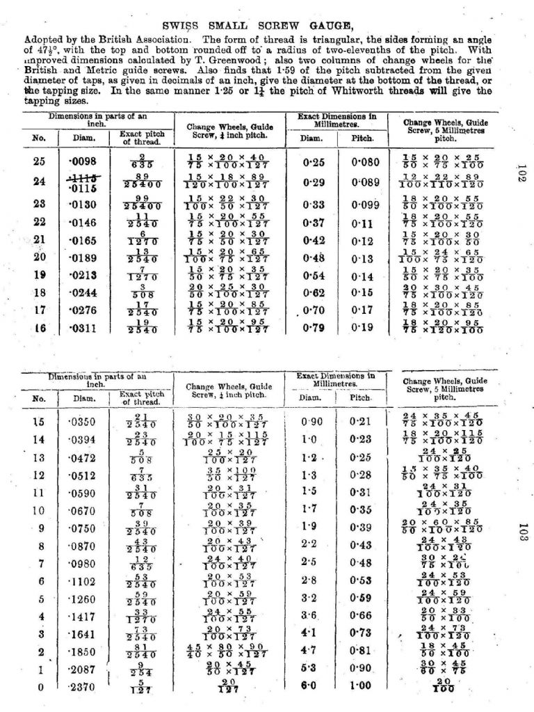

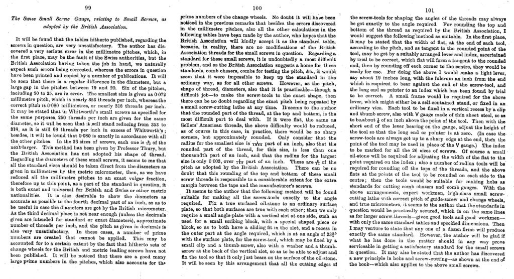

                                                Nicholas Farr
                                                  @nicholasfarr14254
                                                  Hi, while the two scans below don't answer Anthony Knights question, they maybe of interest. They are extracts from a pocket book by T. Greenwood, titled "The New Turners & Fitters Handbook" which was given to my father from an uncle of his, on 2nd Sept 1926. The second scan shows an error to which I have inserted a correction with a bit of software.
                                                  Regards Nick.
