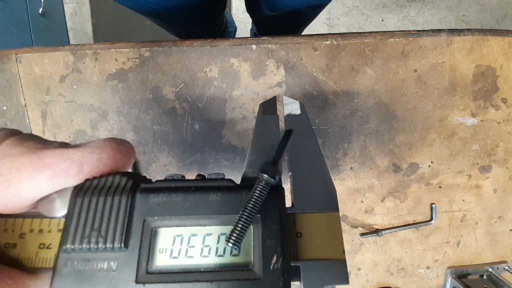

        Does anyone know where I can get BA Allen Keys, preferably in a set ? I've tried the usual suppliers, but no luck sad

          BA was never metric to my knowledge. You need an imperial inches set.
          #571696
          Clive Brown 1
            @clivebrown1
            AFAIK they don't exist. All the socket head BA fasteners I've ever used have fractional imperial sockets.
            #571697
              Should not be a problem getting 2, 2.4 and 4mm for the common even numbered BA cap heads which are 6, 4 and 2BA, Someone Like Model Fixings have key, tee wrenches and ball ended drivers in those sizes
              That is what I use and they all fit, if not go looking for 5/64, 3/32 and 5/32" again not too hard to find as are 0.9mm (0.035inch) and 1.27mm (0.050inch) which fit BA grub screws. Same supplier does them too.

                    Thanks for all the replies. The reason I asked was because I have a set of 4 BA capscrews which neither my metric nor my imperial allen keys fit, but I have an allen key supplied as 4 BA by a model engineering firm which fits them perfectly.
                    #571724
                      Sounds like you have some odd 4BA screws if imperial keys won't fit. This is a 4BA with a nominal 3/32" key which fits fine. Details of key sizes can be found here and as I said the metric ones fit too.

                                By way of addition to Jason's link, 8BA set screws take a 0.035" key. For the 1/16" sizes and above I identify them by 1/64"s, so that, eg, a 5/32" is a number 10 in my system.
                                The small L-shaped keys can be quite flexible and when more torque is required I use the 1/4" AF shank bits in a holder; these seem to be available down to 0.050".
