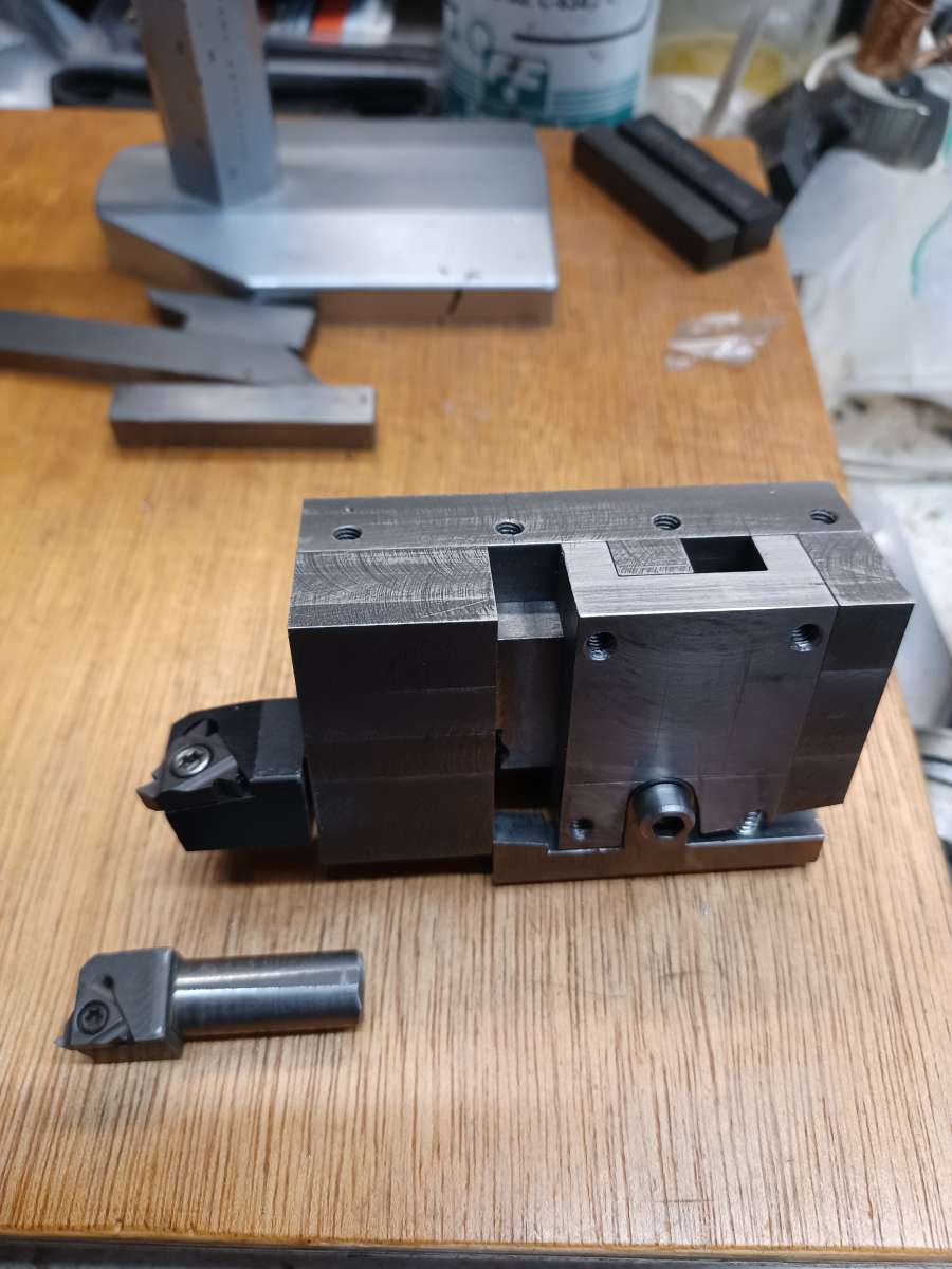

      auto retract threader copying Mrs Woopees
      I’ve wanted to make this tool for a long time. I recently saw a video by Mr. Wooppe and decided to build my own

        Looks interesting retract could do with a damper though. Worth looking into.

            Why is the in feed needed on the tool instead of using the cross feed or have I not understood.
            #749753
            bernard towers
              @bernardtowers37738
              crossfeed puts the new cut on, when tool is pushed forward it takes the tool to the same place every time.

                  Or perhaps just limit the travel of the tool to retract only say 5mm instead of 20 or so. (Unless cutting up to a larger shoulder!) Not such a clunk at the end that way.
                  One big advantage of this unit would be you can screwcut at 500 or even 1000 RPM and not have to worry about being quick enough to manually retract the tool at the end of the cut. Saves a lot of time on longer threads and tooling cuts steel much better at those kinds of speeds.  (Provided your lathe is solid enough to handle it.)

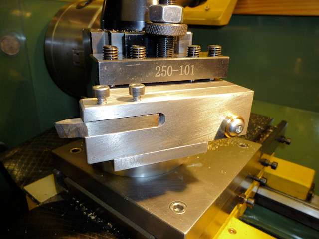

                    A slightly less sophisticated solution may be to use a flip-up toolholder.
                    onlathe
                    See *** Flip-up Toolholder *** for more info.

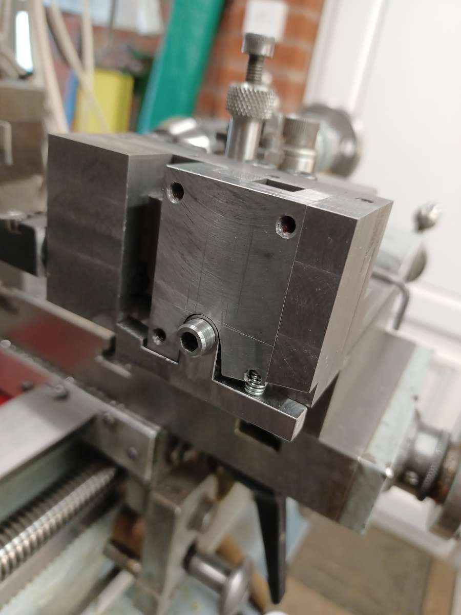

                      A while ago I made a modified George Thomas extracting screw cutting holder which when it reached a stop automatically released the tool and spring loaded extracted.
                      20220608_08523220220608_084914
                      there is a video on youtube
                      David
