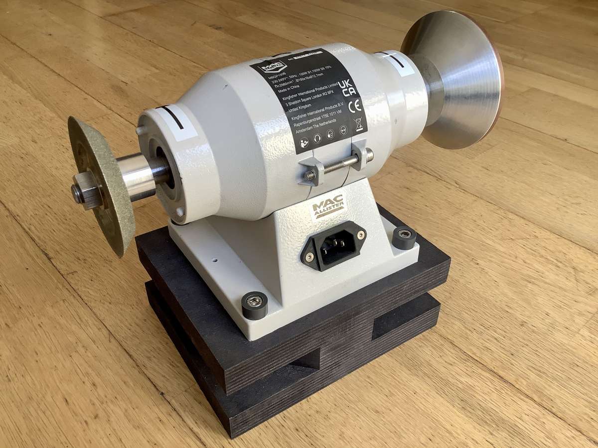

      Anyone else on here get a bit fed up with attached cables? I find it often makes some items more difficult to move around than necessary and also takes up storage space. Over the years I collected quite a number of cables with moulded mains and IEC plugs. As a result I sometimes remove attached cables and fit an IEC socket. This was one of the first things I did for my new grinder.
      IMG_1768

              I like IEC sockets and often retrofit thaem to corded devices. If there is no room you can use an inline male on a short flylead.
              However there is one serious shortfall with the specific example pictured. It is a grinder and the IEC inlet is facing upwards.
              This means that dust and swarf can collect in the bottom of the inlet. This will eventually short out the pins and cause a big flash and bang.
              Any IEC inlet should be level or ideally in a workshop with the opening facing down.

                  Highly unlikely I believe, I think you’re being over pessimistic. If you look a bit more closely you might also notice the direction of rotation. I’ll also be using guards and extraction as I don’t want to be breathing in any particles.

                            Why defend an arrangement that’s clearly inferior Vic?
                            Robert points out that the position of the socket means it will collect dirt.   He’s not making the issue up!  The need to stop dirt collecting in electric systems was recognised in the 19th century.
                            Evidence and experience both support Robert’s warning.  Dare I suggest that it’s unwise for an individual in 2024 to believe this well-known problem is ‘highly unlikely’  and to think Robert’s warning is  ‘over pessimistic’.
                            Use of the word ‘believe’ should set alarm bells ringing.   Beliefs are often based on ignorance, whilst engineering is based on knowledge.
                            Socketing tools is a good idea, but before retrofitting a socket consider its position might matter and identify other needs such as ingress protection.   There might also be safety concerns: for example what happens if plugging in powers the motor up?   In Vic’s grinder, he could be leaning over the machine, perhaps holding it with one hand, whilst fumbling with round the back with the other.   Does the convenience justify the risk?  Discuss…

                              Dave,
                              Simply because it’s not inferior to me, it’s much better. I suggest you look at the picture again and perhaps examine an IEC plug and socket a bit more closely. I’ve now got a number of items with these sockets now and none of them have collected dust, why would they?  If you want to try it yourself come back in a few years time and prove me wrong, if you can.
                              I’ve got several pieces of equipment that can be turned on before being plugged in but I’ve never even thought to do that, so I’m wondering why you mention it? Have you had an accident doing that?
                              Another advantage is cable length. I started this post because I’ve just recently fitted an inline IEC socket to a fan I bought. It came with a 1 metre cable which meant I had to keep using an extension with it, very inconvenient. It currently has a 3 metre cable plugged into it. Unlike Jason that has all his electrical equipment plugged in and set up all the time, this is a seasonal piece of equipment and will being going back up into the loft at some point and is much easier to move and store without an attached cable.

                                  Vic,
                                  It seems that we will not change your opinion.
                                  However the inlet pictured is clearly installed with the opening angled up. IEC inlets do not have shrouded pins. One piece of swarf in there can cause a short circuit. The very fact you have installed an inlet tells us it is likely to be stored without a lead installed and that is when contamination can enter.
                                  You may do whatever you like in your private workshop. But when I see someone making a suggestion to others that has a clear safety implication I have a professional obligation to comment on it so others who may see it can make an informed decision about adopting it.
                                  I’m not perfect, I do things in my private workshop that would not be considered acceptable in a workplace for instance. But I do not publicise them or suggest others copy me.
                                  You have a machine shop, make up a wedge shaped block to make the inlet level or tilted down slightly.  This will also stop the cable being pushed up towards the unguarded wheels.

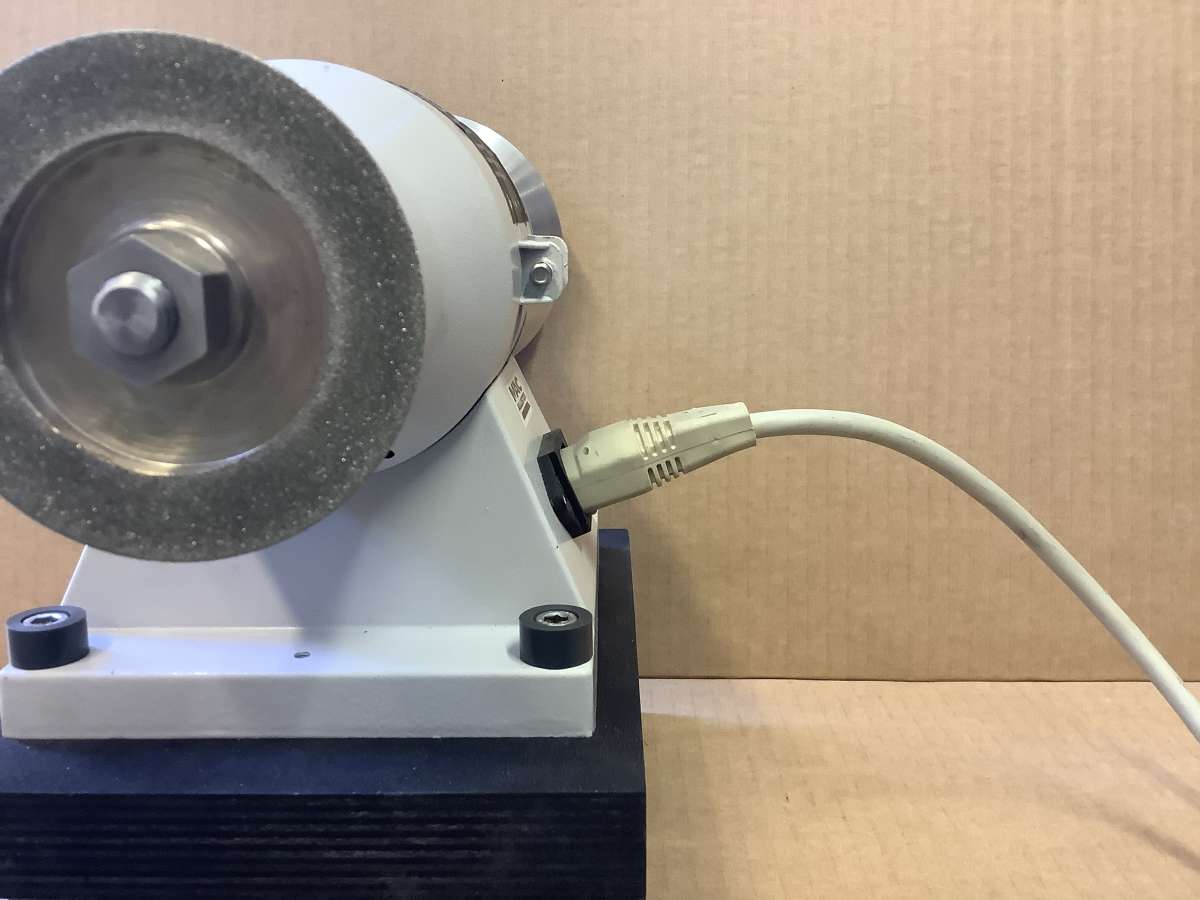

                                        IMG_1778

                                          A reasonable suggestion Maurice, and I have done this as well in the past. Sadly, probably still not good enough for Robert I expect.
                                          This is the smallest of my grinding solutions and will only be used for precision grinding. I don’t expect it will produce a lot of metal dust at any one time before it’s put away again. What is likely to be produced will be on the opposite side of the machine to the socket and hopefully extracted by my shop vac.

                                              Hi,
                                              I’m a Chartered Engineer (and Fellow of the Royal Aeronautical Society),
                                              “Engineering professionals have a duty to obey all applicable laws and regulations and give due weight to facts, published standards and guidance and the wider public interest. They should: hold paramount the health and safety of others and draw attention to hazards. ensure their work is lawful and justified.” (my bold).
                                              https://www.engc.org.uk/ethics
                                              I’m not policing anything just allowing others to make an informed decision.

                                                Yor expections are wrong Vic. In my first reponse I said:
                                                “I like IEC sockets and often retrofit them to corded devices. If there is no room you can use an inline male on a short flylead.”
                                                That would be my preferred solution for this application.
