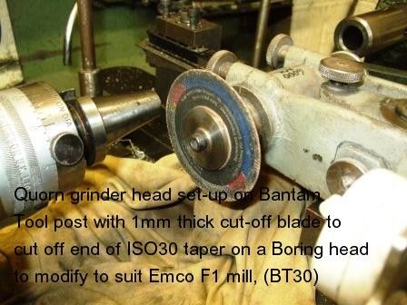

                                            Emgee
                                              @emgee
                                              Pictured with my Quorn set up on the toolpost, cut the end off the arbor fitted to an Eriksson tenthset boring head and then changed the cut-off disc for an internal stone to grind a 3mm long internal bore. Converting an ISO30 arbor to BT30 to fit my Emco F1 mill.
                                              #435789
                                              ega
                                                @ega
                                                Emgee:
                                                That looks like the Mk 1 wheelhead and I notice the knurled clamp screws; is this so you can quickly swap out the spindle?
