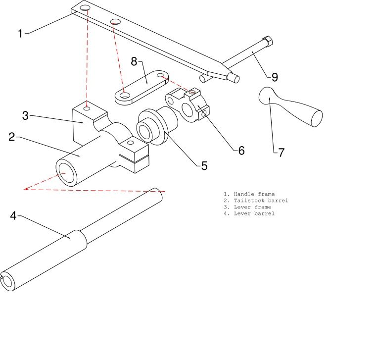

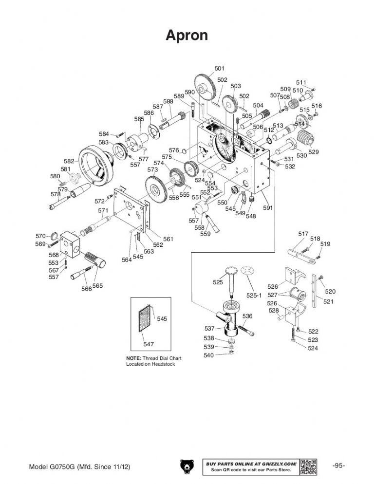

      I'd like to make a picture of something I've made along the lines of the assembly diagrams we see in machine tool manuals. For example, a lathe apron:
      My thing is much simpler but my question is: how are these diagrams produced? The above looks like pure draughtmanship to me. But maybe there are computationally assisted ways for the artistically challenged.
