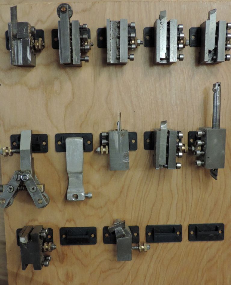

              #327719
                A 3D printer could solve your QCTP problem…
                #327721
                Chris Trice
                  @christrice43267
                  …. or put up a shelf.
                  #327722
                  MW
                    @mw27036
                    Posted by Neil Wyatt on 17/11/2017 21:29:07:
                    And so does a bit of junior carpentry cheeky
                    Michael W
                    #327735
                    Nick Wheeler
                      @nickwheeler
                      I have about 20minutes and less than a fiver in this:
                      It's several short pieces of 25x1mm steel strap bent and welded to a longer piece. No measurements were made when making this as each piece was marked out and bent to match the first one which looked about right. They were spaced apart by using the same piece. The rack is bolted to a cupboard door next to the lathe. I must make another, as I now have more holders.

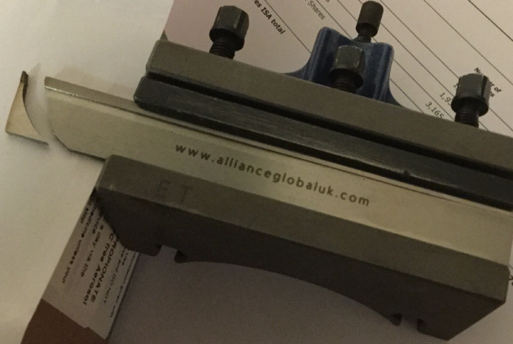

                          #327835
                          Steve Pavey
                            @stevepavey65865
                            Given the price I paid for two of these, plus the fact that they were bought on the recommendation of one Stefan Gotteswinter, this wretched thing shouldn’t really be white elephant. As with any edge tool they (I bought two of them) work fine on brass and aluminium of course, but show them a bit of 316, EN3 or EN24t (which is what I was using this evening) and they have a mind of their own – sometimes producing a reasonable curl of shiny scarf and at other times chewing the metal off as if it had never been sharpened in its life. And occasionally there’s an almighty bang and this happens.
