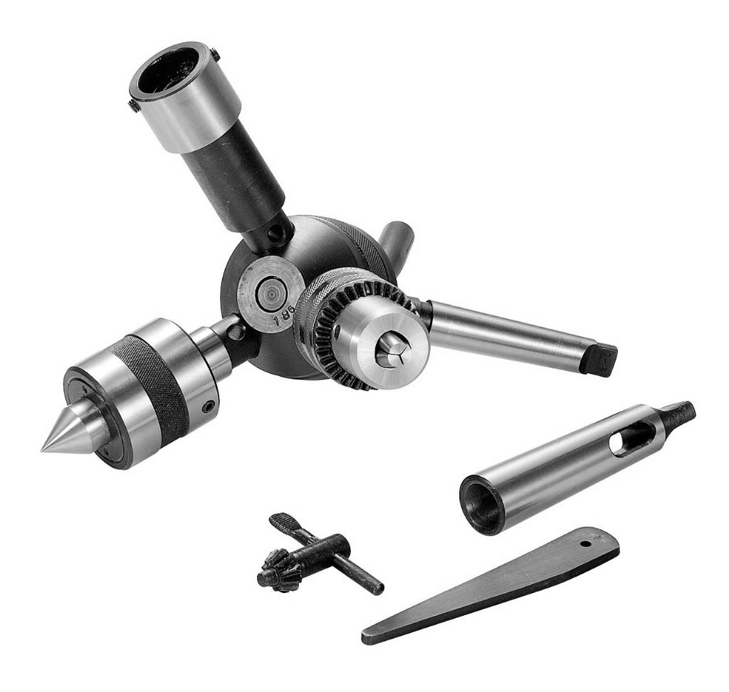

          I just commented on the other thread. I built one of those tailstock turrets and I've never used it. This thread could also include simple accessories that punch above their weight i.e. that turned out really useful and get used a lot.

              1. Tailstock Turret (might be handy to some but doesn't get much/any use in practice).

                    And to your point Chris, I did look at the tailstock turret as soon as I saw it mentioned here and managed to hold off buying one immediately, because I would have to buy more tools to fit, don't have enough space on my lathe and don't see it as a value-add

                      Andrew Tinsley
                        @andrewtinsley63637
                        Yes I must own up to a tailstock turret that doesn't get used! mind you, I am sure a job will turn up that will make use of it …………………… Dream on! Yes and the cutoff slide ………… it was a real bargain, but ………….

                                Tailstock turret, poor locking feature and atrocious alignment, managed to salvage the die holder.22-1068_1_1.jpg
